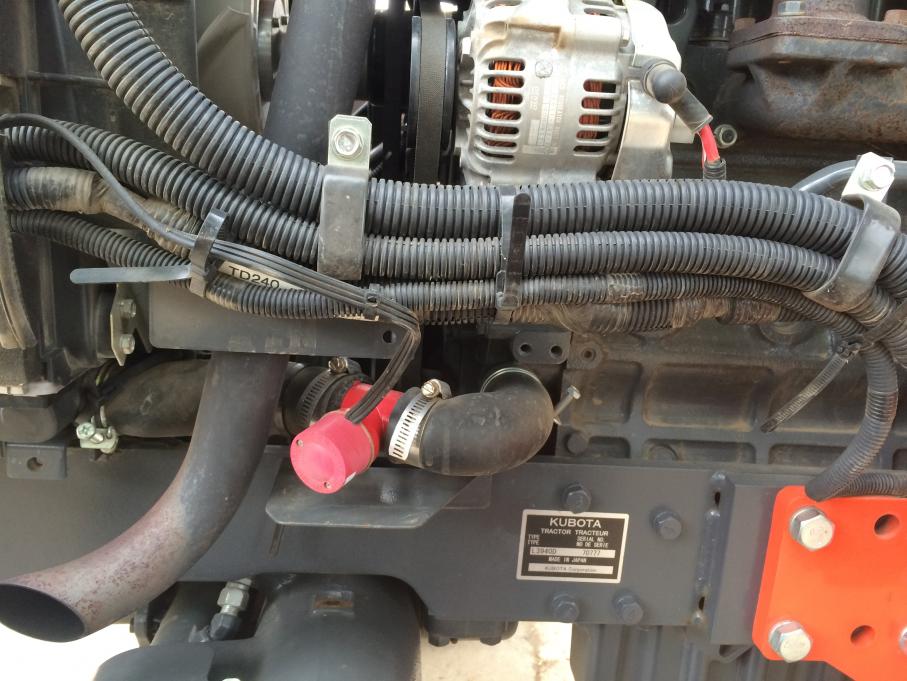

I ended up putting a heater in the lower radiator hose because it was easier. In addition, I had read lots of posts about block heaters going bad that were installed in the engine block because users installed them in the wrong location.
This was a really easy install.
I just put plier clamps on both side of the hose to block the fluid from leaking, cut out a little section of hose big enough to fit the heater and then removed my plier clamps. This was on a L3940. Took me a total of about 10 minutes to do the install.
I have been using it for the last 3 years with NO Problems.
