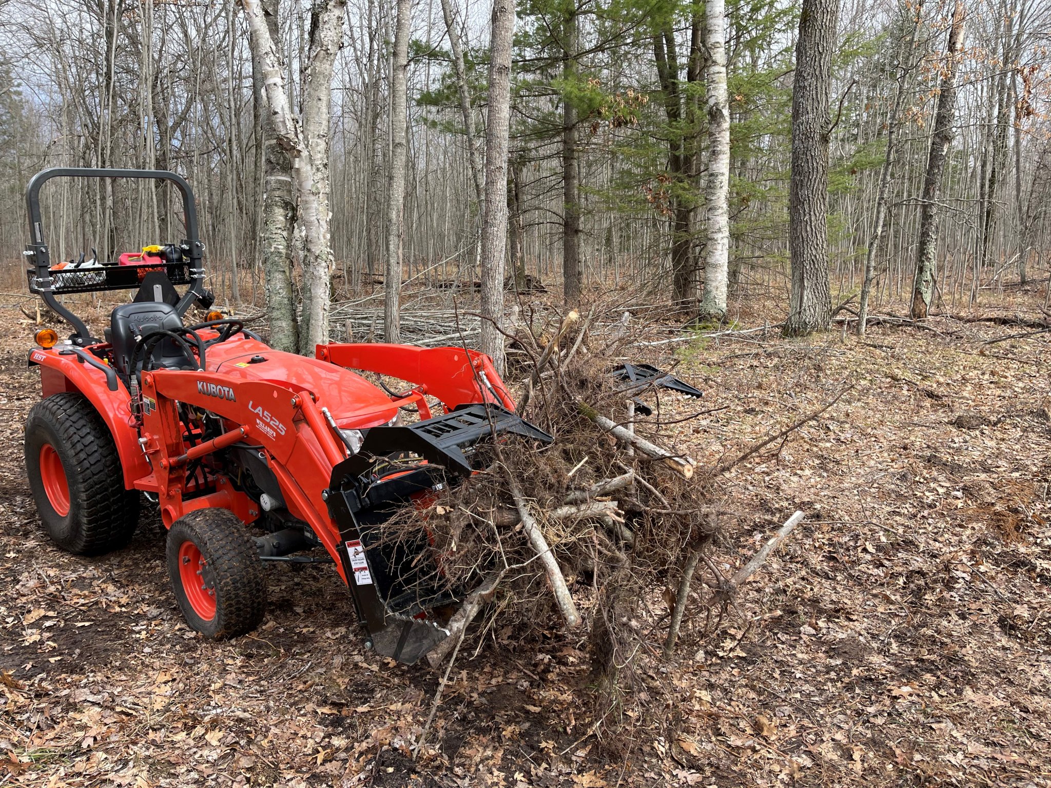

Also running a MTL compact twin lid grapple, it was $999 including delivery, during covid, for the price the quality is amazing, this is a great fit for my L3901.

$999. Great price. It's $1290. Now, still a great price. That was my other choice.
You can't add a grapple to your bucket for any less.
Summit 3rd function and grapple less than $2000. They both support their products really well if something is legitimately wrong.
