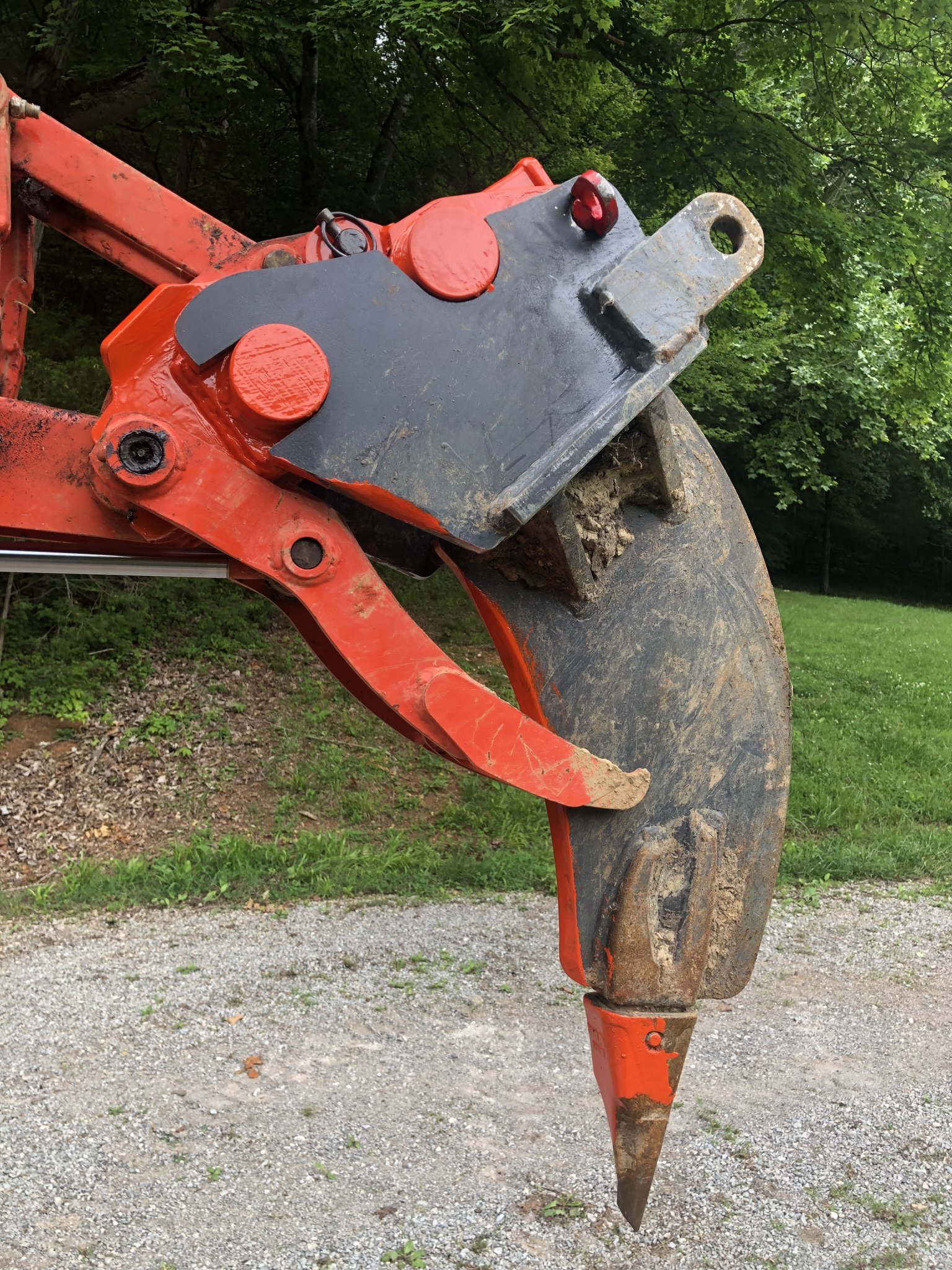

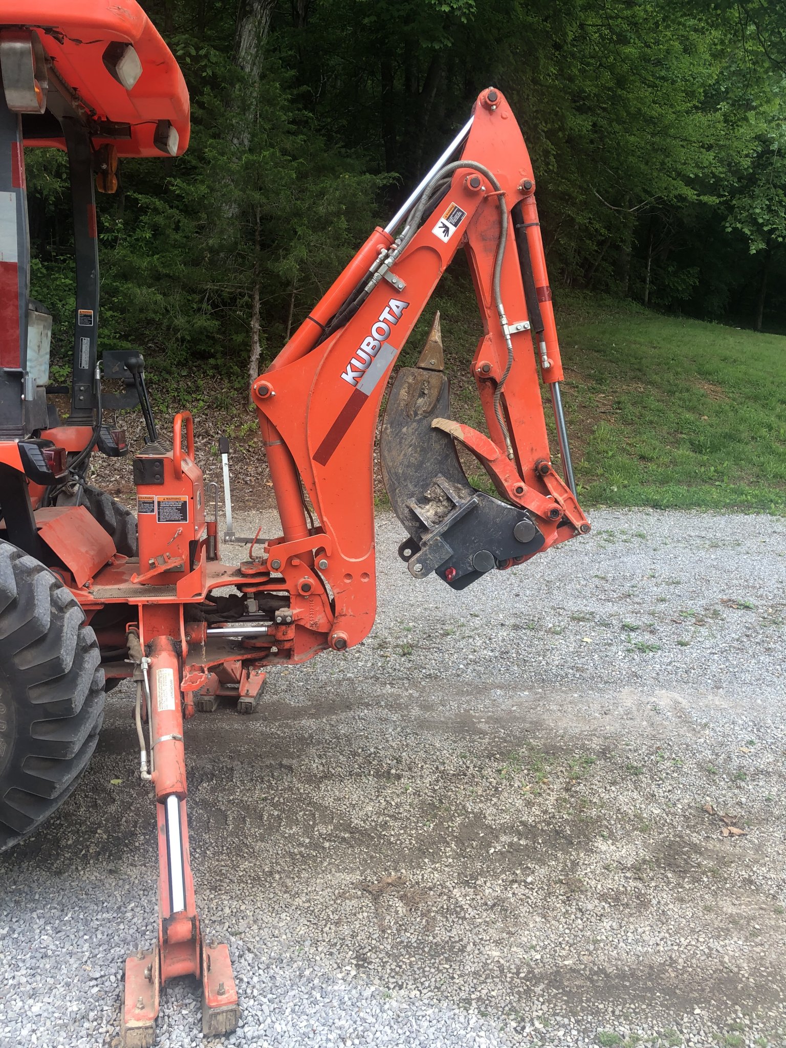

One of the more useful backhoe attachment beside the thumb is a ripper tooth. So impressed with M59 ripper wanted one for the B26. Couldn’t find one so instead of making one, made an adapter to use the KX quick attach ripper on the B26. The little B26 can handle the excavator ripper just fine.

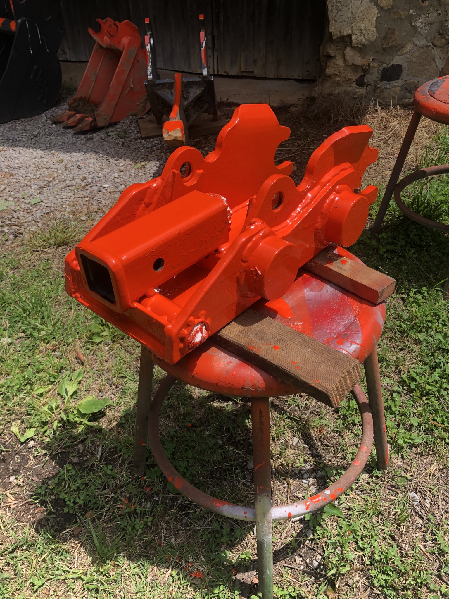

Another option is use your pin-on ears from your old bucket to make KX excavator attachment. Little more skill to make but gives versatility options.

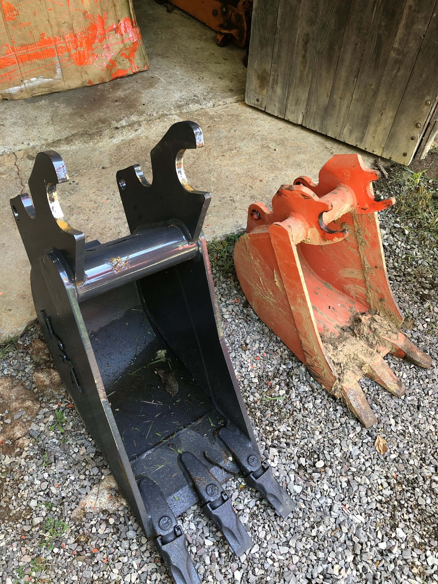

Can see the difference between the 12” orange B26 QA bucket and 12” black excavator bucket. The difference would closer on BH92.
Note the excavator bucket has optional ESCO teeth from USA Attachments. Much better digging on my mixed soils than the Kubota teeth. Little smaller but sharper. Was a free upgrade at the time of purchase.

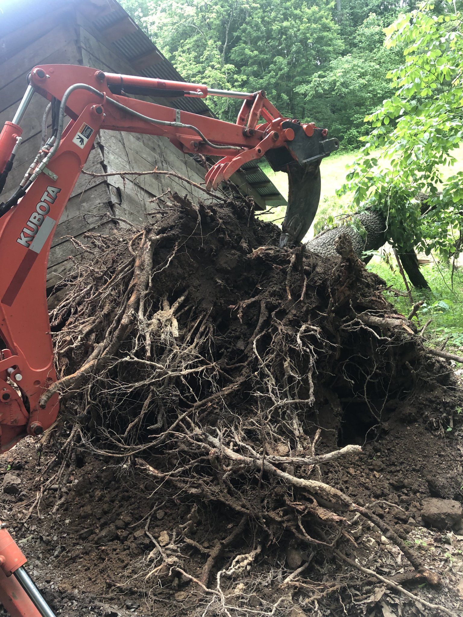

I have the KX series quick connect ripper from OX Thumbs (Carrolton, GA).
I wanted maximum ripper length/depth, and theirs will rip to 28",...... the deepest ripper I could find.
A great tool!

The black bucket pictured fits the Kubota mini-ex style quick connect coupler.
You need to know if you have a ( K7770 ) coupler on your machine to use that black bucket.

Got both the M59 excavator coupler and black Kubota excavator buckets from USA Attachments in North Carolina.
