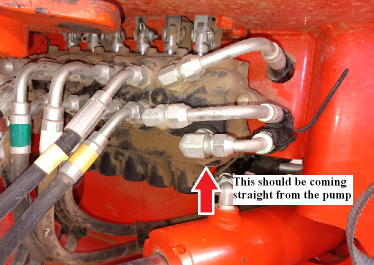

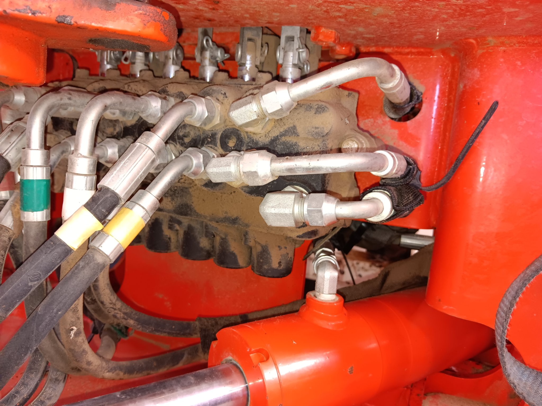

This bottom port on the right is what I have going to pressure from the pump

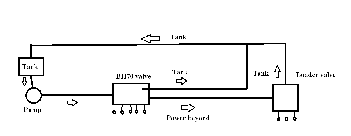

The backhoe valve should be first in the chain and connected directly to the pump - no tees.

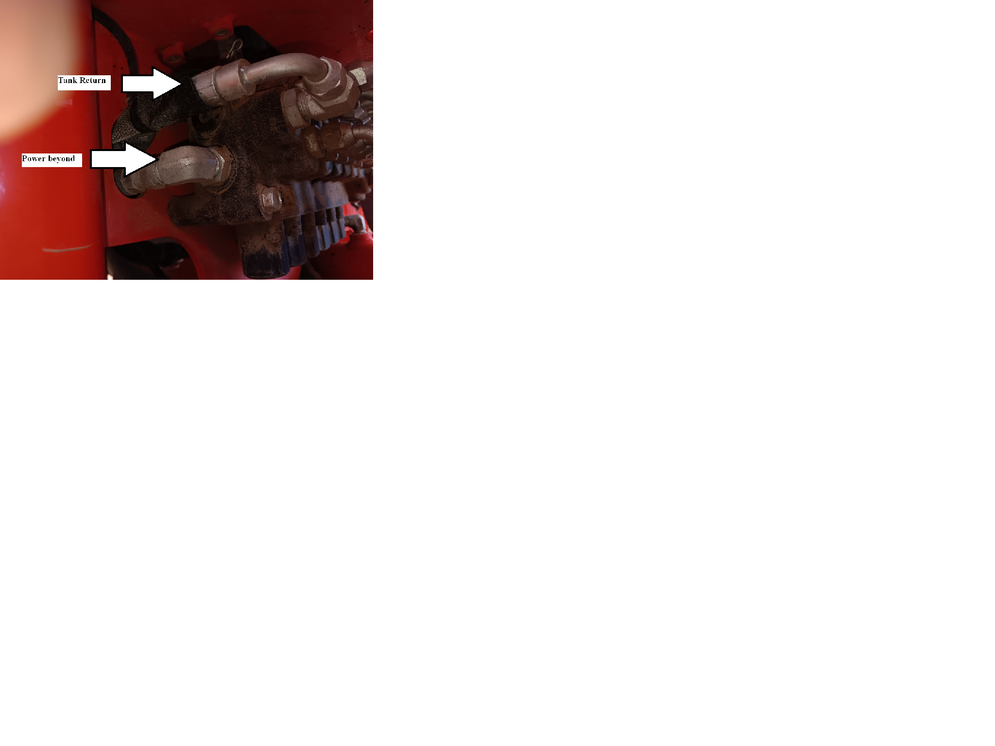

Here is the loader valve. No tees and I suggest you stop using iron pipe fittingds and get the appropriate steel hydraulic fittings. All that remains is to ID the tank rteturn and power beyond ports on the BH70 valve,
13,023
7,361
Here are the BH 70 ports. - Just FYI standard nomenclature calls that the right side of the valve. For a moment there I thought you had everything hooked up backwards. I think the loader valve may be.

Your valve is open center as are almost all gear pump based systems.
You're valve may have a port suitable for power beyond operation but it's not as simple as removing a plug and connecting a hose. You would need a power beyond adapter that screws into the port. Without the adapter it's just another tank port. To obtain a PB sleeve You would need to know the make and model of the valve - the conversion sleeves are specific to the OEM that makes the valve.
