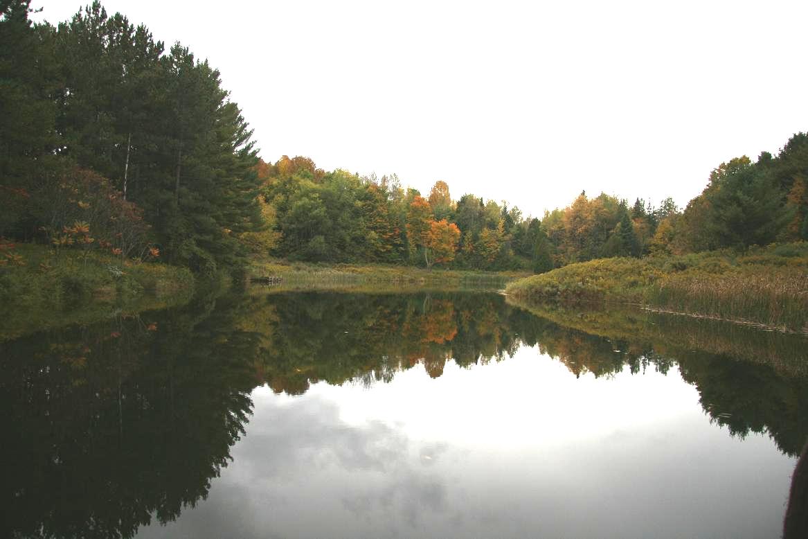

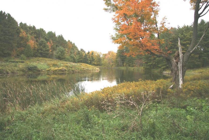

found a couple of photos from a past summer. Hopefully you can all get a better idea of the slopes
Please forgive me for stating the obvious: the slope is too wide for a side-mounted rig to mow; the terrain is too rough for a side-mounted rig to properly mow -- but you would accept, I'm sure, skinned places and straggly patches, if you could safely mow it from the bank... I think you've given up on that idea.
Regarding the idea of backing down with a brush-/bush-hog and back up: that would be a very difficult job. If all your slopes are the same as in the pics, you could do some of it, but some parts are so steep that you'd go in. (Or perhaps over, if you misjudged some of those "humps"!) A 5-acre lake? Twisting around in the seat to judge distance and location, while maintaining full control, and never making a mistake?
I can see only three options for this challenge: a) live with it, it's Nature; b) get some animals to periodically graze it; and c) plant it in low-profile ground cover.
No worries, It's why I asked the question. I agree it's a wide area. I'm not looking for a clear cut, just to keep some of the wild under some control. I know mother nature can't be controlled. I could wipe it all out with pesticide, but it's a balance that is needed, without wiping everything out. I do cut trails across the top. I guess I'm after some water access (yes, I could weed whack some spots) but don't have the time. We spend the week being city slickers and the weekends being citiots

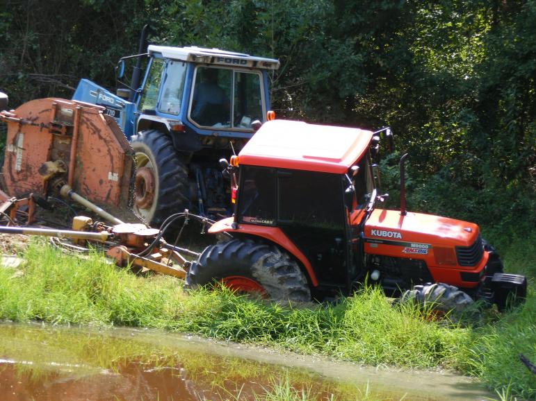

Plumcrazy, first let me say that's a beautiful place. The 2 winter pics really show how steep the banks are and I wouldn't mow those banks with my boom mower (not down to the water anyway). From what it appears though as long as the ground is solid I don't see a problem cutting it with a larger tractor like a M series. The flat side like what's in the 3rd pic doesn't look bad at all though.
Your idea of using a sickle mower may be the best option. When I was a kid we cut around our ponds with one all the time. Now when I have my disc mower hooked up during hay season I'll use it.
Do you have a neighbor with a batwing?

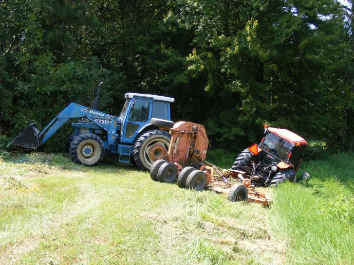

I use mine around my ponds all the time and will hang the wing over the water. But let me warn you, the ground better be solid or you'll end up like this.

Yeah, I found a muddy spot. Bad thing is it hadn't been but a few weeks since I had been in that exact same spot almost track for track with my disc mower. Everything was fine then but the day in pic I pulled up and stopped, when I started to back up the rear tire set down. I hit 4wd and tried to pull forward, I mean it had only set down about 6 inches or so. As I pulled up it never spun but it went deeper. I tried to back up again and it went even deeper so I stopped. it was only down about a foot but by the time my buddy got there to rescue me over half the tire was under the mud. The high side step was almost out of my reach and when I did get the door open I had to brace myself on the lower side just where I could stay in the seat.
I had got to the point I wouldn't have cared if it was a girl driving a pink John Deere, I needed some help. Since that day the end of the pond has been so wet I can't even walk my trackhoe out there. And in the past I have walked up to the end and jumped across the little ditch that fed it. Now, no way even in muck boots.
