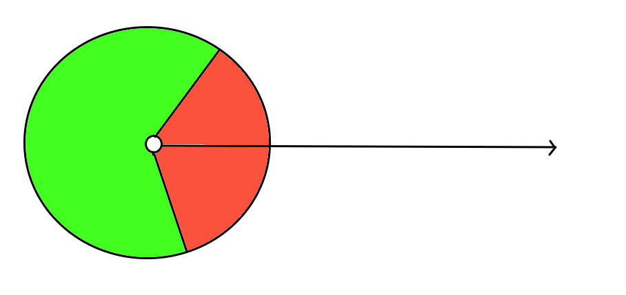

A single rope doesn't determine where a tree will fall, only where it won't fall.
tree-rope-pull.jpg Bruce
