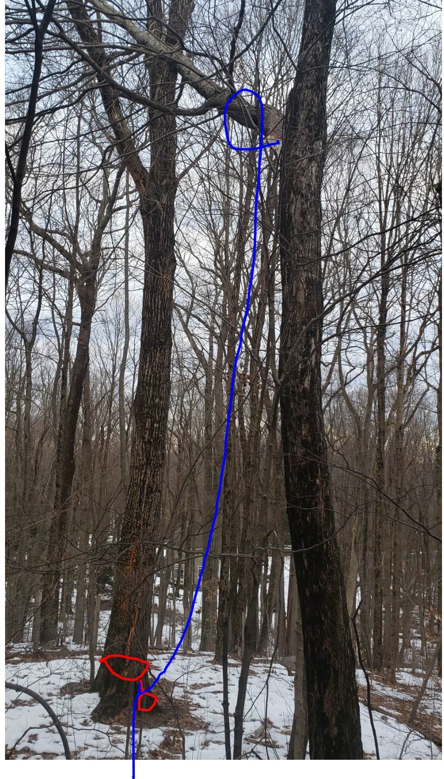

Beware those dead widowmaker limbs!
Like this baby:
This is what started me on the tree grooming. This 12" limb snapped a couple of days ago and is almost completely broken off. Its laying right in the crotch of that oak. Because it's in the area fenced in for the dogs it has to go. I like my dogs.
You can see my plan here. The snatch block is attached to that really large (dead) oak with a towing strap wrapped around it. The tractor will be about 50' away. No matter what happens that branch can't fall towards anything 'fragile'. It can't pull on the tractor when it falls either.
That dead oak is typical of the several that died. I will probably just pull down some of the branches before they fall down. The other dead oaks in the other part of the property I will drop. I'm not an arborist but I can tell which way they are leaning and I'm good with them falling in those directions. A rope encouraging them can't hurt.

I appreciate all the info and advice :)
I should have made myself a little clearer. That 'widow maker' branch is the only thing I'm pulling down right now. Its literally hanging by a thread and is clear and present danger to my dogs.
The dead oak I am fastening the snatch block to has a lot of big branches that are slowing coming down on their own during high winds or ice storms. I will probably use the tractor to snap some of them - again with the snatch block to the pull is pretty much straight down and the tractor will be very far away.
As far as the other dead oaks that I plan to drop in other area, they are far from anything and can fall safely. The worst that could happen is they would end up partially on the front lawn.
I am going to use 200' of synthetic winch rope rated at over 20,000 lbs and all the chain I have on the tractor side, about 50'.

Because today is in the 60's and the snow is melting I went out there and used a 2oz sinker tied to 20lb line to get started. The branch is less than 20' above the ground so it was easy to get the sinker over it. Then I pulled a 1/4" line over the branch. Tomorrow I should get the snatch block and winch cable but until the ground dries out I'll have to wait.
