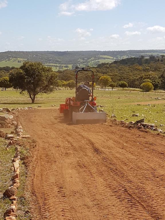

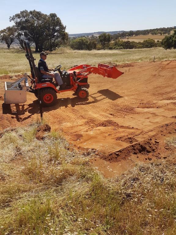

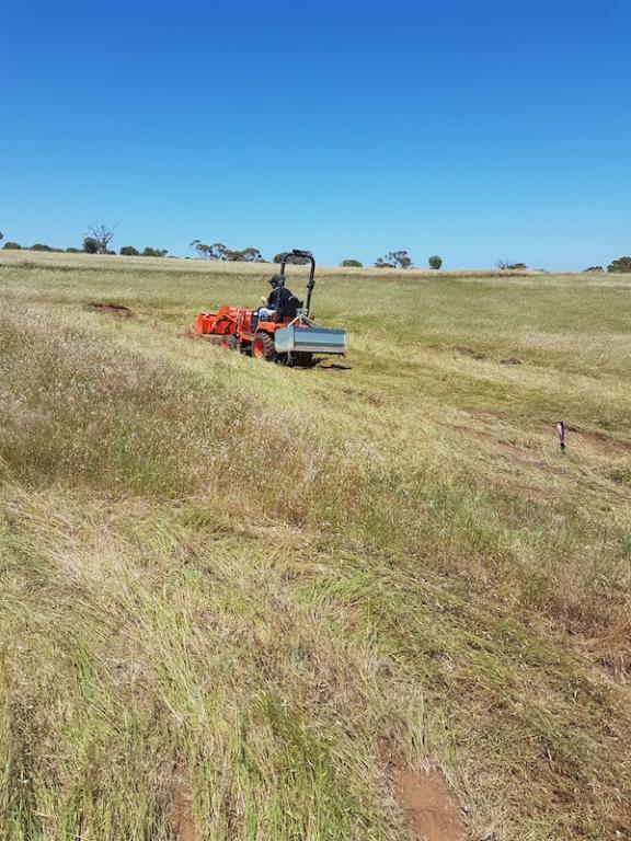

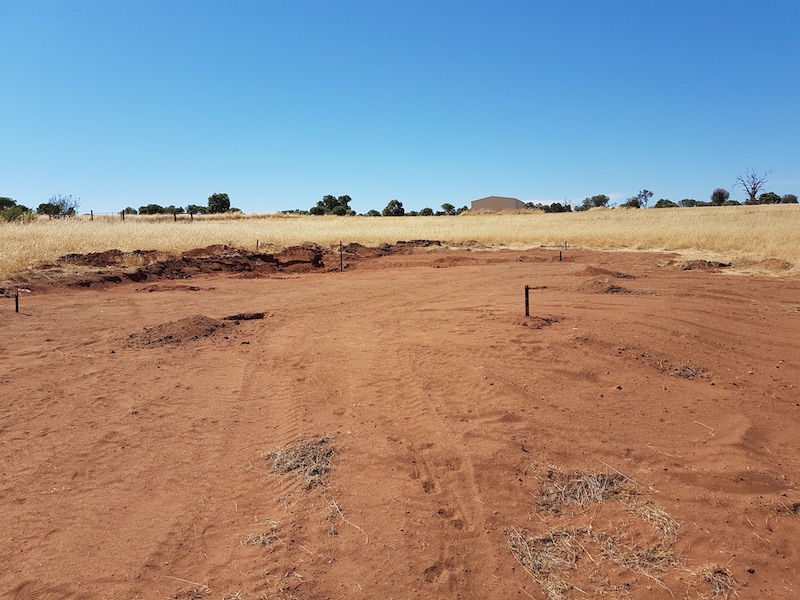

I've done all those things with just a box blade. One of the biggest jobs I did was construct a shed pad (12m x 7m shed) that required a 600mm cut in the back corner and 600mm build up in the front corner and retaining slope. All done with my box blade and BX2370.
