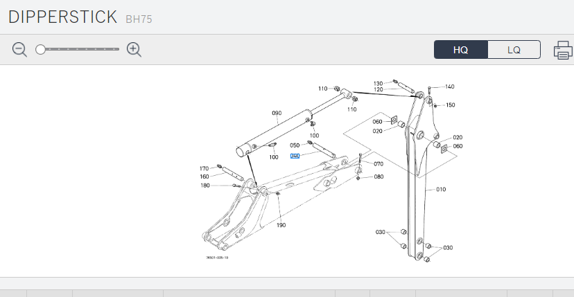

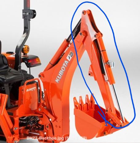

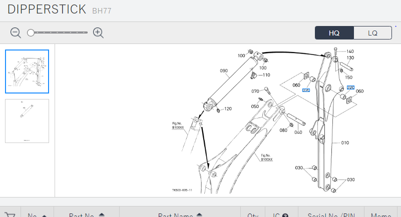

Can I replace bent dipper arm & piston on a bh75 with a bh77 dipper arm & piston? L3400 tractor

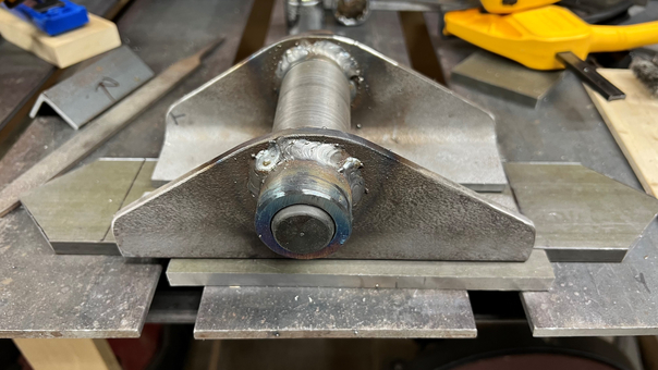

I can't say it would fit for sure...but they are pretty similiar. I've taken a number of measurements to add a thumb mount for my BH75. I'd say go to your closest Kubota dealer and take some measurements, and ask the service department.

The main pin, is the same size so it's very likely to be the same.
The cylinder attached differently and might or might not be the same length.
At minimum you would need to shim the pin end to get the width right.

The tractor is 16 yrs old which doesnot make any difference. Pulling 16 ft log off pile holding in grapple on 1 end kicked myself ! just looking to repace bh75 dipper arm & piston with bh77 arm & piston ! if it will fit has thumb hole

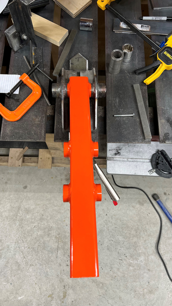

If the 77 doesn't fit, you could add a thumb mount to the replacement 75. As I mentioned earlier...I have a BH75 and in the process of fabricating a thumb mount for it. Should have it all welded on the dipper this weekend. Planning to clamp the "tacked" assembly in place tonight and check for proper operation.

Having A hard time finding bh75 dipper arm , none to be found in USA . Took lots of measurements of bh77 dipper arm ,elbow arm is 1 1/2 inches of difference everthing else is the same.I would use bh77 piston also. Is there any dealer out there that would know?
