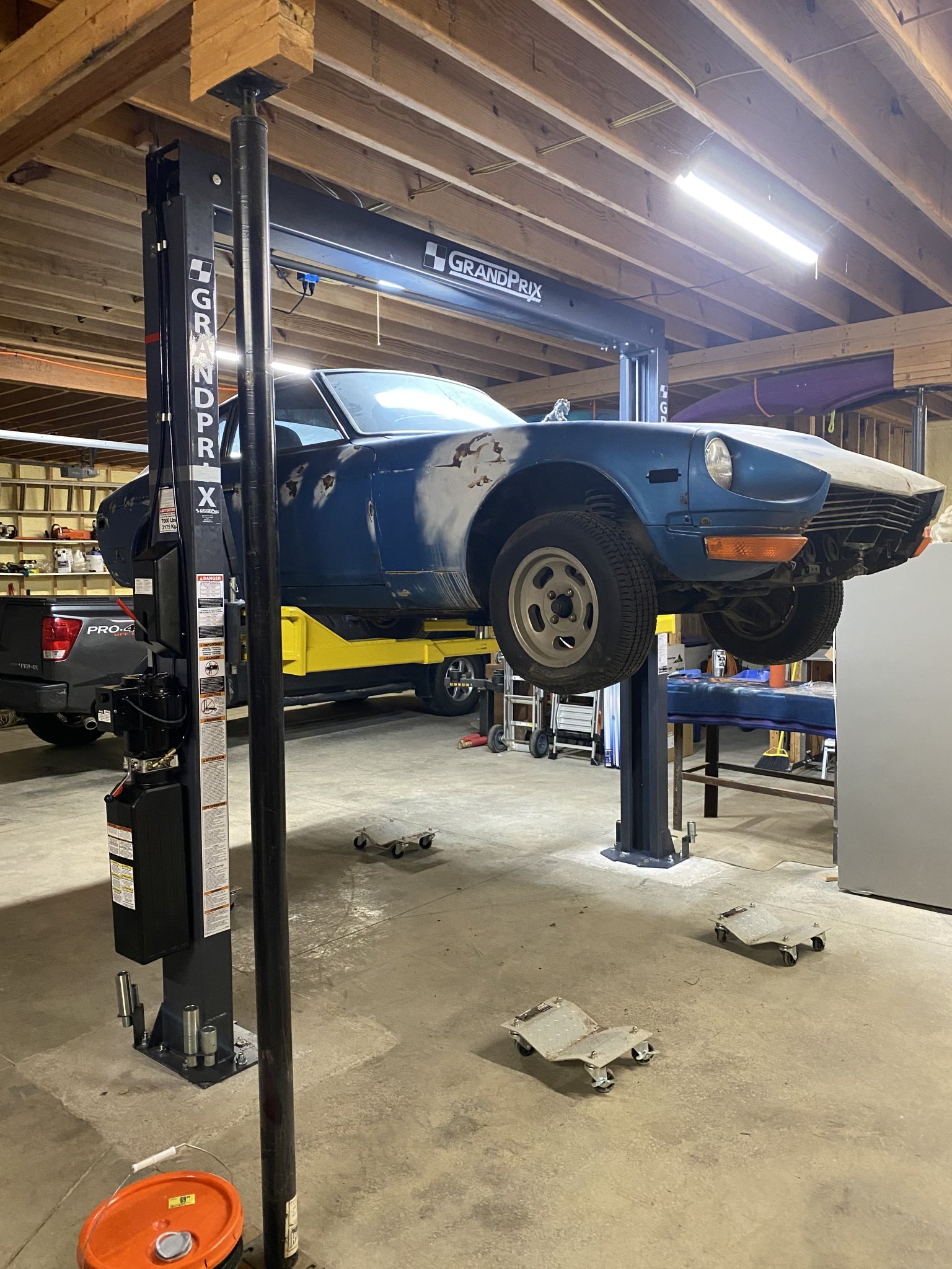

Nice hoist. Having one is a must for me. Working on the ground and getting my fat a$$ up and down is a disaster.
How many pounds is it rated for? I now see it's the xpr10
Mine is a 10K and called for a 4" minimum at X psi (I cant remember)
When i drilled the mounting holes and had an "average of 3 3/4" depth.
No problems or cracks in the concrete for 10 years, and I quite regularly put my 3/4 ton, extended cab, diesel up.

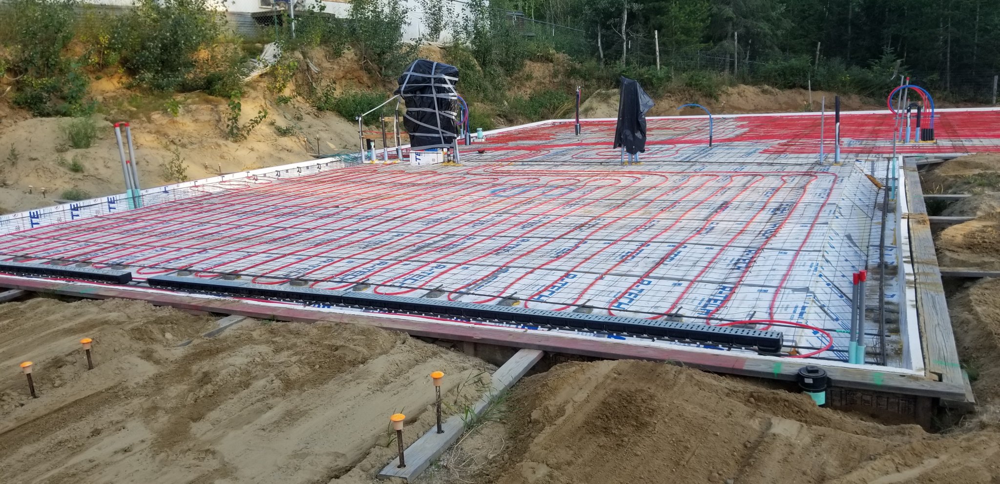

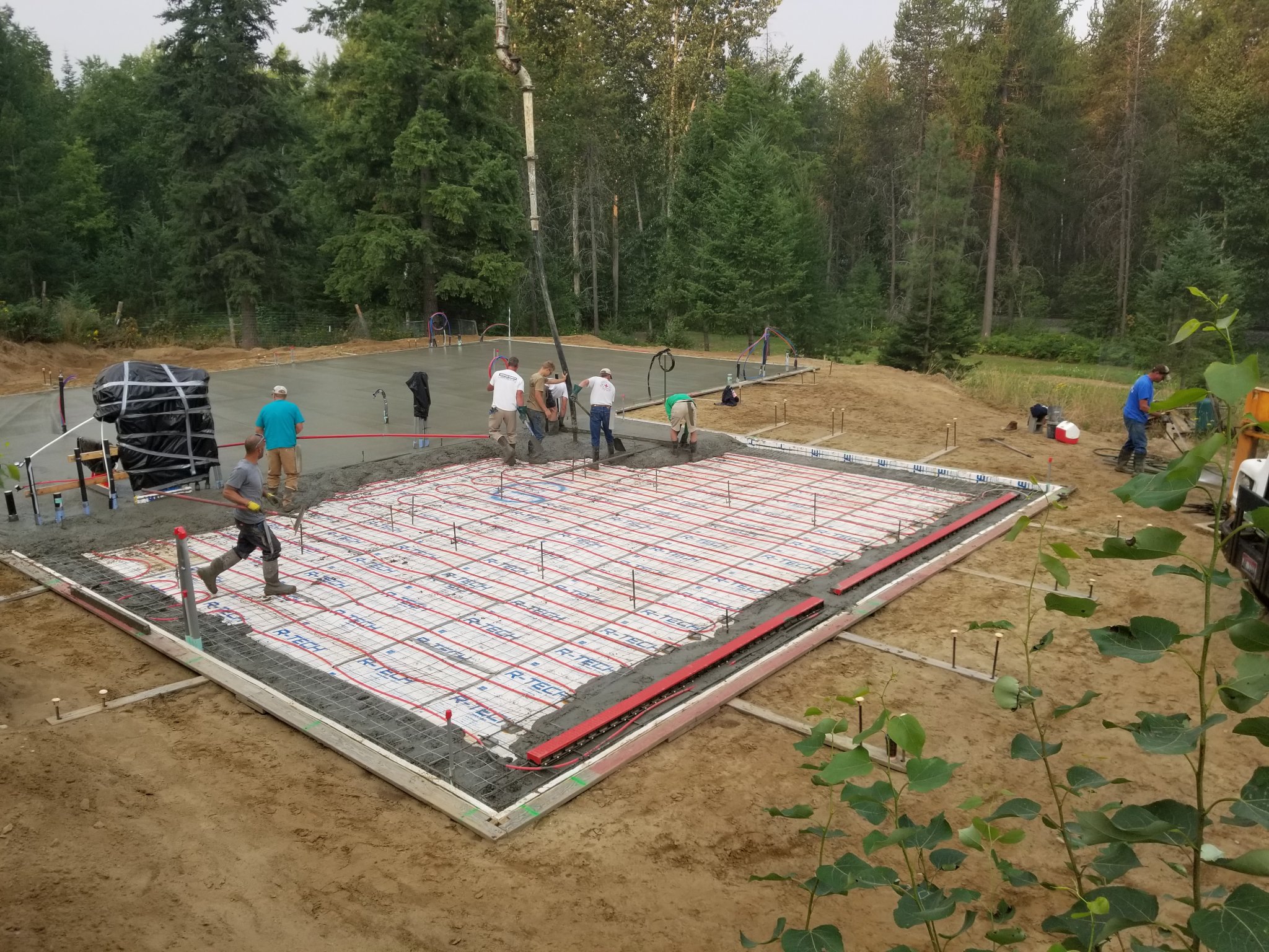

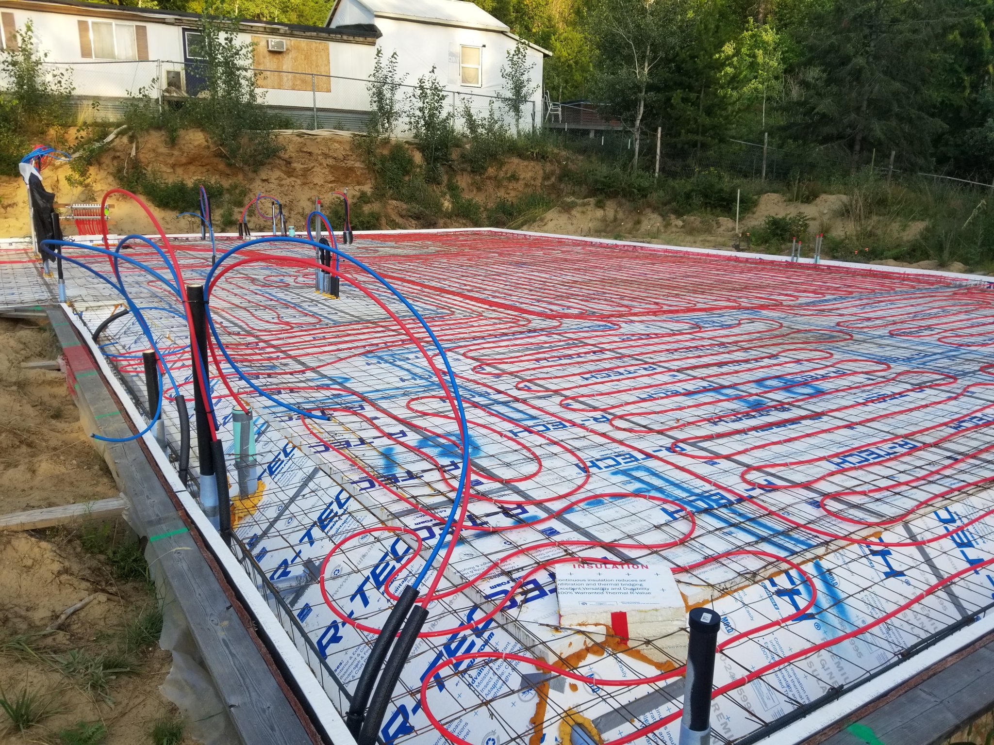

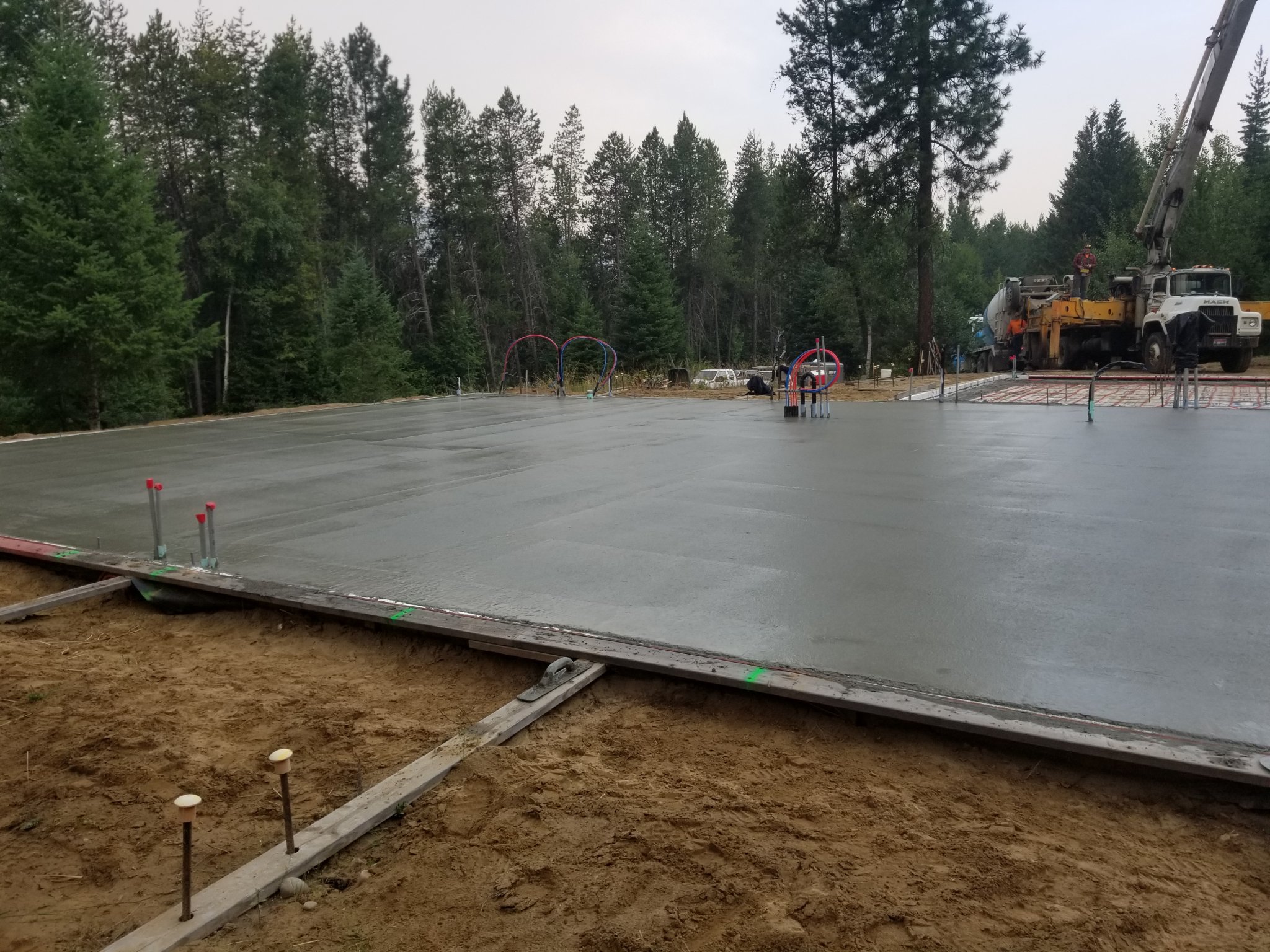

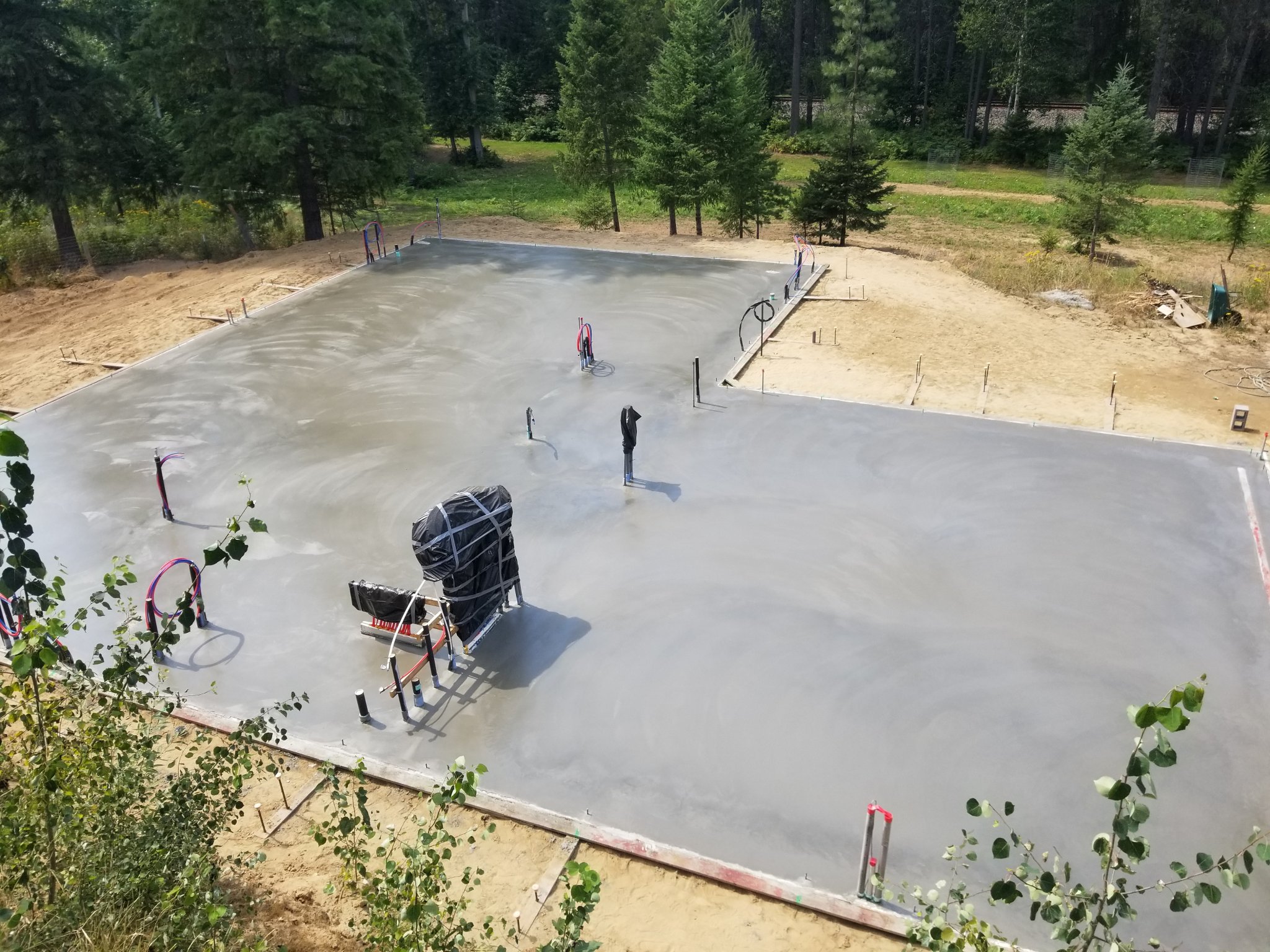

I did 6" at 7500psi, on the garage slab.
I don't think I'll ever put a lift in there, but I can drive / lift / move just about anything on it.
14,554
3,306
Wolf man that just how I wanted to do mine, I was out of town for work and they said it would be like 3 weeks before they could do the pour,, cool,, the contractor came and poured the week I left never put in the tubing electrical nothing drains nuttin. They subbed it out, and the company they subbed to went tits up before I could get a claim filed, seems they were already out of business when they did mine. Ya gota watch contractors!

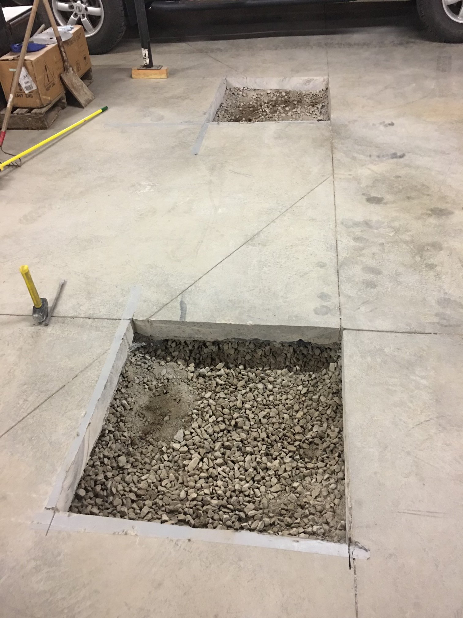

When we installed a 9000 lb Rotary symmetrical two post, the 4 inch 5000 psi was probably "good enough", but went a bit over-kill to make it "WAY more than enough".
Cut out two 4 ft squares, removed over 12 inches of soil, used two layers of mesh, #6 bars, L-Bolts for the lift posts and 5000 psi concrete. Have a friend that installs foundations for things like roller coasters, so the only cost was for the 1 3/4 cu yard of concrete delivered.

I did similar. Cut out 3 ft squares, dug down and out. Re-poured with 6,000 lb mix with rebar so the new part is 10" deep and extends about 6 inches under the existing slab in all directions. Did it myself so the only expense was for the bags of concrete, a days rental on a mixer, and a few Aleve. I'll post pics if I can find them.

Pretty much what the installation instructions for my 9K lift said to do. They also said just tie the new section to the old slab with rebar.
