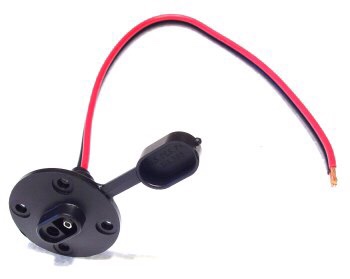

Wildfire had done a video that was for a BX model a while back with a battery tender. The part was simple to hook to battery with a fuse bit you had to drill a hole into the plastic then tighten bolt in place that had a cover to use with battery tender cable. Now with my setup i have the 50’ extension cable and a solar panel but still the trickle charger. Usually the charger comes as a kit with a battery tender and a bolt on cable to be a pig tail. If you want a picture of adapter just ask. I got it on amazon as well for $10.48 to bolt onto tractor.
dfh1977
Jun 3, 2013
198
east ky
Found one adapter as a SAE adapter.
mine was a bolt in type similar to this only it goes to battery directly.

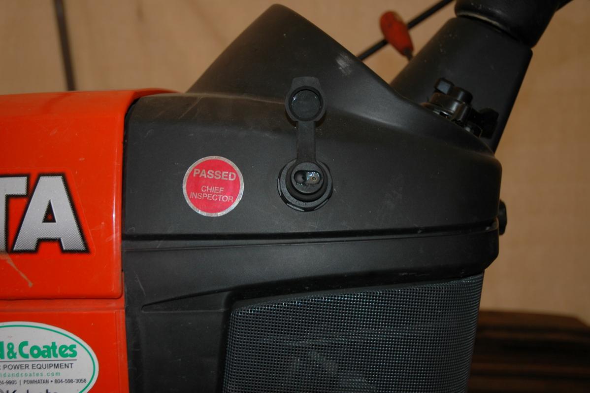

I just installed a port on my BX25D on the left side of the instrument cowling.
https://tecmate.com/products/o-20/
The pigtail is 30cm (12") long and is plenty of wire when connected to their battery cable/fuse. You simply drill a 25mm (1") hole.
https://tecmate.com/products/o-1/
Be sure to coat all electrical connections with dielectric grease. Sorry my little guy is dirty... He is a working man!

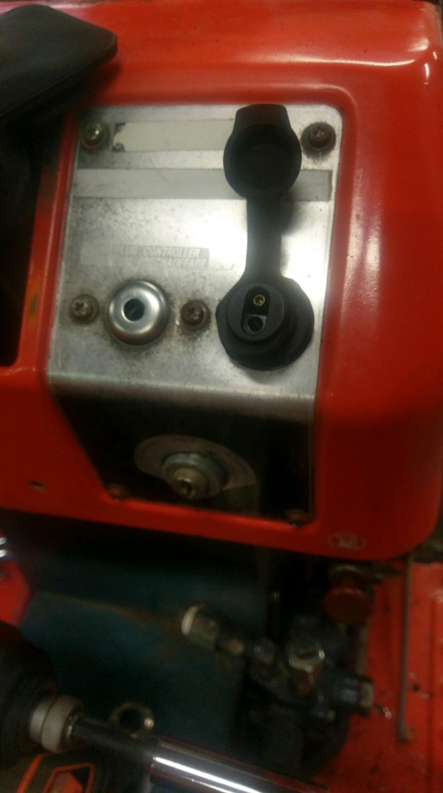

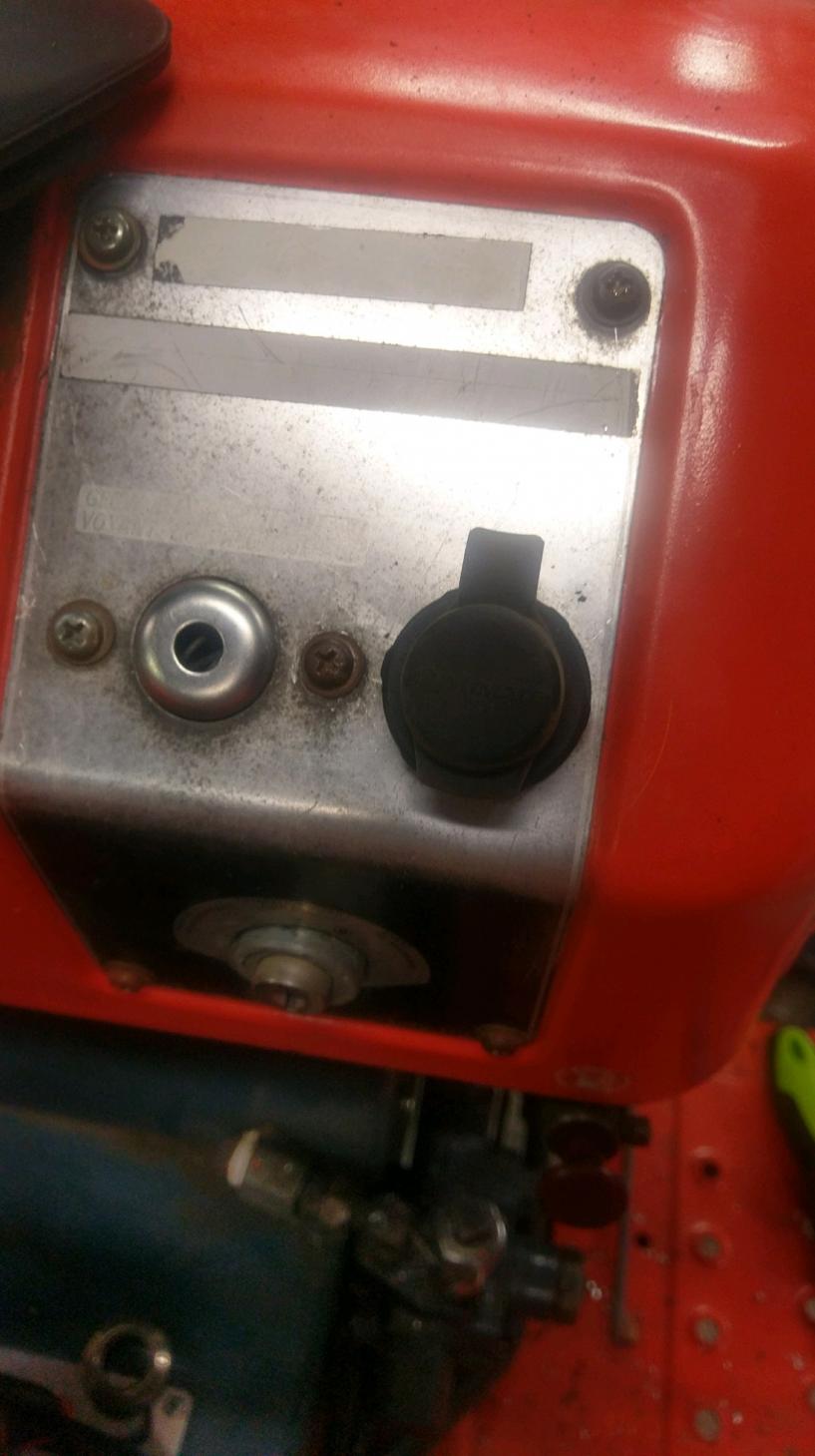

I installed the plug in adapter next to the glow plug indicator on my B8200. There was already an empty 5/8" hole in this spot (wonder what was there), so it made it an easy install after opening it up to 1" for the adapter. Plus now it's in my face so i hopefully can't/won't forget to remove it before driving off.
Looks factory and helped clean up my dash just a little bit by filling the empty hole. I have to wait on a new 5ft cord to finish the install. The one that comes with the battery tender is only 18-20" long.
