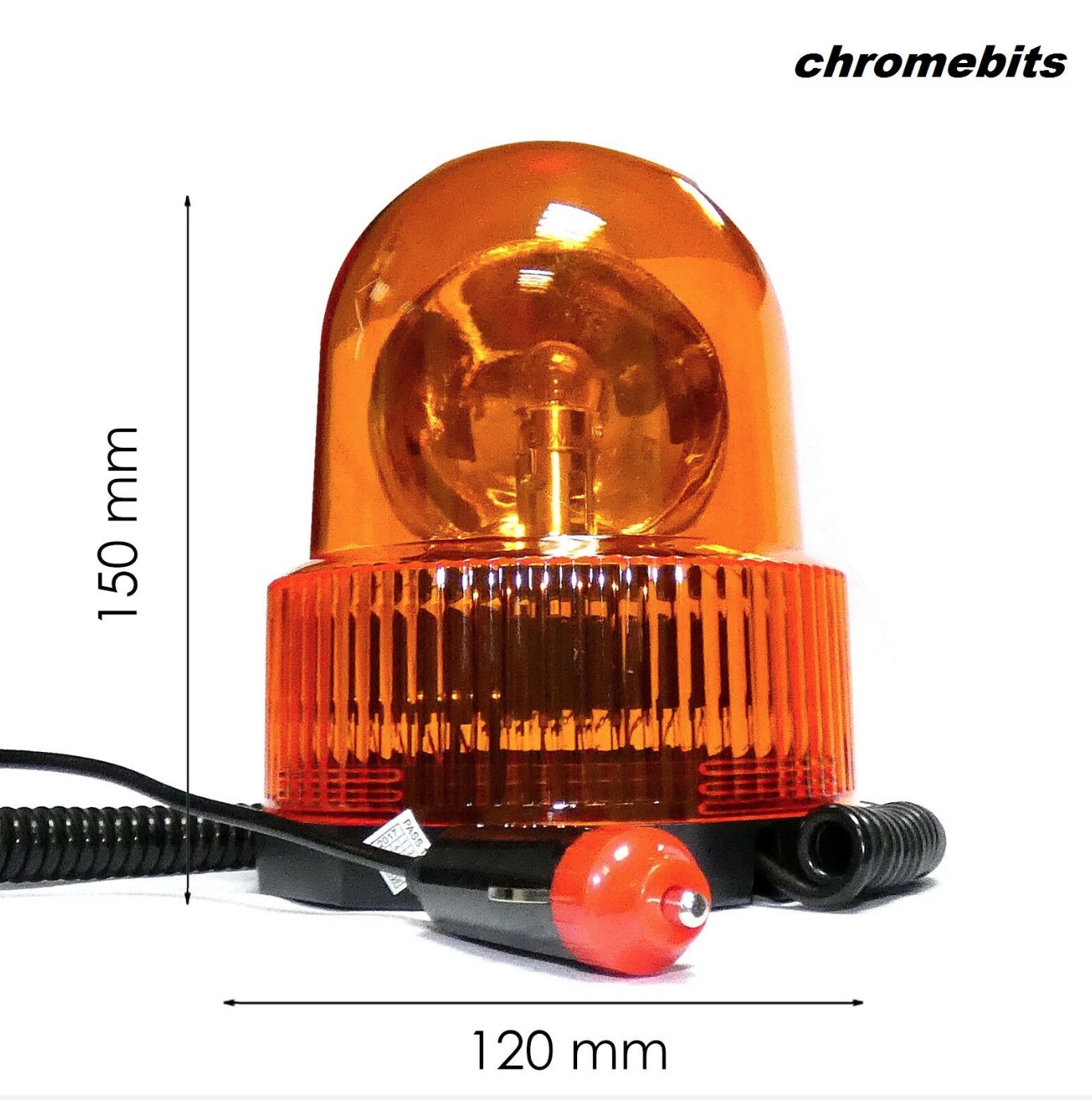

Oh, well, don't do that then. No issues using an amber flashing light in Ontario, but different jurisdictions may have different laws for sure.

In AZ & the peoples republic of CA, you cannot use red or blue beacons, but other colors are OK.
I have a yellow one & a green one that I use in the dunes or when decorating vehicles for Christmas & such.
YMMV.

I double checked the Ontario HTA. Red and blue are reserved for emergency vehicles as are flashing headlights, and green for volunteer firefighters' private vehicles while responding to an emergency.
Tow trucks must display a flashing amber while towing a vehicle, and I think escort vehicles for oversize loads, but there's no restrictions on other vehicles using them too.
9,989
4,102
yup ,escorts need the flasher ambers on..
even when they're 100s of meters away from their super oversized load that's doing 122KpH ( 70 MILES PER HOUR )

The lights themselves are not illegal. How they are used is what the restriction is. In this case, they could only be used when my car is not in motion. Here is a link to the applicable section in WA state law. There are other sections that apply to auxiliary lighting but they do not apply to my vehicle in this case

You folks can't use amber flashing lights on private snow plow truck either?
In Vermont, one needs a PERMIT to even have such a light on a private vehicle. If your wife (without permit) wants to use that vehicle, the light must be covered. (usually a winter tuque is used.)
