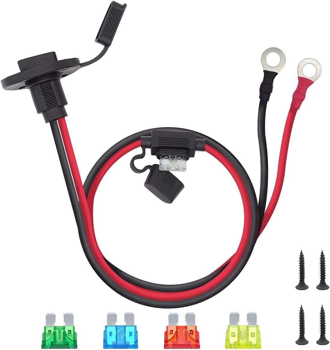

I recently purchased a 2019 Kubota BX1880 for landscaping
around my property and to assist with snow removal this
winter. I had to perform all 50 hr maintenance because the
previous owner did not. So like everyone we like to add to
our tractor. I just added a port for my battery maintainer
for cheap money. I added the port to the left side of the
tractor near the passed sticker on the console. 20 min
job. Now I will leave the Maintainer hooked up on those
cold nights. It comes with everything pictured.

I would like to do something similar to my old mini excavator.
How about the male plug that goes into the female receptacle? Source for that? Or is this a standard of some type, and do battery maintainers come standard with a plug that will fit?

SAE quick connect.

I think most maintainers would come with a mating half directly on the charger and then some plug on battery clamps. Then they sell the separate direct to battery terminal pigtails.
At least that is what Battery Minder does at Northern Tools

Most battery maintainers come with the male adapter. It will normally have a set of jumper cables, that have a female connector for the male. I personally have two maintainers, one is an older Optimax, and I have a newer one which is better that is a NAPA and that only cost me about $30 dollars. When the maintainers hook up they also de sulfate the battery. By the way I installed one of the ports on my
Polaris Ranger side by side, which I use in the winter for snow plowing. I life in the mountains of Maine and we have very cold winters, and lots of snow. If I didn't have them on my machines, they would have a very hard time starting at -20 degs, and by the way i am old school to. I used a 7/8 inch spade bit to drill my hole and did a little reaming with a rasp file, so I had a snug fit. 30 min job. Good luck.

Most of the maintainers use SAE electrical connectors. I have several of these from Northern Tool:
The SAE connector is what you see on the end of the alligator clips that come with this particular model maintainer. That SAE connector mates with the SAE connector that is attached to the maintainer. Northern Tool sells an SAE connector with ring terminals which you can attach to your battery and then just plug in the maintainer to that SAE connector instead of having to attach alligator clips to your battery each time. This is a pic of what Northern Tool sells but the price right now is a rip-off. You can get it much cheaper if you search around on line.
The SAE connectors have covers with them to protect the terminals, as seen in the photos. And as you can see, they are fused in case of a short.
