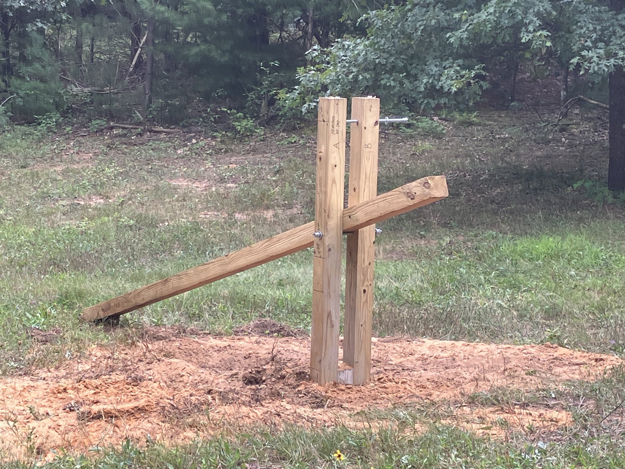

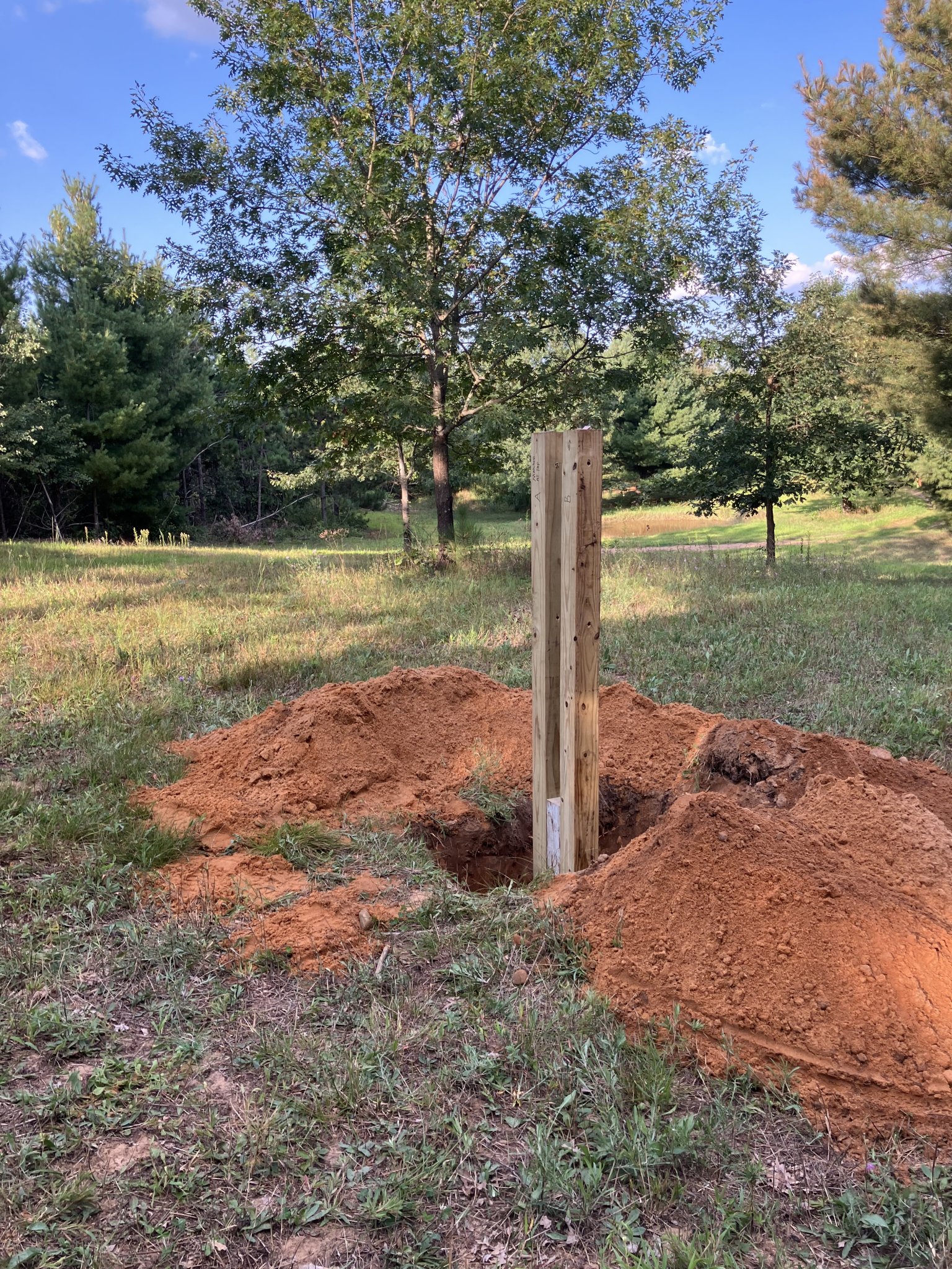

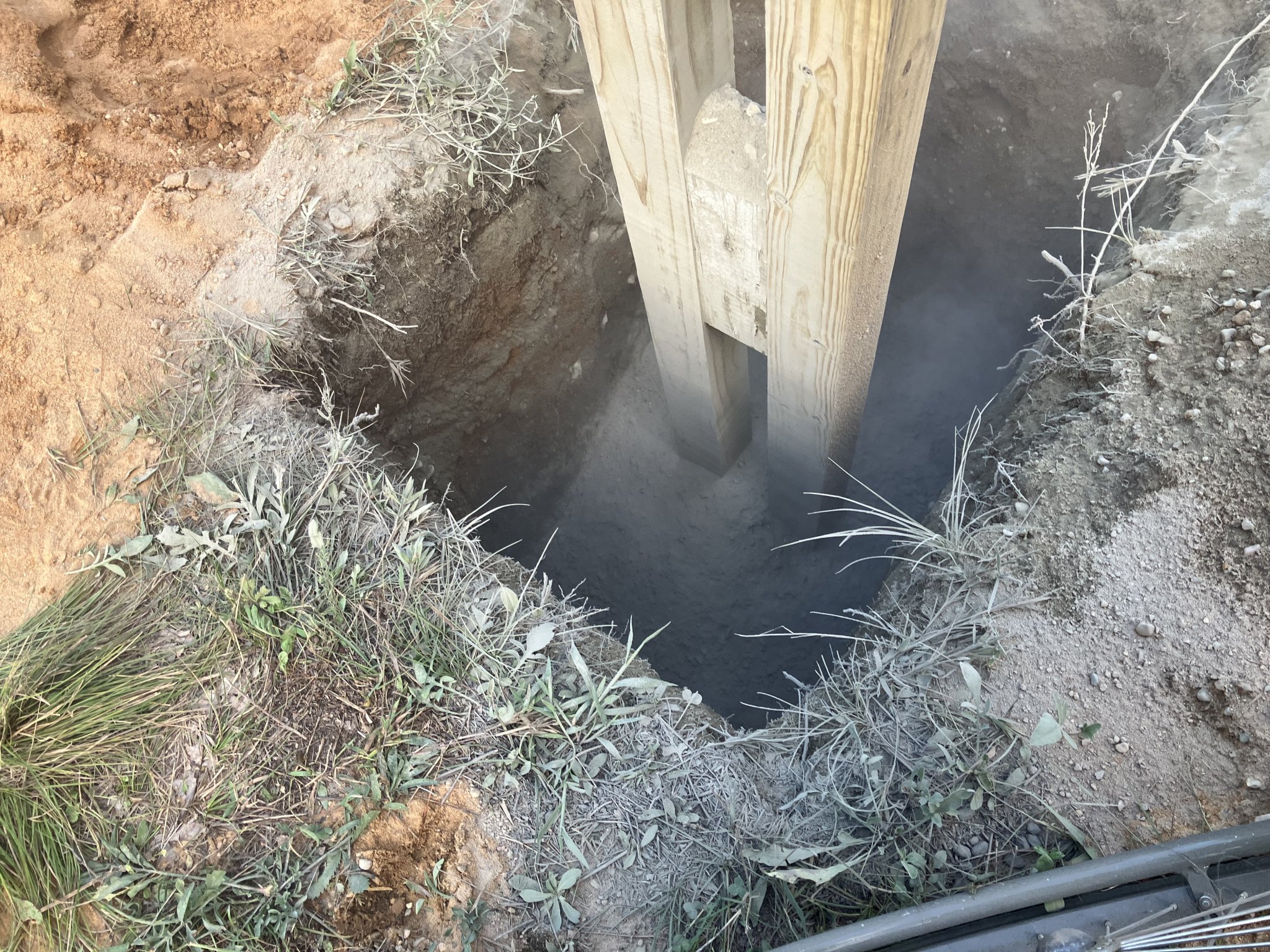

Built the bases at home. I did use 4 x4's instead of 2 x 4 or 2 x 6 . All pressure treated with galvanized lag bolts and washers, 1/2" dia.

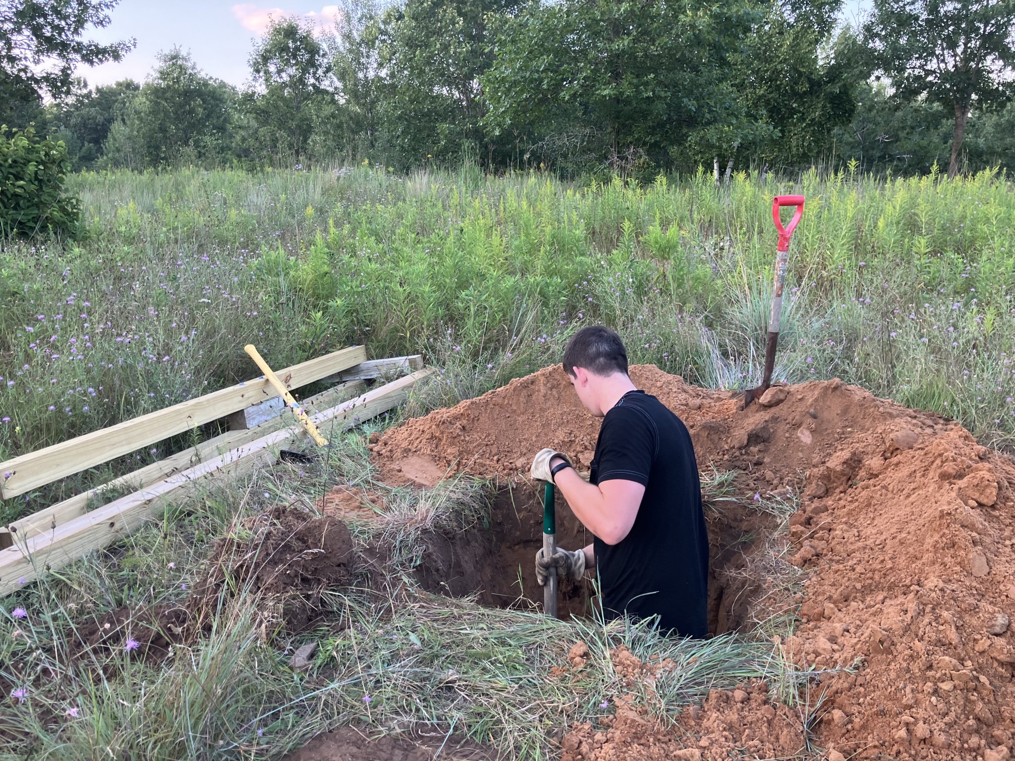

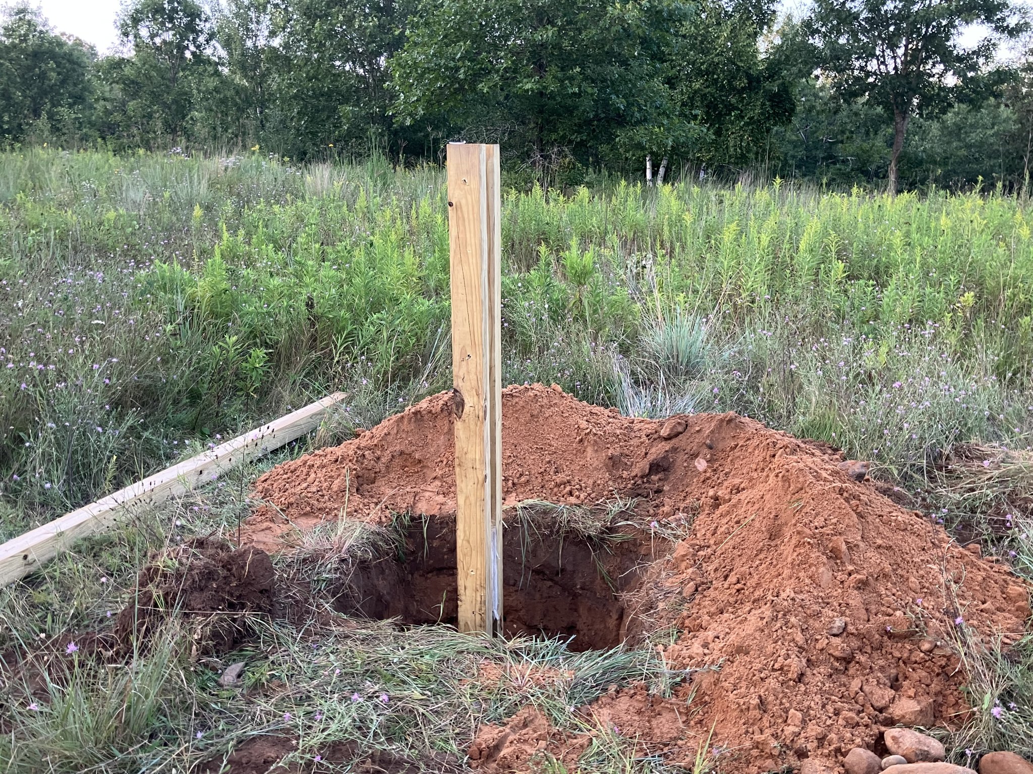

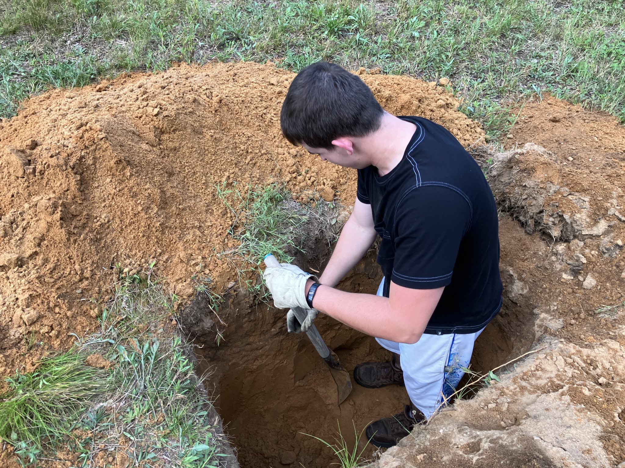

Excavated the two holes, 40" deep . I have them set in the hole, now need to set in the Quickcrete , level and backfill. If I need to counter weight the top hinged section I can deal with that after I have them installed with the nesting box/bat house.

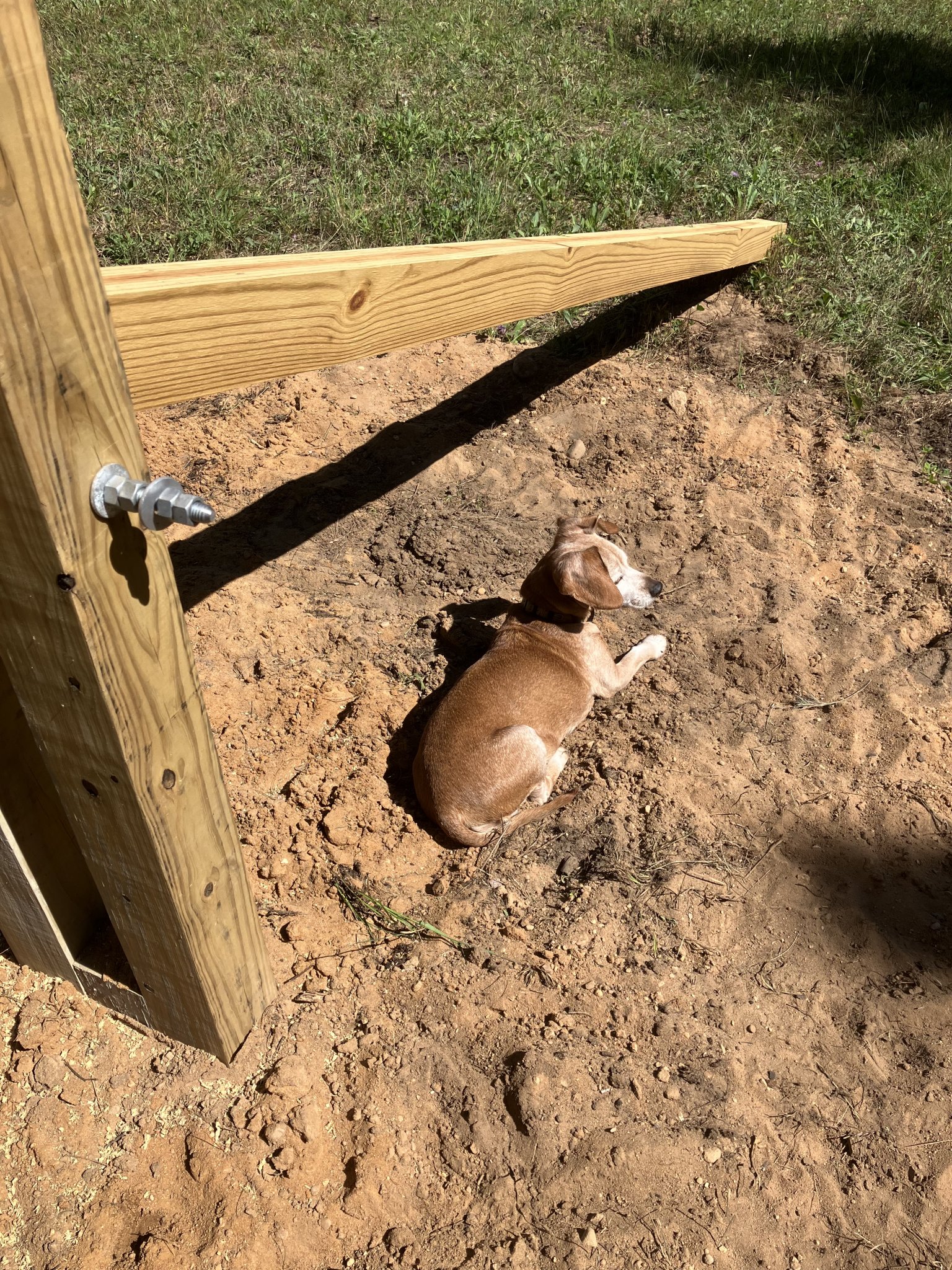

I ended up using all-thread for the two top bolts that will allow me to pivot the 12 foot 4 x 4 down and up. Jam nuts and washers so I can adjust the tension versus carriage bolts.
I feel pretty good about the base build and the depth. The total height from ground level to top of the 4 x4 will be just shy of 14 foot. I was required to have them a minimum of 12ft.
I am under a deadline to get these things in the ground and set up with the nesting box and the bat box. After that I can deal with some details like cutting the tops of the two base 4 x4s at a slight angle to shed water. I also will install a "stop" so the top 4 x 4 and only hinge one way.

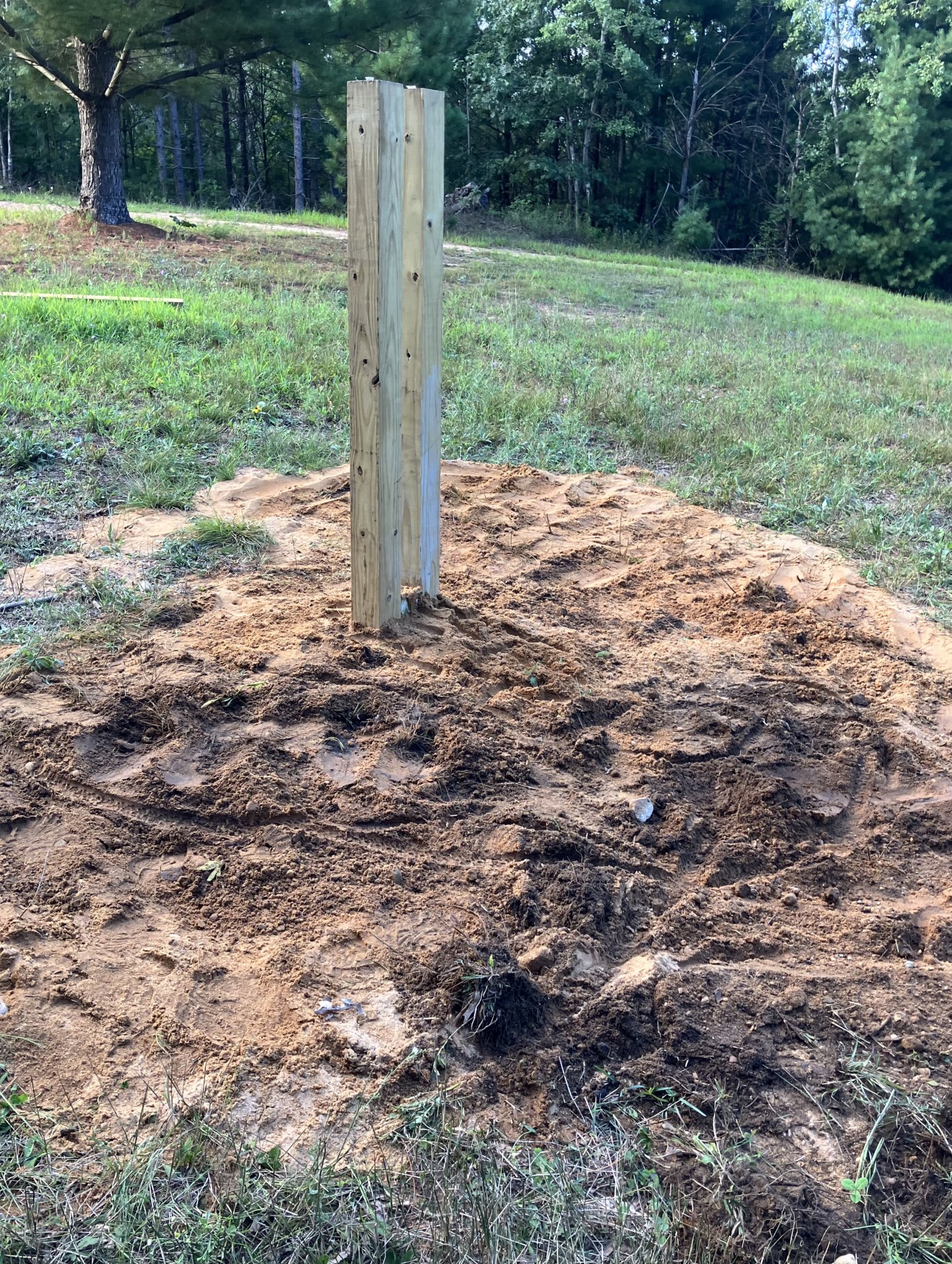

240 Lbs of Sakrete in each hole, leveled the bases and backfilled.
I should be able to get the top 12 ft pole with nesting boxes installed by this coming weekend.

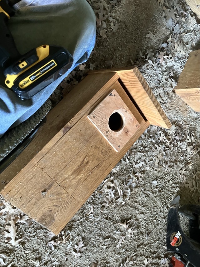

I had to modify the opening of the wood duck box to work for Kestrels. The opening is oval shaped and larger than what is required for kestrels. They like a 3" round opening. The rest of the box is the same.

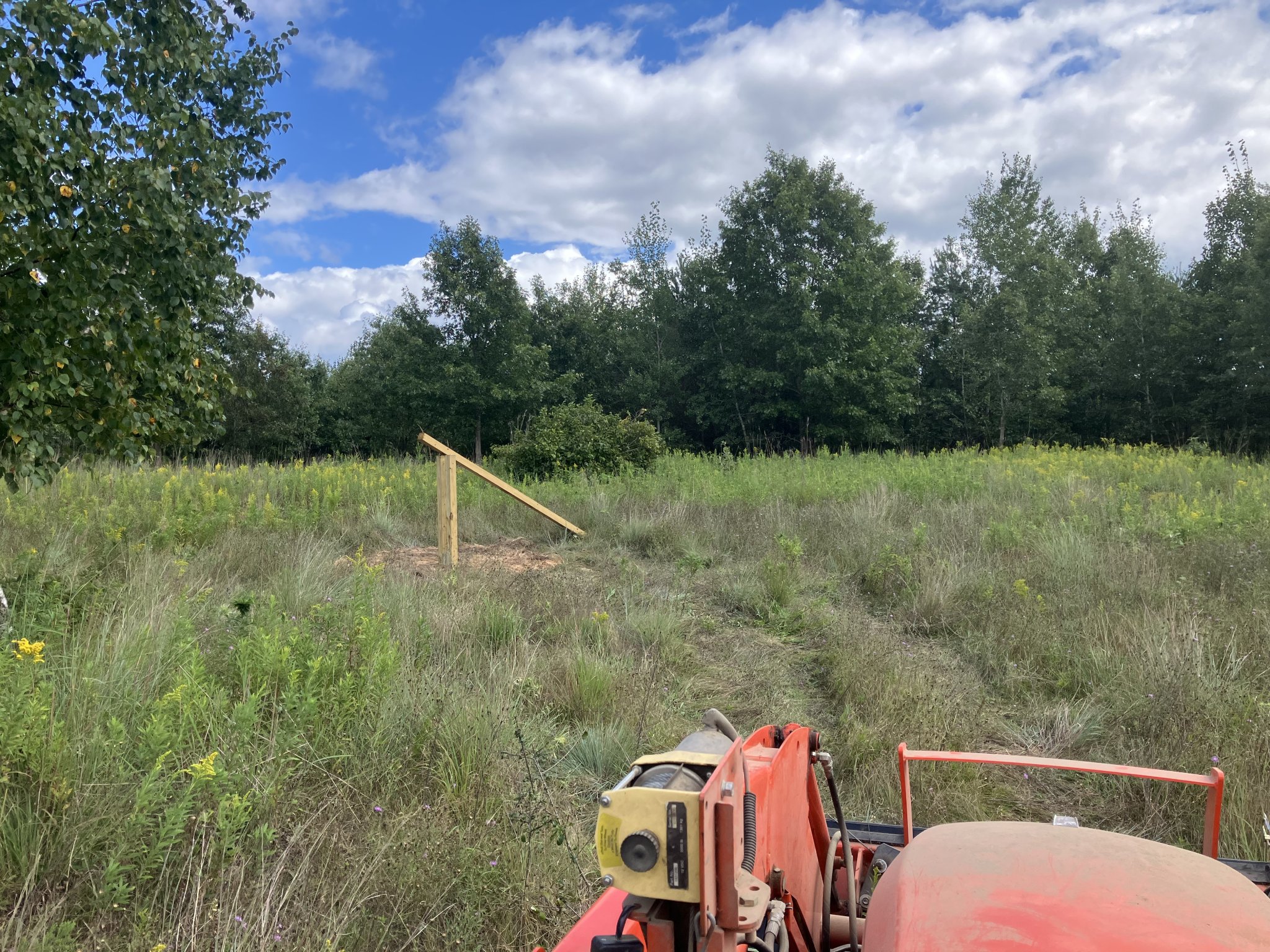

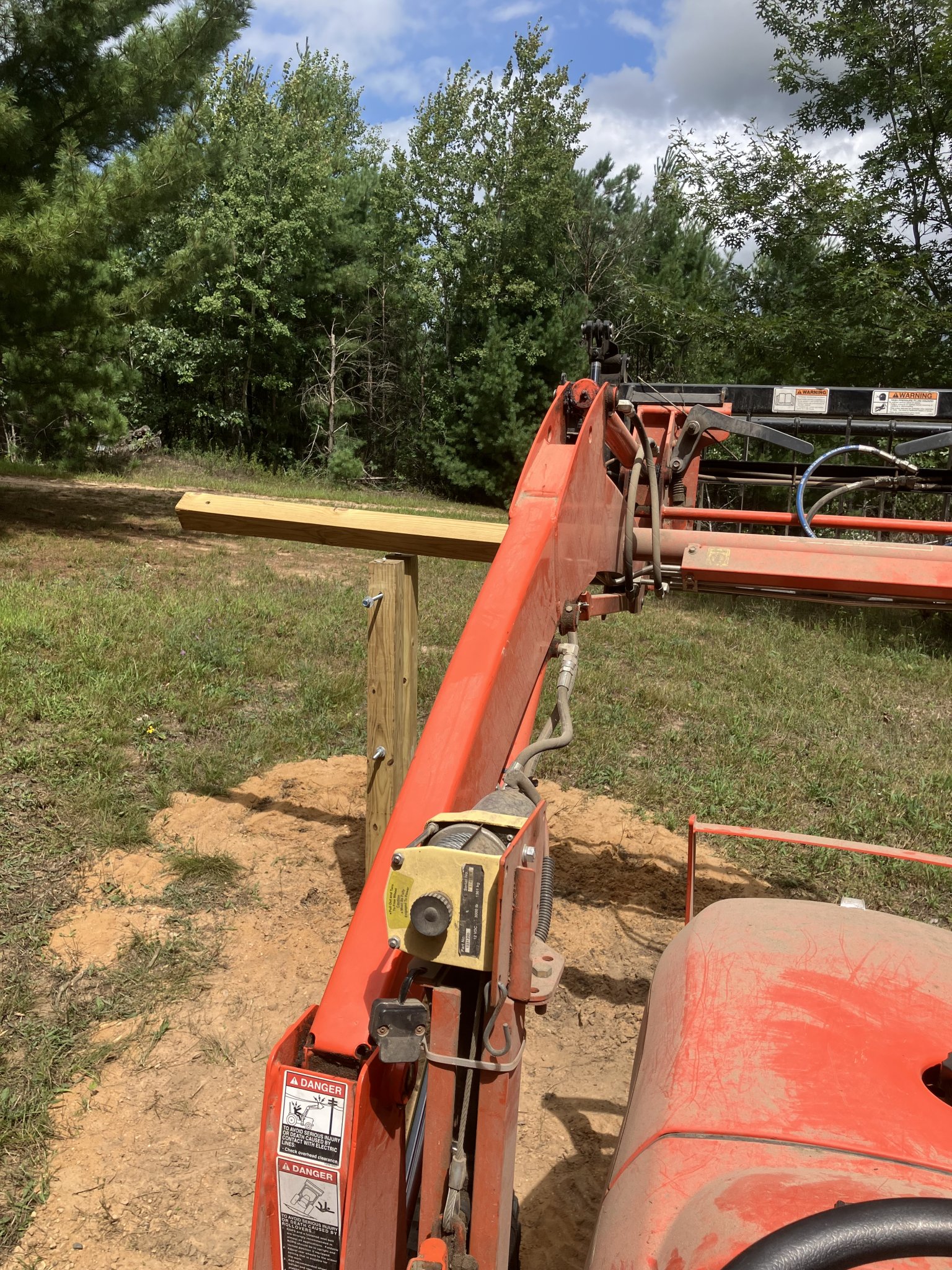

Had a good day yesterday on the L2501. Did some trail mowing, moved some downed oak trees that I cut this spring out from my deer blind.

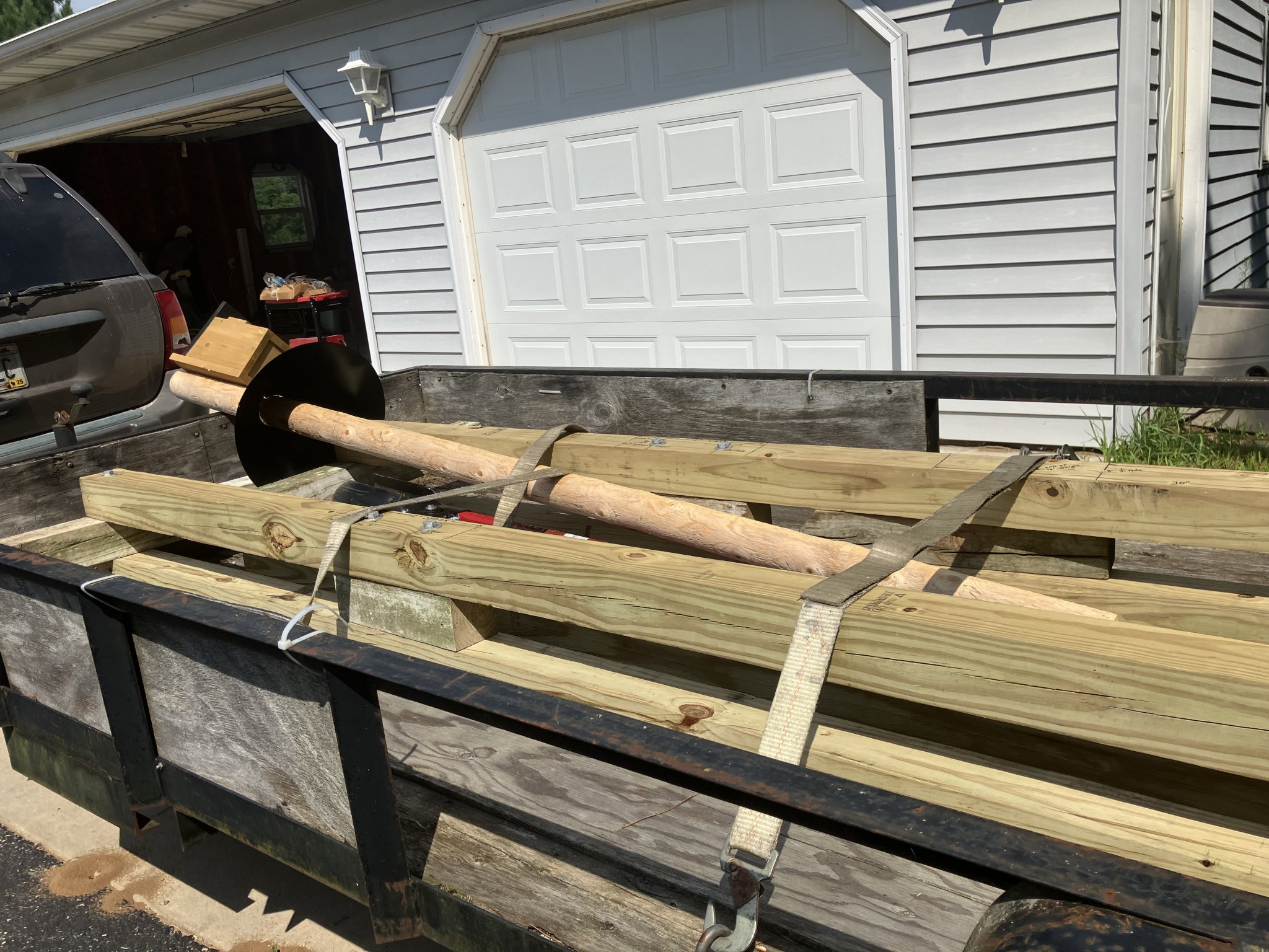

I also used it and the grapple to move the top section of my nesting box poles.
I know it does not seem like a big deal to move a 12ft 4x4 but for me in my chair it is awkward and heavy, especially moving in the loose backfilled sand.
Ground to top of pole should measure 14' 4" plus or minus. 12 ft minimum was required.
I think one more session to run the hinge bolt , install the boxes and then raise them, and this project will be done.
I had my little inspector give it a paws up, :)

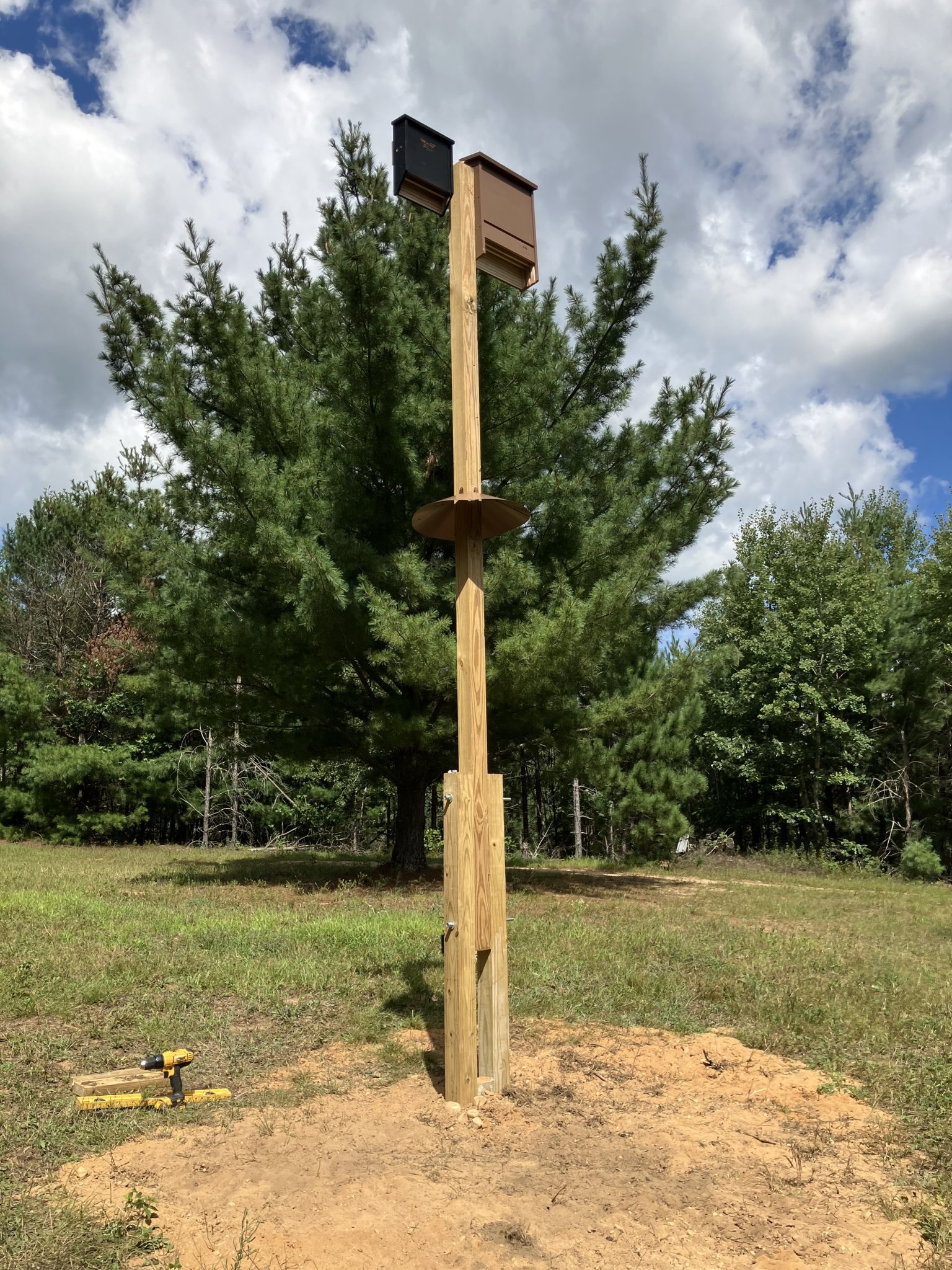

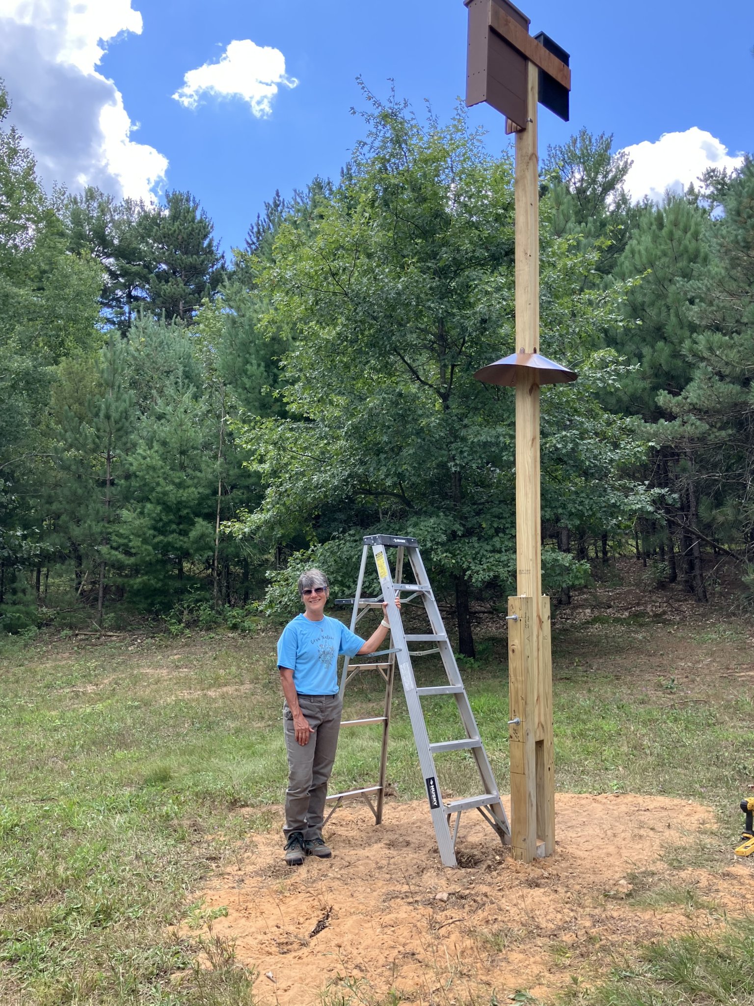

With help from a good friend we got the bat house boxes and upper section installed. Just have the kestrel box to go and I will have met my goals and requirements!
I very much appreciate the suggestions and advice! This thing is solid as a rock and will be fairly easy for me to lower it for cleaning and maintenance.
14 1/2 foot does not seem that high until standing at the base. I am thankful I will not have to ask someone to climb a ladder once a year to inspect and clean.
The predator guard was a requirement.

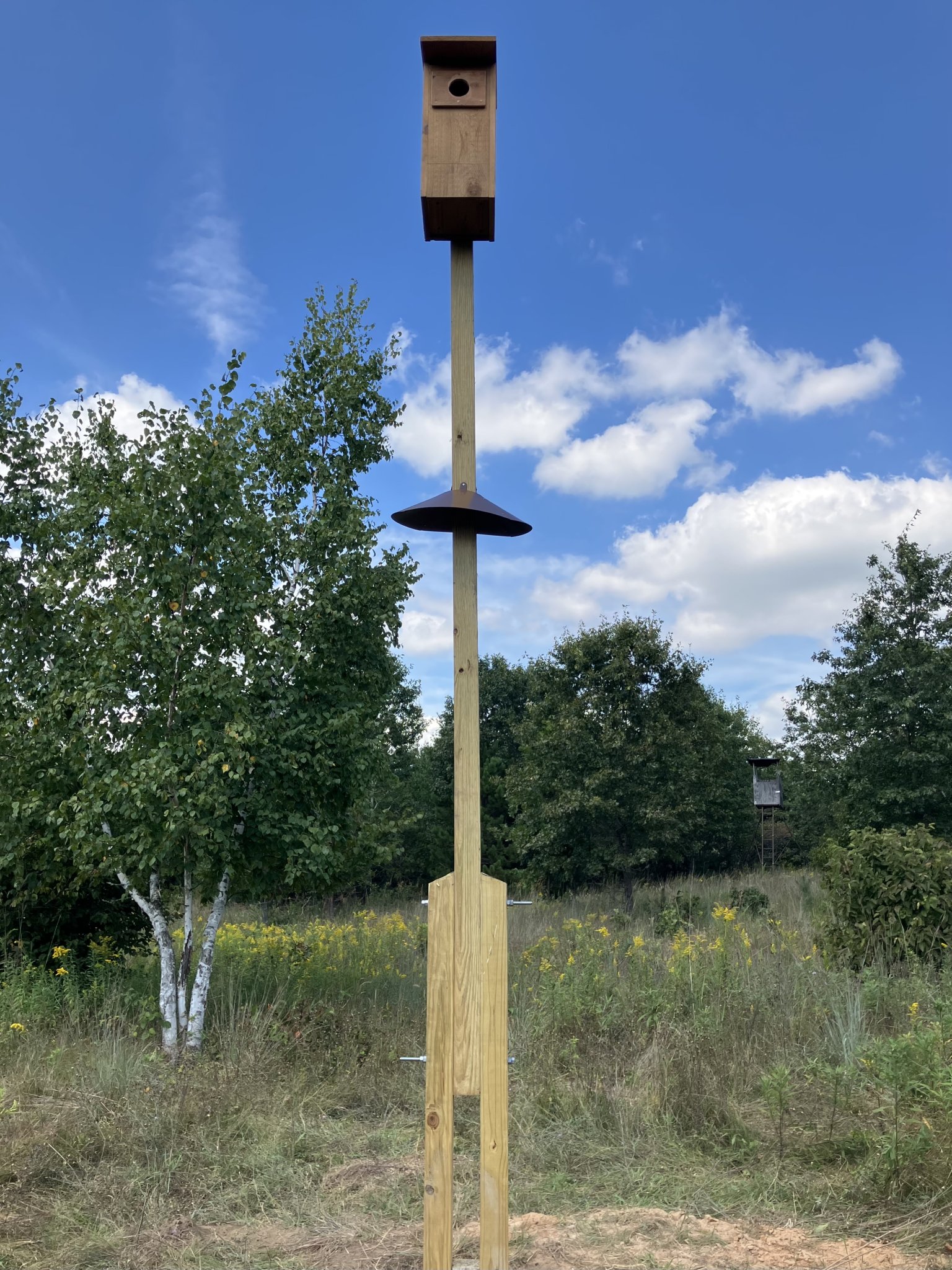

Finished up with all three required nesting boxes. Bluebird, bat house and today was the Kestrel nesting box.
I had a lot of fun designing the pivoting tall bases and poles. Had great time with the friends that helped with this project.
