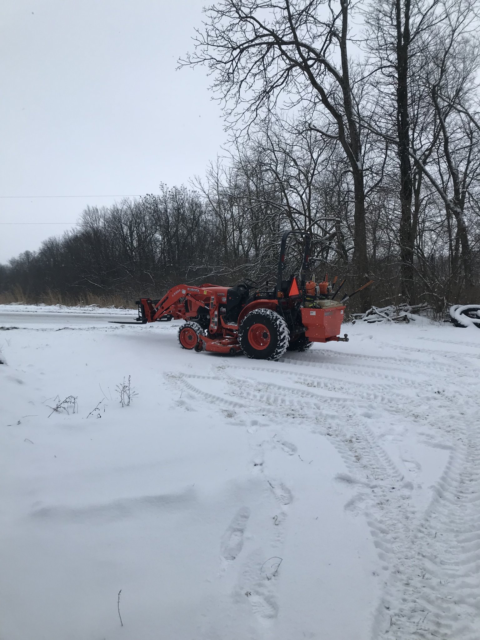

eipo
L4060
Dec 1, 2015
693
MI
This is what I made, built around a QH Trailer mover...

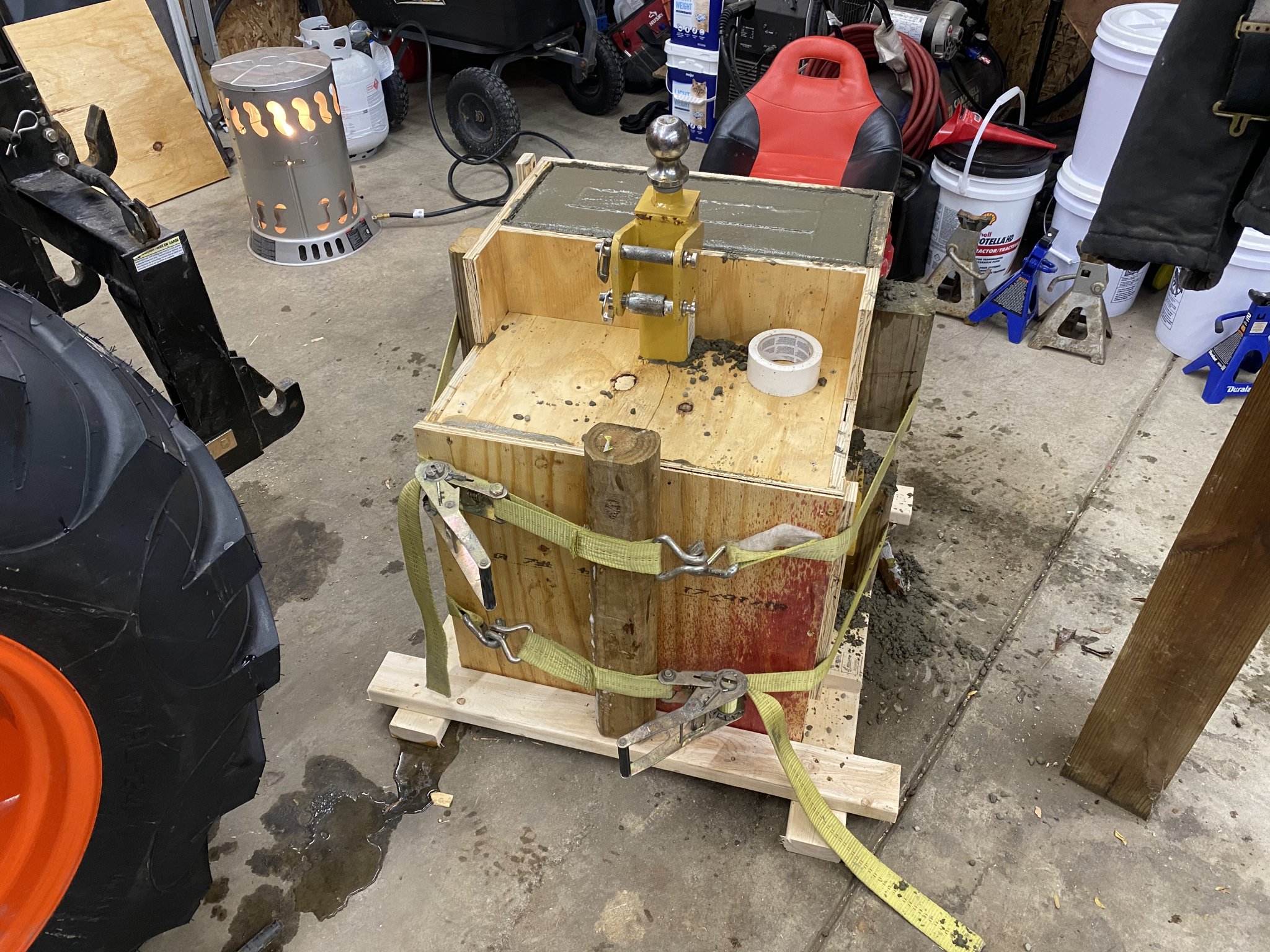

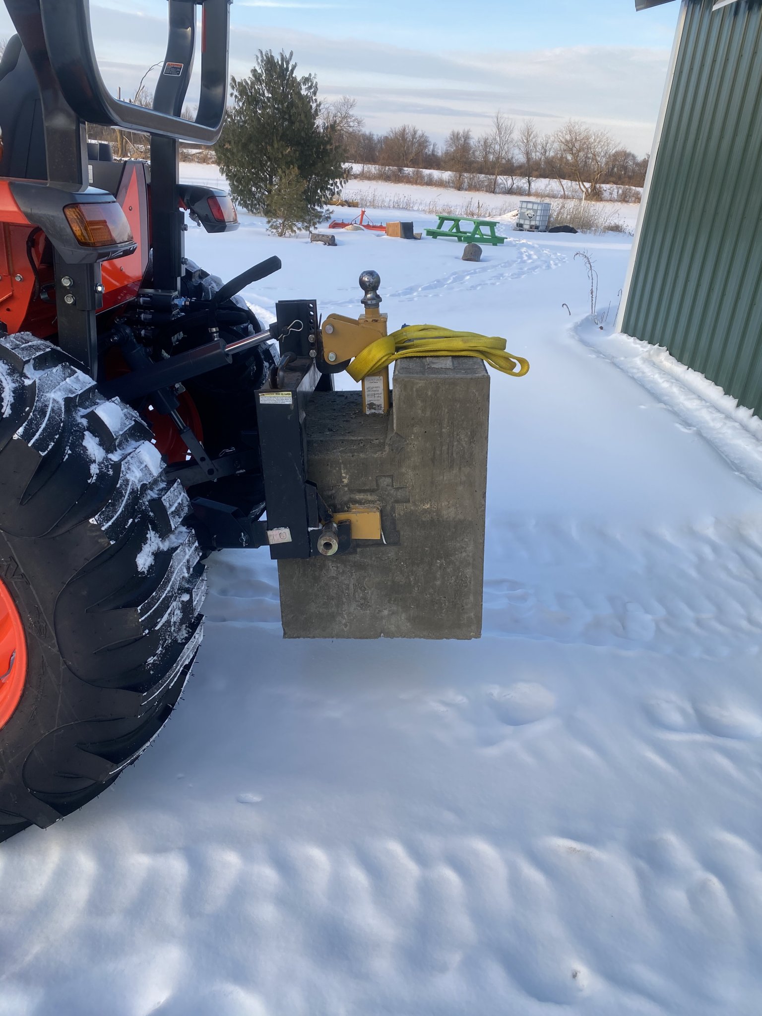

PeteW
Maybe 3901
Mar 10, 2021
7
Western wi
I’m getting a new LX2610 delivered soon and I’m wondering if someone has plans for a ballast box I can make for a little extra weight in the rear when the backhoe isn’t attached which will be most of the time.
For my ballast I purchased a 3 point carry all frame from tractor supply, cut the bottom arm off at 12” then formed up a plywood form and filled it with concrete. I imbedded anchor bolts to connect the concrete to the frame. My weighs about 850 pounds. And the price was less than the empty ballast box frames you can buy. If i were to do over , I would go wider and a little taller to get closer to 1000 pounds.

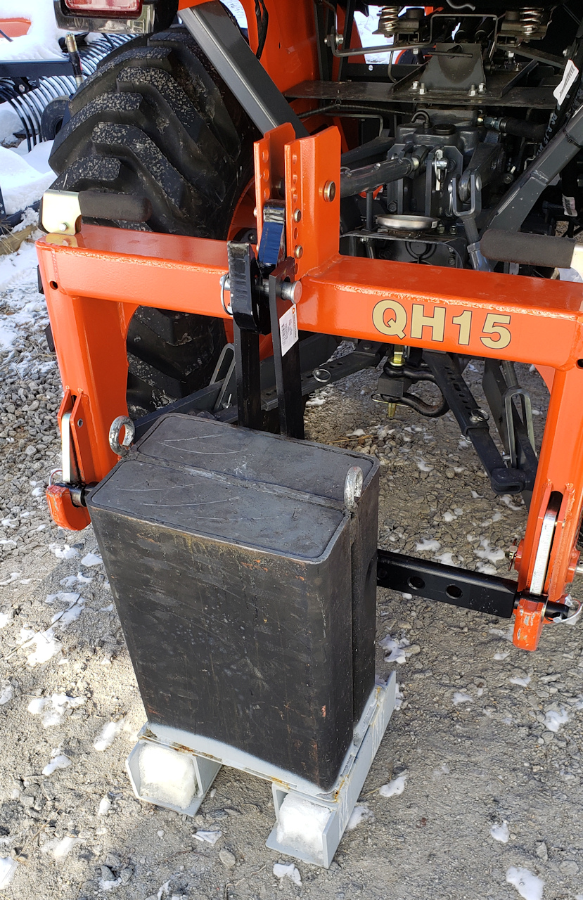

I went with an 800lb lead filled box. I was looking for super dense and I couldn't afford gold.
My ballast box is my second most used attachment.
