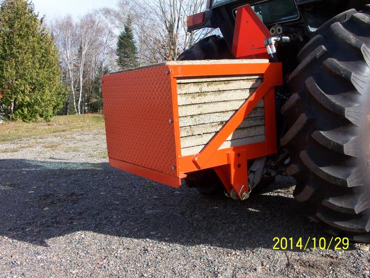

Ballast box

Does anyone know what the weight limit is for the 3 point on an old L series? I have an L185 and an L225. The L225 has an FEL and needs ballast but I don't want to overload the 3 point. A little extra traction is all the L185 needs so I won't get close to the limit on that one.
Thanks,
Tom
5,487
1,491
For the L185 the limit is 660 pounds at the lift eye
