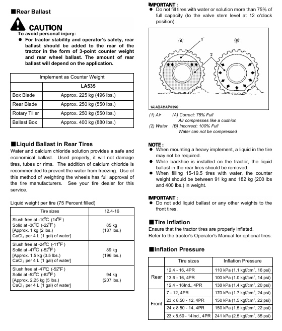

Another thought ...
Quite often we hear/read the suggestion of "put as much weight on the back as you want to pick up in the front" ... Which is basically what the first video does, and while it restored the basic 70/30 split of weight reduction ... Is the front axle overloaded at that point? Tires?
For those that have that same tractor loader combination, I'd be VERY interested in some actual numbers out of your manual ...
Like what is the front axle actually rated for?
What is the stated "lift capacity?
What is the rear axle rated for?
What are the tires rated for?
Another thing is not just the pounds/kilos of weight on the back, but WHERE it is in relation to the rear axle ... A quick hitch will push that weight back another roughly 5" ... So that same 650 pounds is more effective, then if it is "at the pins" of the lower arms ... My 5' wide brush hog is 8' long and weighs 518.4 Lbs, but my front axle is light enough with the tail wheel off the ground that I need to add ballast to the bucket! Whereas the the factory BH with aftermarket thumb is 651.0 Lbs is more balanced, and doesn't need front ballast to turn ... My homemade 707.0 Lb ballast box that has recessed pockets for the QH to go into, to keep load close and compact to the back of the tractor, also doesn't need front ballast!
This is from when I was building it, after concrete was cured, I knocked out the 2X4 spacers, so the QH could slide in and grab that pipe ...
The ballast box stays close, and the extra 275 Lbs of weight lifting plates is very close to the rear axle, and probably is only as effective as 125 Lbs if it was out at the ends of the arms, as far as "rear ballast" (to compensate for front load) compared to "rear axle ballast" for traction ... Which is the primary reason I use it for.

I've always considered a good rule of thumb is what ever the front can pick up you should try to hang off the rear or as close as you can. Rear lift capacity always exceeds the loader capacity so that isn't a problem.
Distance from the tires is also a consideration. When I made the mount for my offset sickle bar mower I weighed the front on my LX. For one to check side to side stress on the loader and for another to make sure I wasn't maxing out the tires. As it turned out I added two hundred pounds to the left side inline with the loader arm to offset 120 pounds hanging further off the right side. I DID end up with the front tires near max but I didn't have anything on the rear when I did it so I need to put some rear ballast on just to use that mower on the front. My rear tires are loaded and I have a cab so it doesn't feel like it will lift but getting some weight off the front will give me more peace of mind.
SOOO, while it's nice to have the rear ballast tucked in close it has more effect the further from the tires you can mount it. A thousand pounds four feet forward of the front tires won't be entirely offset by a thousand pounds two feet behind the rear.

I am no mathematician or anything, but I do like ratios, fractions and percentages as a guide.
I think 60% - 2/3 weight on the rear of what planning to pick up on the loader is a good start and fairly safe for moderate inclines.
where I feel the steering get light is when I have 90% on the rear (like my BH92) and nothing in the bucket up front, then steep grades get interesting.
not sure those are rules to live by but for me and my terrains between three hilly properties, 2/3ish is what I want for ballast as a min if planning to lift near max loader capacity, and ideally the BH which is close to 90% of loader limit is awesome on flat groundnut but steering gets light on steep grades.
That math also is pretty close on B from my experience with my chipper (900lbsish) as ballast…very light steering. If need to handle a grade need the ballast box in which is a bit less at 600ish lbs.
anyway that is what works for me. Took a while to come to those ratios but thought i would share. I have loaded tires on both machines and my MX has three plates per side as well.
Hill billy hack…sometimes have to back back up the hill to be safe or vice versa depending on load and steepness of terrain.
struggle for average hill billy is I don’t weigh everything I do much less the variety of terrains I navigate, so I like ratios
