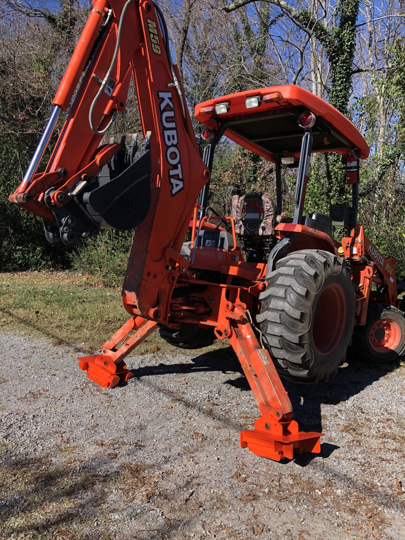

My M59 had a thumb with pin on bucket. Buckets almost impossible to find.
looked into converting to the excavator style like the M62 uses. Coupler QA only $1,200. But not compatible with thumb. To get new thumb $3,000. No go.
USA Attachments make a coupler for the M59 to fit Kubota Excavator KX quick attach. Took some modifications to suit me and more modifications to the existing thumb. Also ordered two excavator buckets. After selling the pin on bucket have $1,800 in new KX QA coupler and two new buckets.
Now just finished making an adapter so can use excavator attachments on my B26.
8,005
5,187
And.....that adapter is one mighty innovative little device.:)
