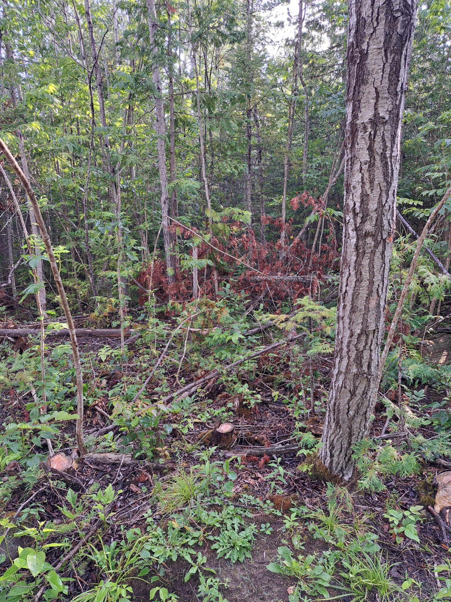

We only have 5 acres and most of it is sh!t woods. Mostly 1 to 4 inch small trees and Vietnam thick.

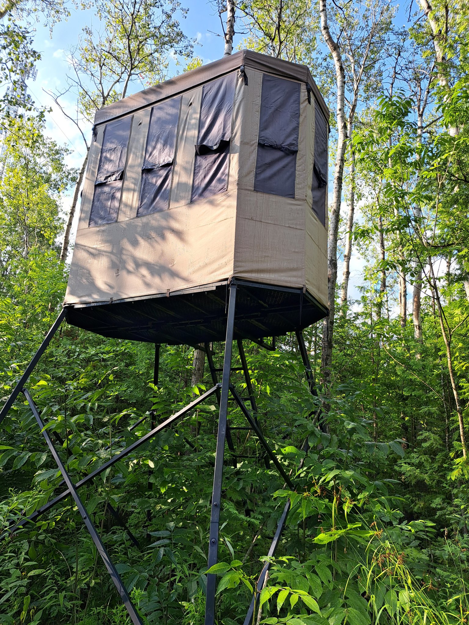

I have a blind out back near the property line and a small clearing for a "food plot".
I wanted a "shooting lane" so I can get off a 100 yard shot instead of the current 50 foot shot during hunting season. LOL
It will also will double as a "dirt track" for my for my grandkids Go-carts/mini bikes...etc
Heres the blind and a shot 180 degrees at start of the day.

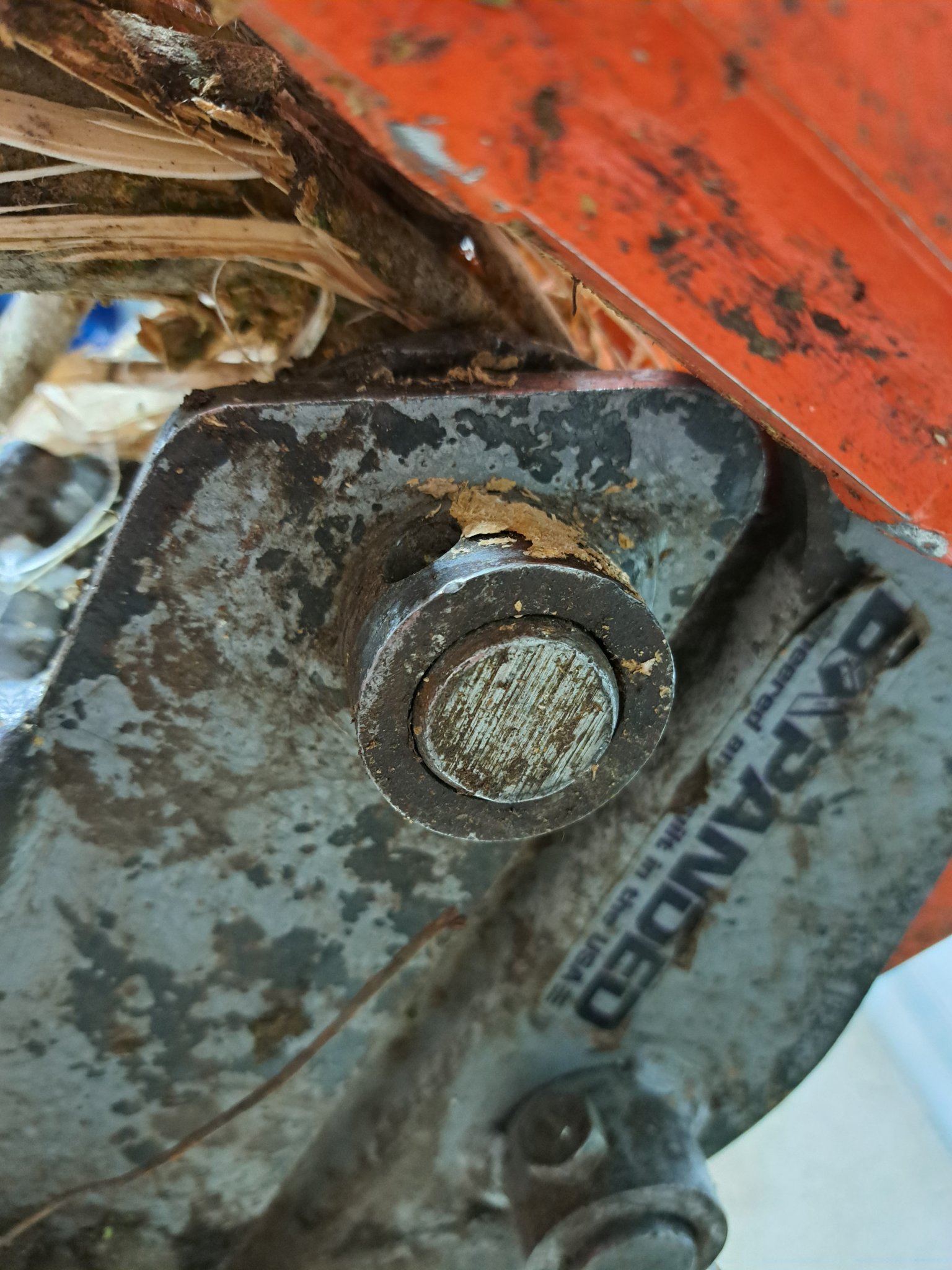

Well anyway, about 6 hours later, I am stepping back onto the backhoe and I see this.
2,348
2,661
Yep the damn pin fell out.
Well that ended the day.
I got about 50'ish yards done of the projected 100. Still needs some attention, but not a bad start.
I put the tractor in the pic for size reference.
I searched high and low for that pin, but nothing.

Make sure the sliding piece on the pin is in the lower hole that keeps it from coming out. Not by mine right now to post a pic
2,348
2,661
Yes sir, I know exactly what your talking about. I sure thought it was.
The terrain is very rough, so I'm wondering if it got vibrated loose somehow?
My subconscious is working on some sort of fix so this doesn't happen again.
Something like cutting off the factory lock pin, and using a D-ring locking style pin.
Something like cutting off the factory pin, and using a locking style pin.
Good deal! Was just making sure cause I’ve seen other threads here where people putting it in that top hole and it won’t stay in. 🍻

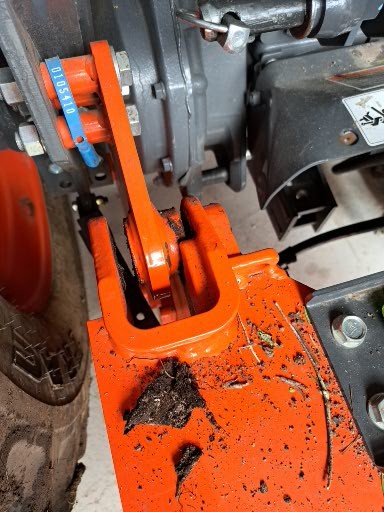

I am not familiar with your specific pin issue, but .....
I have a 1"dia. long pin for my BH quick connect, that has a propensity to find it's way out.
It comes with a "D-ring" style locking pin, but the loss of that locking pin creates the loss of the big pin.
($100 + days waiting for UPS)
My solution: Use a bolt with double nuts, instead of the locking pin, and carry two appropriate size small open end wrenches.

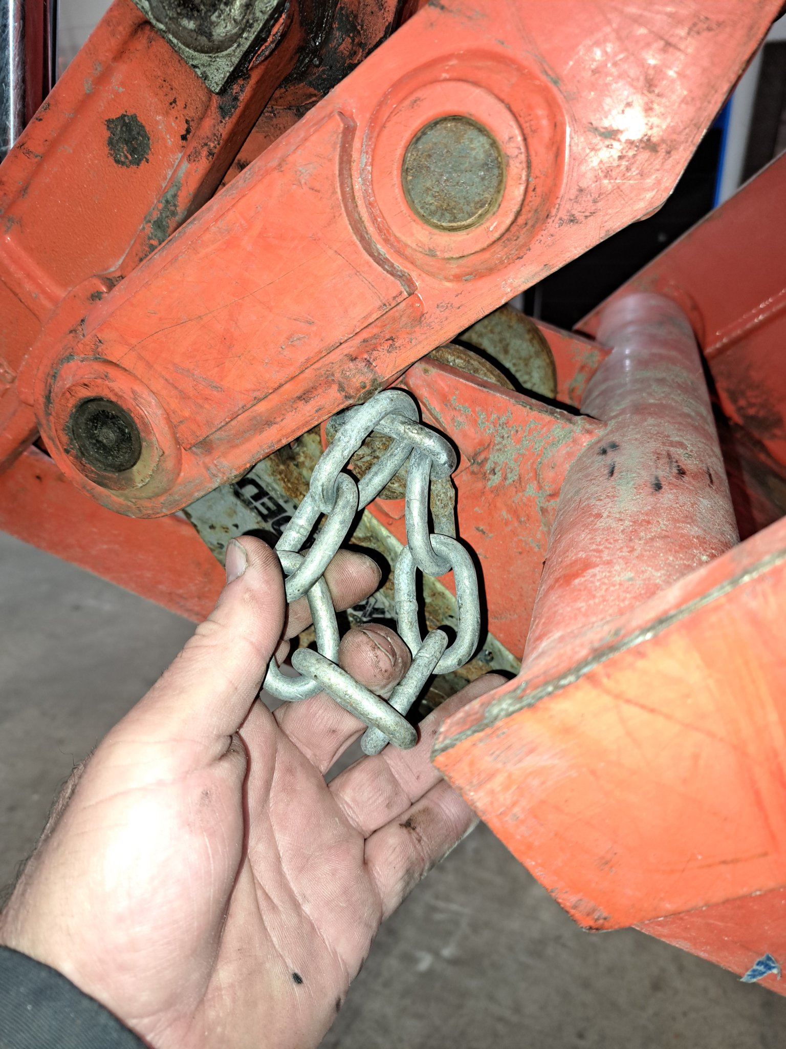

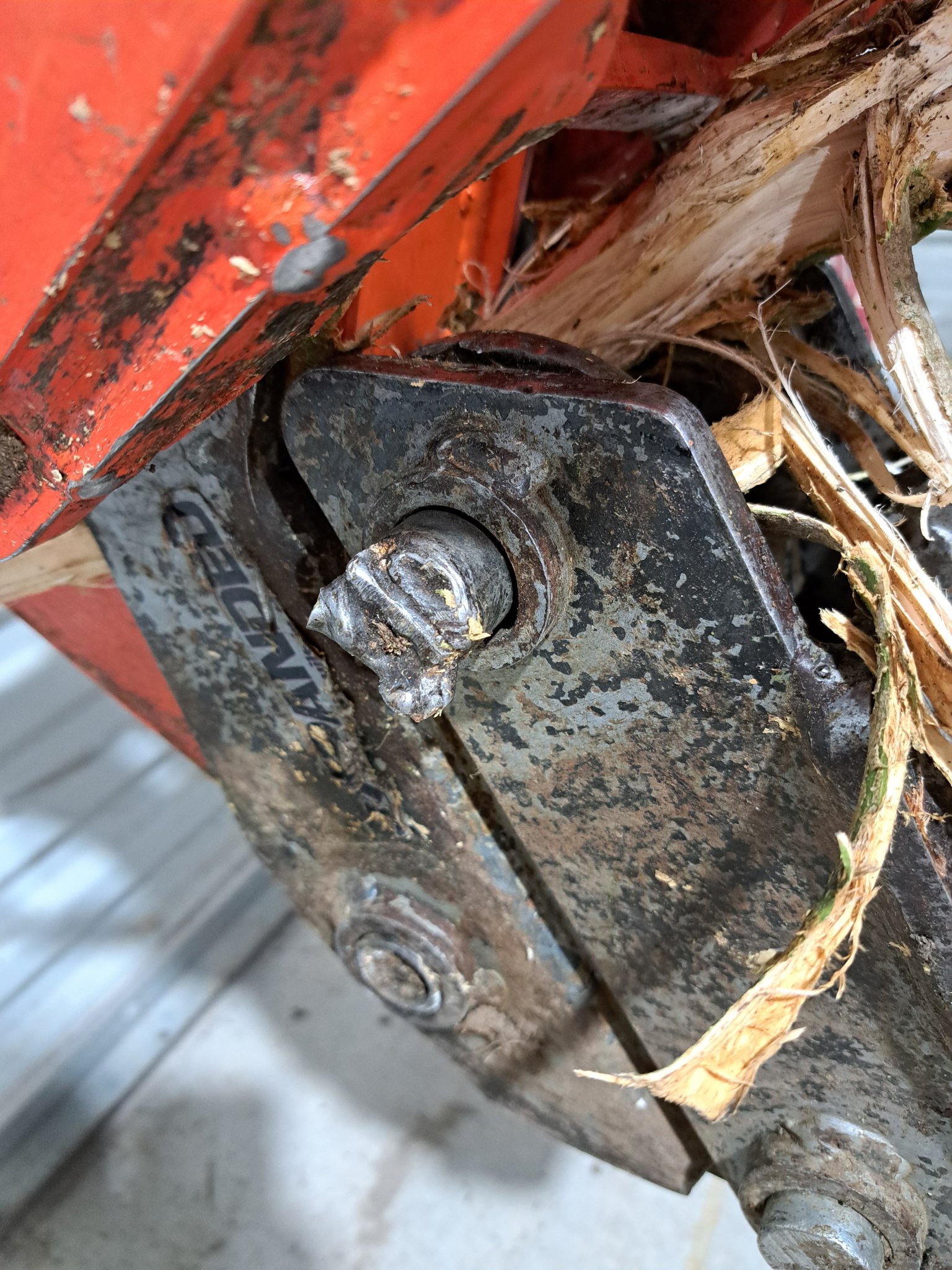

Fried, I think you mean the ripper tooth pin. I have solved that by accidentally finding a lock pin that "snaps" in place . It hasn't failed me yet.
MotherF$$@er !!!!!! I literally just went out to take a picture to show you how I "solved" that problem and found this.
And while bragging about my "Pin Solution", I Just found out that I snapped off my gosh damn "pull chain" that I welded on to remove the pin.
Before.
Now
You might be right Fried, a bolt and lock nut.
KISS
Paul
2,348
2,661
I suppose the good part about my "pull chain" being gone is that it shows that my welds held up.:)
Before.
Now
KISS
Paul
Not to be snotty but, may I say.......I
Before.
Now
KISS
Paul
Not a lock nut, but.....A bolt, with two nuts locked/jammed together.
