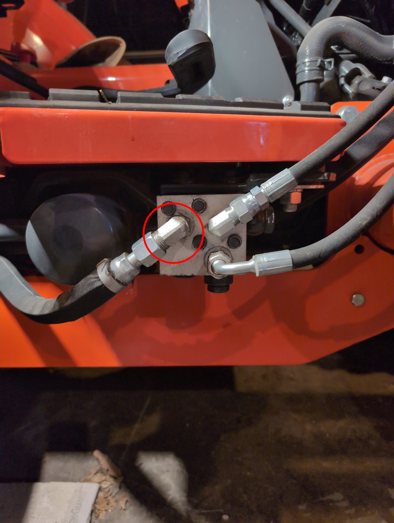

Another question. Lot's of videos identify this as the Power Beyond port. Is this really a P and not a PB port? p or pb.jpg

Another question. Lot's of videos identify this as the Power Beyond port. Is this really a P and not a PB port? View attachment 156668
I'm trying to make sure I understand your image here. View attachment 156669
Power beyond is a horribly misunderstood and missused term. P and PB are really the same thing.
Lets start with the L01/L02 hydraulic outlet block. The upper right port is pump pressure out to auxiliary vslves. The upper right port is pump pressure return from the last auxiliary valve in the chain and it supplies punp pressure to the internal 3pt valve. The bottom port is a low pressure tank return straight to the sump.
The red lines in my diagram designate the order and direction of the neutral circuit flow. Its common to call that power beyond. So PB from an upstream valve is P to the next valve in the neutral circuit chain. This leads to lots of confusion.
The blue lines are low pressure (close to 0 PSI) return paths straight to tank. That path is used to return oil to tank when a valve is shifted and the neutral circuit is blocked. Its also used to return oil to tank when a relief valve opens.

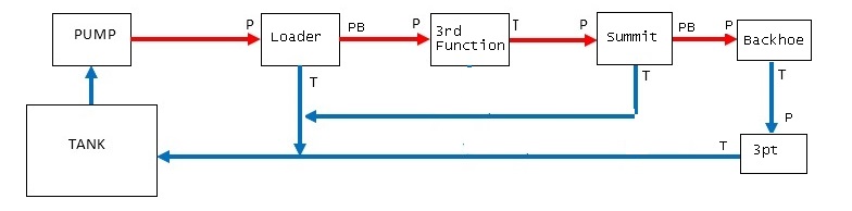

@TheOldHokie
Please refer to the diagram above in post #27 (which I think you had posted somewhere else?)
The question I have is on the need for a PB sleeve in the rear remote and the FEL valve but not in the BH valve or the 3RD function. Basically explain (again) what the PB sleeve does inside the valve and why it is needed in some cases but not in the backhoe valve. I have not found an explanation on why that is OK and am curious about that.

Good question - here is a short but incomplete answer.
In a vanilla valve there are two low pressure tank cores inside the valve which share the same outlet port as the high pressure center (neutral) core. The two tank cores run along the outer walls of the valve and the spools go through both of them. Since thats a low pressure region the external seals on the spools are designed for low pressure operation - somthing in the neighborhood of 500-700 PSI max. Thats fine when the outlet port is going to tank but not when its being used to supply high pressure to another valve.
When the valve is being used for high pressure carry over (aka PB) a sleeve is commonly installed in the outlet section. The sleeve isolates the two tank cores from the center core and you have two outlet ports. One is low pressure return to tank (T) and the other us high pressure carry over (PB) to another valve. There are a number of reasons you want do that but first and foremost is protecting any low pressure seals in the tank cores. If you use the tank port to supply 2500 PSI oil to a downstream valve you risk blowing out the low pressure seals on the spools.
The tank ports on the solenoid operated industrial type valves commonly used for third functions are rated for much higher pressures - typically 3000 PSI or more. So the tank port can double as a high pressure carry over port without risking damage to tbe valve.
Clear as mud?
PS> The reason (most) Kubota backhoes do not need a power beyond port is because when they are mounted the 3pt is disabled. The backhoe is always the LAST external valve in the external loop and the 3pt valve is always in neutral and open to tank. Thats really a poor design. If the operator screws up and raises the 3pt lever or the return coupler fails the tank return gets blocked, tank port pressure shoots up to 2500 PSI, and the BH valve develops expensive leaks....

Thank you for the explanation! It makes sense and my understanding is clearer now!
I was neglecting (unaware) that the three point valve was disabled when using the backhoe. (I knew the three point system was not used but didn’t understand the valve should not be operational.). So that was the nugget of information that cleared up the confusion in my mind.
I appreciate the education!
