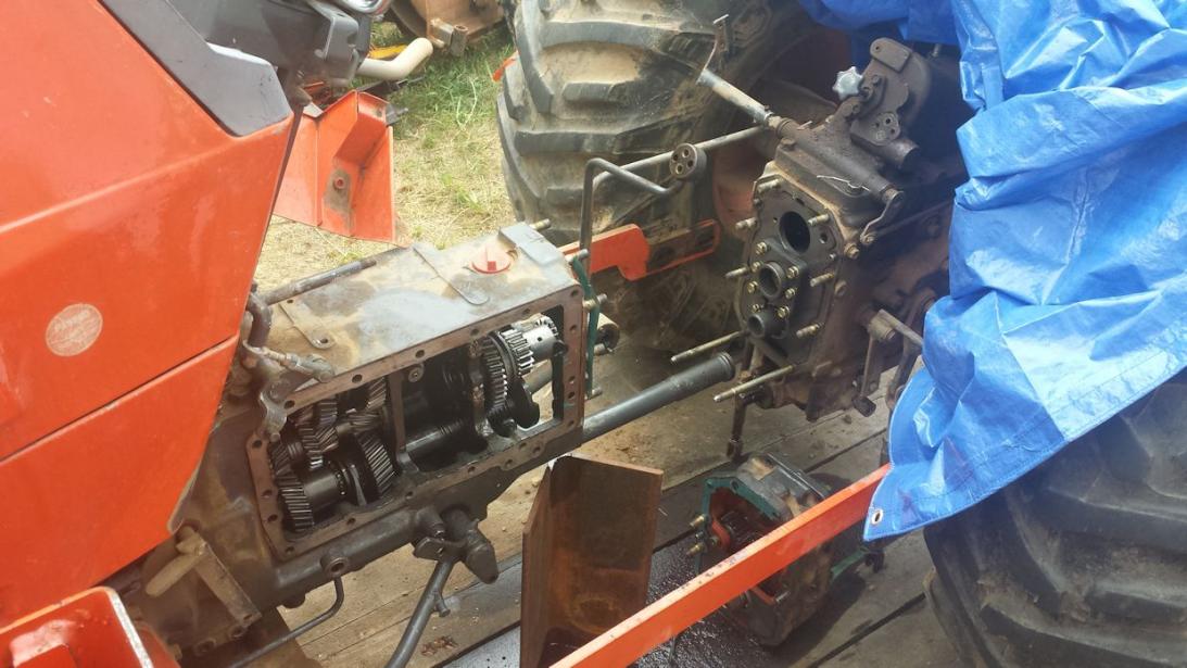

So wrenches started flying and apart it came, just to get to the clutch and check it all out.
Well upon disassembly yep the clutch disks are in perfect condition, spec'ed out as new thickness and they are not worn at all, dove a little deeper and BAM there it was the whole problem all along the piston seal on the hydraulic clutch was all torn up, I'm amazed it has ever moved, literally chucks missing out of it!
Looks like the mechanic put a new clutch pack in it and never even went into the piston.

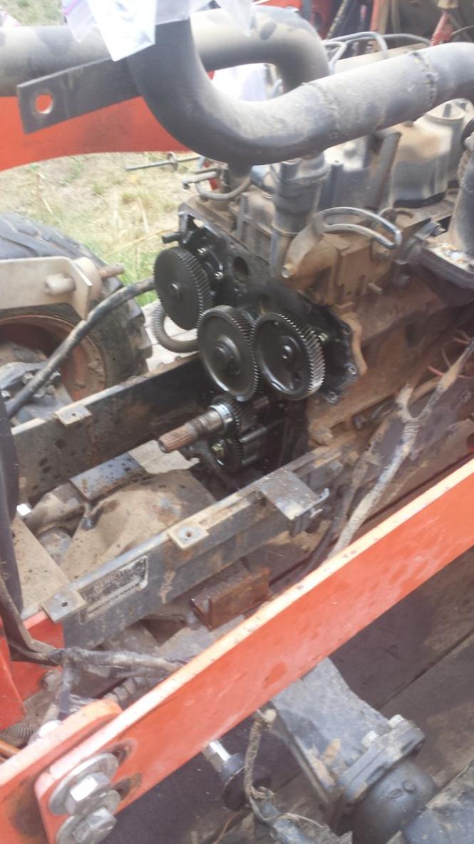

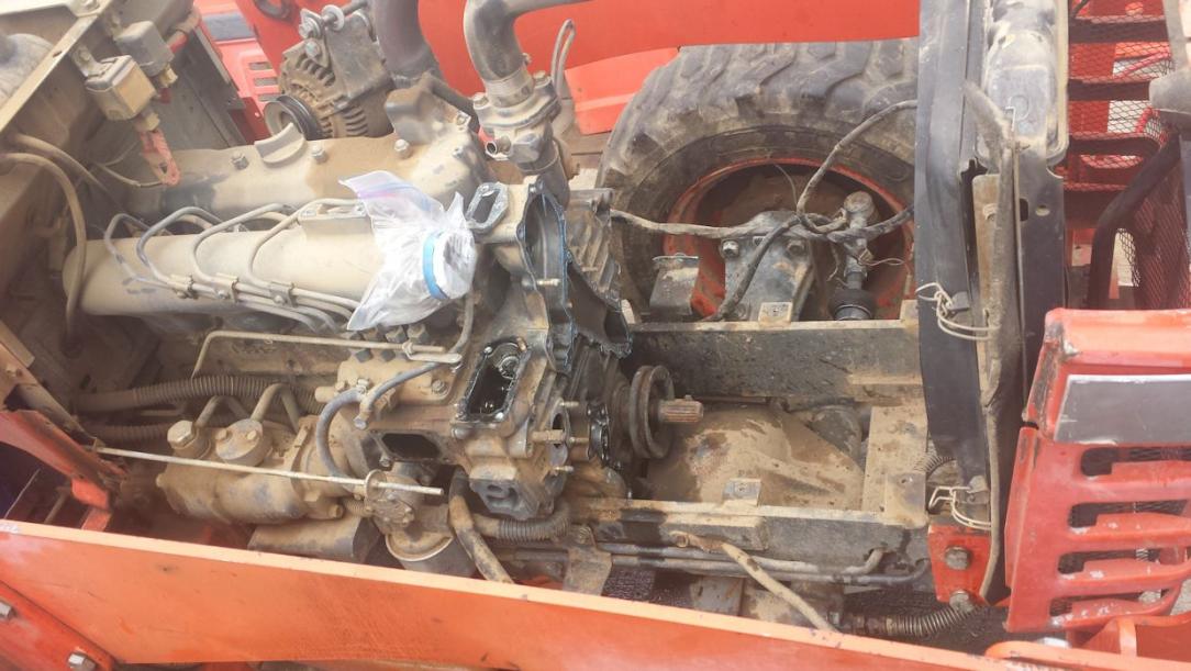

Well I figured while it was down for the tranny I would multi task and replace the front gear case cover on the motor, it was damaged this winter by a cheap rebuild water pump and has been held together with some Epoxy putty. I've had the cover and all the gaskets, parts for a full service, new hoses, block heater and other replacement parts, so good time to do it all.
Poor tractor all tore down!:(
