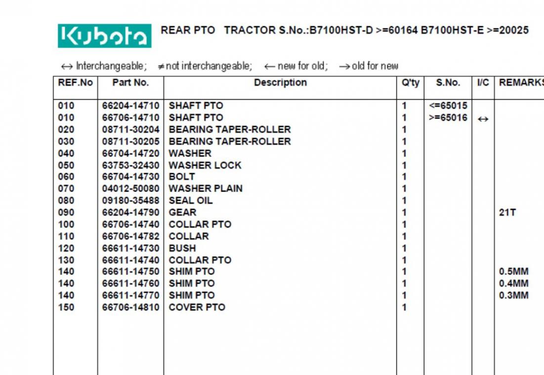

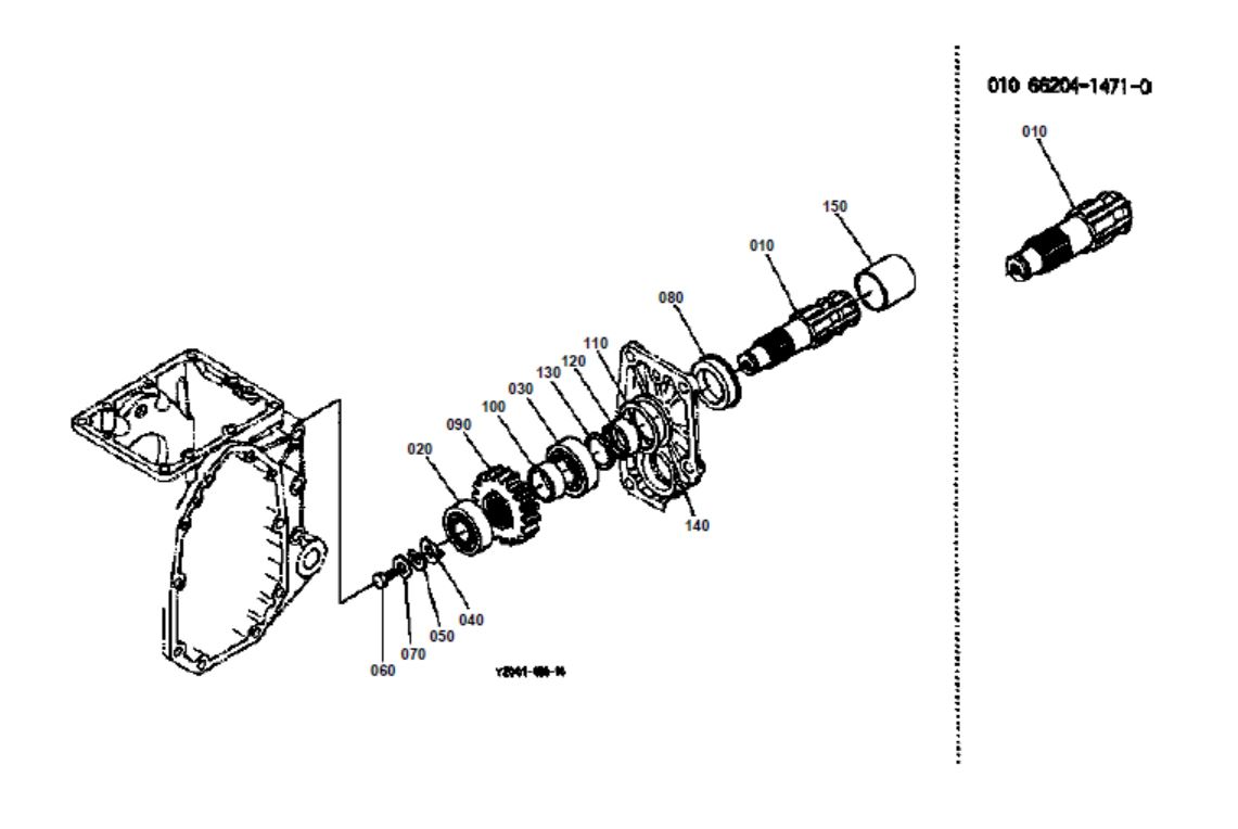

Glad to see you got things sorted out , its like most things mechanical, there is allways a solution one way or another.
I've not read any articles on the your problem , but , i would suspect that it is directly connected to the following.
The B7100 have a one way slip clutch on that shaft, but the 7001 does not an this also applies to other similar variants also.
As mentioned before, on the 7100's etc the slip clutch prevents damage to the pto output shaft and aux shafts connected to it etc, so, in the even of a problem with any pto implement the shaft will simply be disangeged, on 7001 etc it wont and any extrnal forces in the opposite direction will likely cause problems and gear damage, unless of corse you have an external slip device fitted.
i have added a pics of the offending parts just in case someone doesnt have the diagram.
split a 7001 box and then split a 7100 and you'll see the differences.
