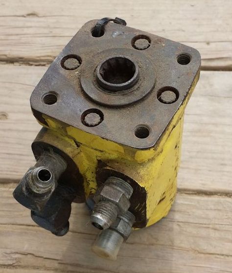

I was going to do that to my B7100.
It's not a cheap deal, but boy is it nice to have hydro steering.
You need to get a unit like this: Just make sure it's an open center type unit.
You can also buy the mount and shaft and steering wheel for fairly cheap too:
Would you have hydro lag if using FEL and steering at the same time while using if your using a 4 port steering box instead of a 5 port?
30,075
6,244
I assume you mean PB capability. No not really, but get the bypass/relief valve and you would have no issues at all.

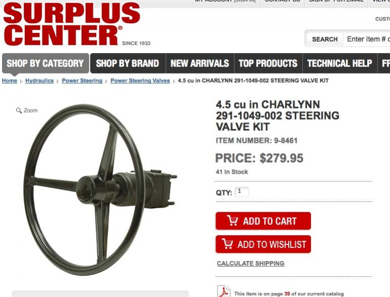

kubotasam
Apr 26, 2010
1,202
128
Alfred Maine
Surplus center has a good price on a unit with the column and steering wheel.
