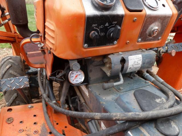

Found a metric adapter and picked up and installed a mechanical oil pressure gauge. Cost of materials was about $20, time to install was about an hour, peace of mind, priceless!
There isn't much space on the dash, so I placed it a little low, and on an angle right next to my "cruise control". The gauge confirms what I found with the other gauges. Oil pressure is right around 50 psi. Stupid idiot light.

I apologize if my questions are dumb, but what is between the mechanical gauge and the engine? That space that used to be covered by the wire between the sender and the light.
When the engine is off can you remove the sensor/gauge without losing fluid?
On mine the electrical contact is torn out from the sender. If I buy a new one with the electrical spade still attached, I'm wondering if it is just unbolt the old and bolt on the new.
But even better would be to have a real mechanical gauge. Then I don't have to guess if the light is working correctly.

A clear palstic tube connects the gauge to the engine block. Yes, you can remove the sender from the block with the engine off without losing any oil. If you install a mechanical gauge, make sure that you protect that tube. You don't want it rubbing on anything or getting snagged by anything ----
Thanks Bruce, did the tube come with gauge? The Gauge includes the sender that bolts to the engine, the tube, and then the dial indicator you mount under/near the dash to read the pressure?
