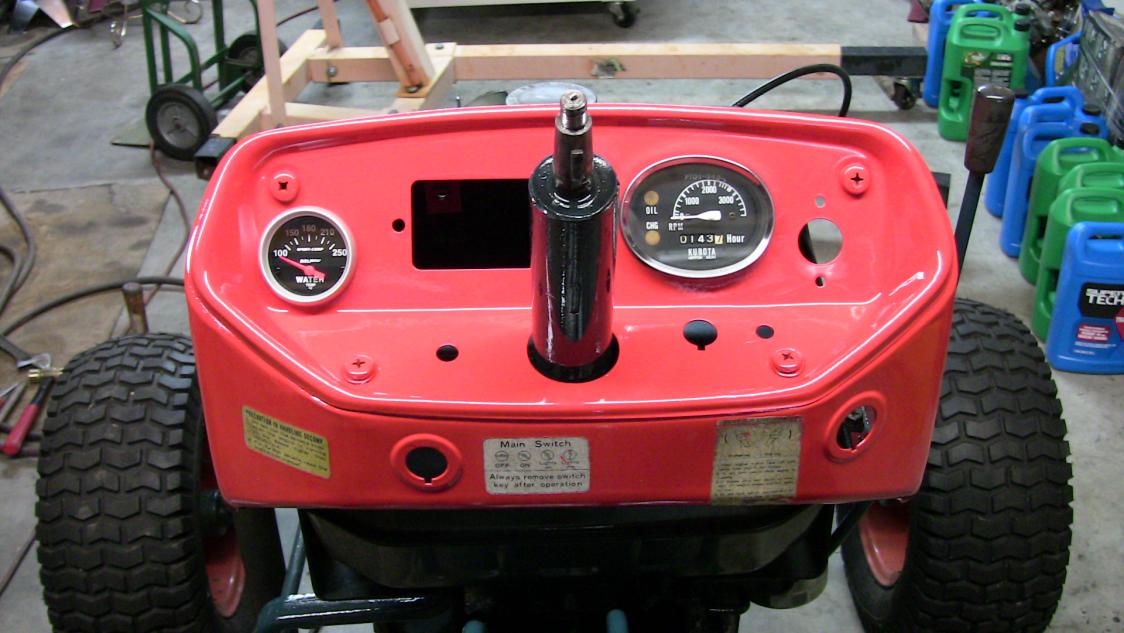

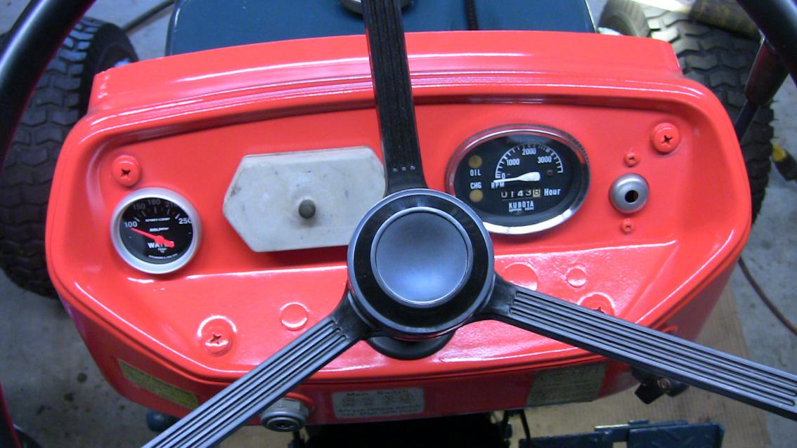

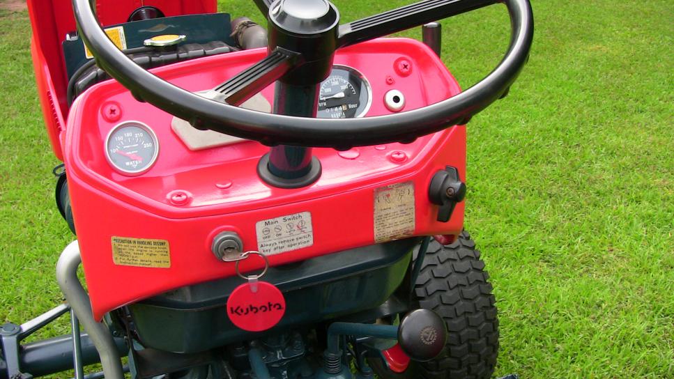

If you want to see temps the best thing to do is install an electric temp guage kit. I put this one on my L175 when I built the engine back and I love seeing my temps. :D
The sender is mounted beside the upper radiator hose neck on the cylinder head to get the hotest temp readings.

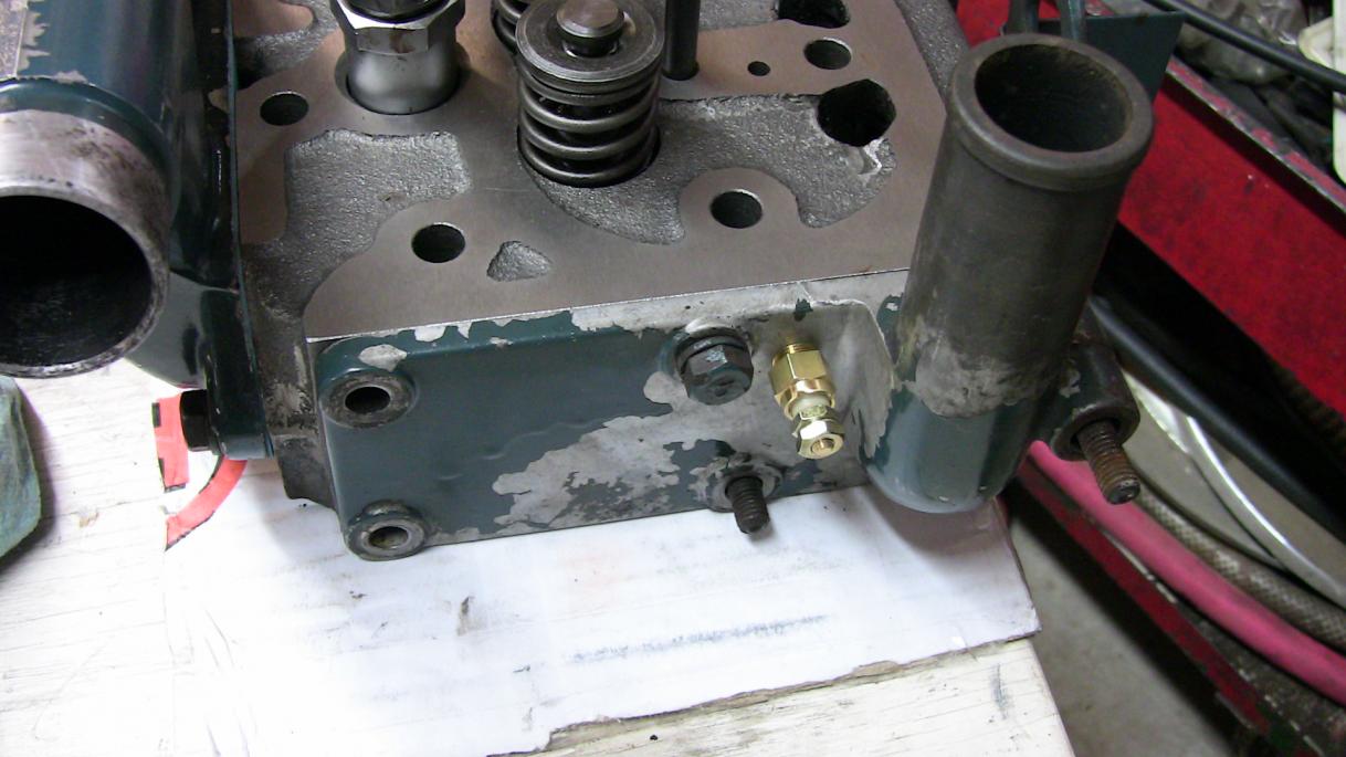

No, there was not any provision for this in the tractor. The second pic shows where I drilled and pipe thread tapped a hole for the sender so it would read in the head near the point the water would exit and possibly show the hottest reading.
