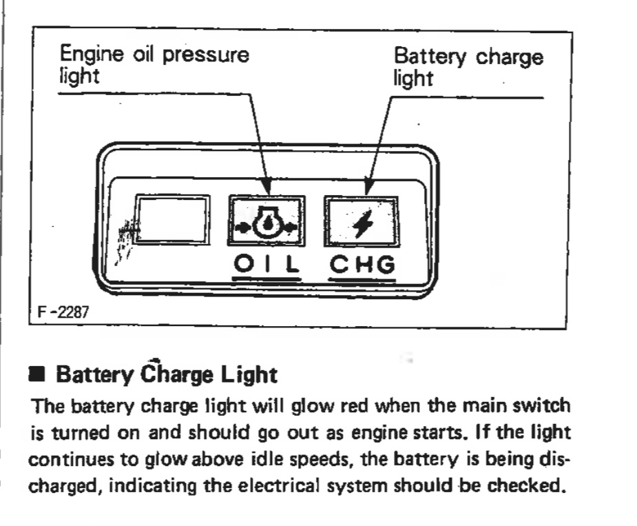

The operators manual says "if the light continues to glow above idle speeds...".
I think this suggests that it is normal what you are seeing. The work shop manual may have more detailed information but I could not find that for download.
