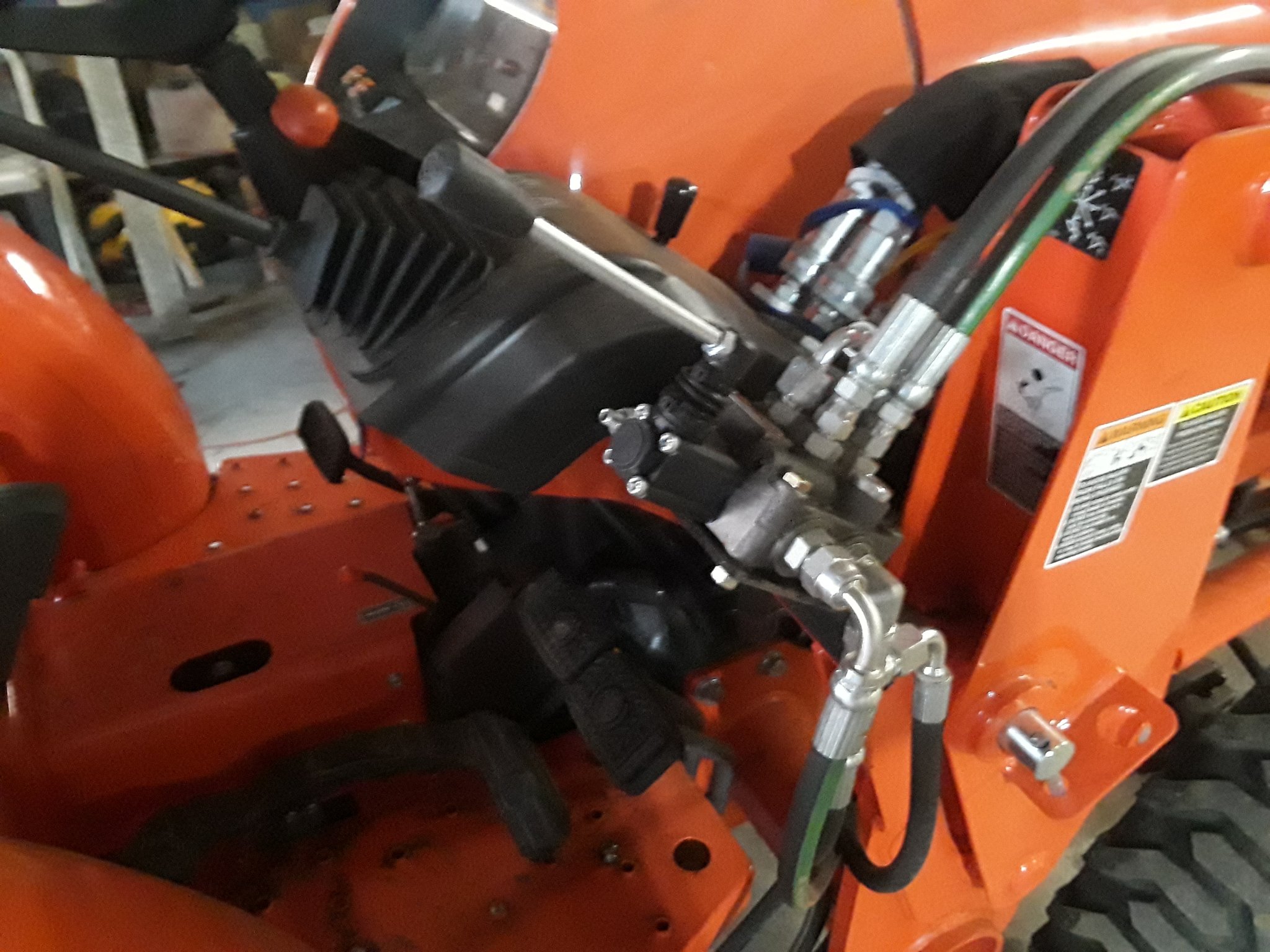

You can easily add an inexpensive aftermarket valve.
Hardest part is deciding where you want to place it. Then its just a matter of hooking it into the loader power beyond circuit (3 hoses) and running two more to the rear for your outlets.
Here is one added next to the loader vslve.

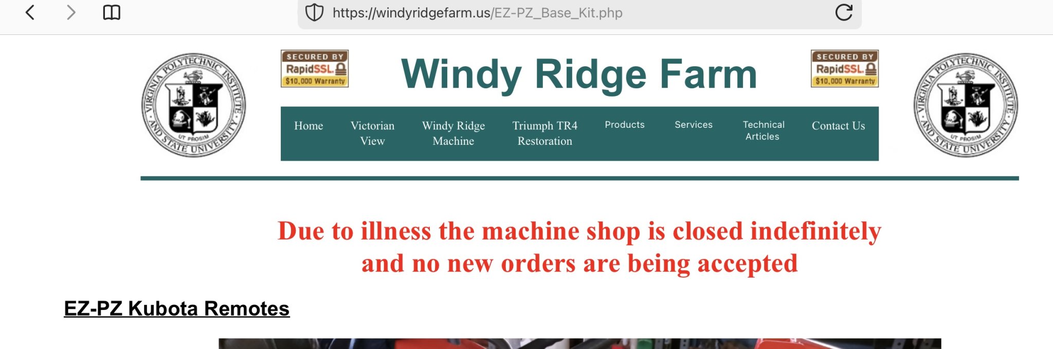

For that tractor and loader its an inexpensive piece of cake. This bracket is designed to fit the current Standard L with LA52x loader but modifying it to work on an LA402 should be just about trivial.
5,847
3,046
Great option, but it looks like the owner of the web site has health issues and is not accepting orders....
8,941
4,711
I must have got the wrong impression from the text in red. I figured you posted a link and was unaware of the owner’s situation…
No you got the right impression. That was put up when I first got out of the hospital and I thought my demise was imminent. I need to edit that back a bit. I am not taking on anything mahor but will consider amall jobs like the remotes that are easy to assemble.
