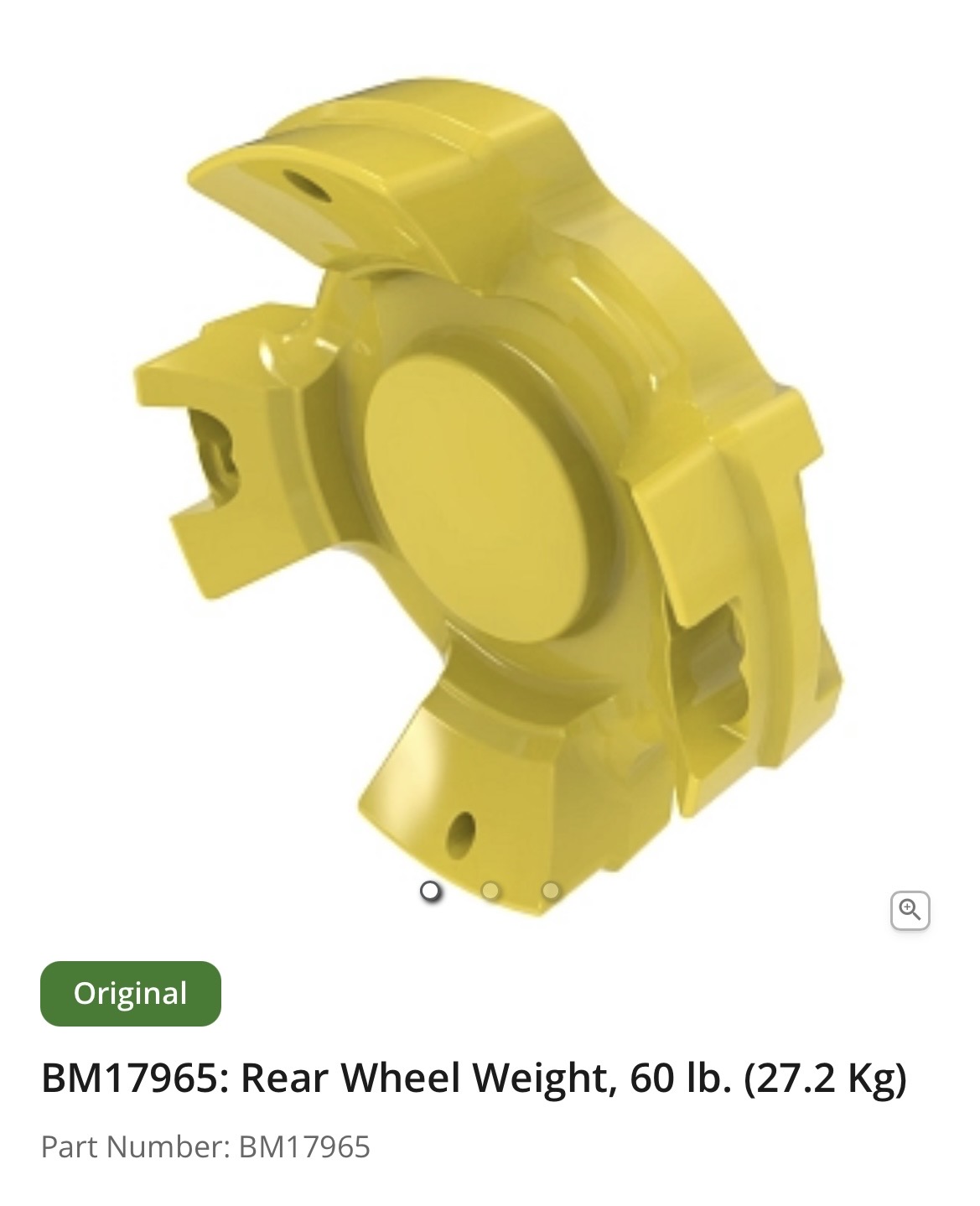

Has anyone installed rear wheel weights on a Kubota B7500? What works? The best option I’ve found locally (to avoid shipping) that I believe will work are the BM17965 from John Deere. I would obviously need to paint them orange. 😄 Has anyone tried these? Thanks

No, and don't believe anyone makes rear wheel weights for your 7500.

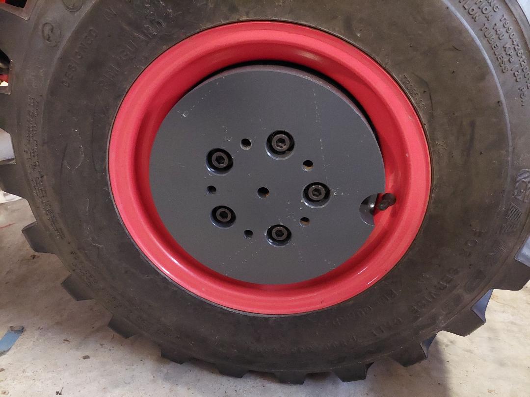

If you have access to material and a lathe, why not roll your own? These are on my BX for comparison.
If diameter is prohibitive, you could also burn out rounds and laminate together to whatever thickness (weight) you desire. That option would make install/removal job easier as you wouldn't be handling as much weight all at once.

Ping, I don’t have access to a lathe. I’m just looking for a reasonable commercial option.
You can buy discs laser cut to size. All you have to do then is drill a few holes and bolt everything together. And I like @Ping s idea of handling smaller weights.

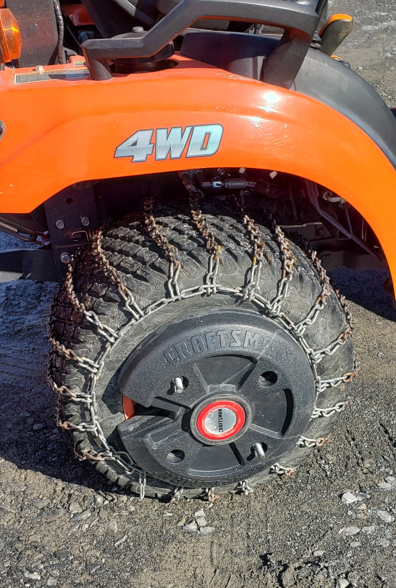

I used a set from an old Craftsman lawn tractor my BX replaced, fit perfectly. Measure your rims, there may be options out there.
Russell King seems to have a good idea there depending on price.
Chains & Weights - Rear.jpg Good luck!!!
