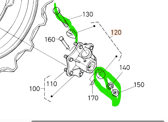

Is back and forth in and out as in pushing the tire towards the tractor and pulling it away? Or are saying that you can roll the tire forward and backwards as in driving the tractor forward/backwards?

Does it make noises while driving? You should be able to see / feel the movement. Mine had loose bolts where the hub fastened to the axle. They were tapered bolts that made the hub tight on the hex axle.
