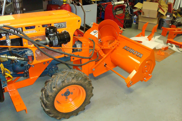

John, what's all that iron in the background?
A few years ago, I decided to powder coat my snow blower. In the process, the powder coater said it was costly to change colors in his booth, so I should do all I wanted in one shot. So, I took my snow blower, tiller, FEL and dozer apart, had all of the pieces sand blasted and powder coated. Here are some before and after pictures of the tiller and snow blower:

That is very nice, it looks better than new! I love these old tractors and how advanced they were for their time. At the same time they are built to be able to repair anything with a few hand tools.
