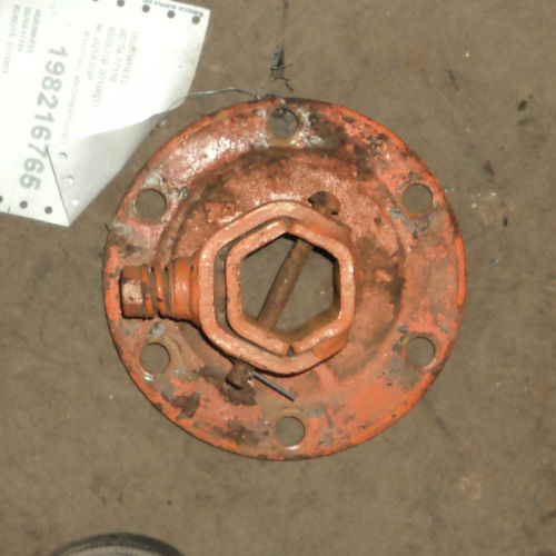

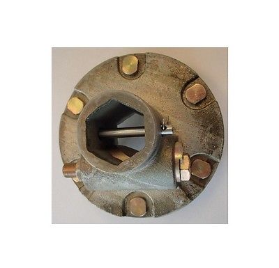

This is what your hub should look like. the bolt should be tight, and the pin in place.
Dan_R_42
B7100-D, w/ Sims Cab, B219 FEL, ARPS 70 Backhoe, Oversized R4 Tires, LX2610 Cab
Dec 1, 2010
447
Taunton, MA
The photo that Bronco posted (1st photo below) is what the new, after market replacement hubs look like. They work great.
The second picture I posted below is what the Kubota original hubs look like. That is what you should find on your tractor now. Even if you bought new bolts, springs and pins from Kubota for your existing hubs, I doubt they would stay tight for long. Especially after your hub centers are egg shaped and worn by now. I bought new hardware years ago and it did not work. It was a waste of $$.
NO they should not be wobbling and creaking around - they need to be tight. The original hubs are terrible and never seem to stay tight. You could search ebay to find replacement hubs if you have the funds. They look like the first photo.

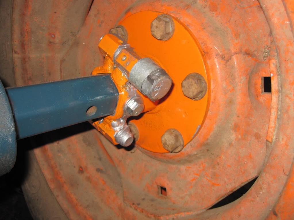

If you are handy at welding you could do the mod that Piker did to his hubs years ago. I could not find the link to his mod, but photo 3 is Piker's hub mod.
This might be the link for Piker:
http://www.orangetractortalks.com/forums/showthread.php?t=3209&highlight=b7100+rear+hubs&page=2

The pic of the hub I posted is standard equipment for the B7200. If you have the older type hub, then someone has swapped it from an older tractor.
Bronco, sorry my bad. Guess I should have been wearing my glasses when I read the post. I'm sure I was seeing B7100 when I answered the question about the B7200 rear wheel question. :D
Good point though. I wonder if the early model B7200's went out the door with the older style hubs ?
That's always a possibility Dan, and I'm not sure of the year that Kubota started using the newer type hubs on the B7100. The first build year of the B7200 is 1984 (according to tractordata.com), and the parts manual I have only shows one style of hub(the new type). But the hubs could have been swapped by the previous owners.

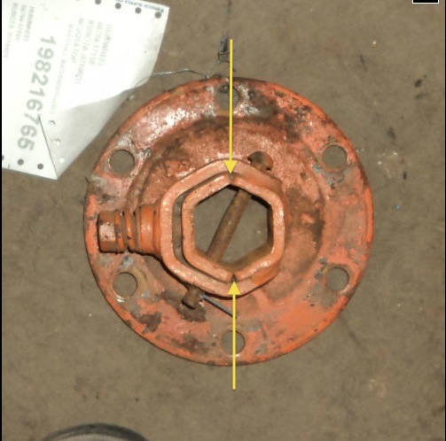

The hub pictured above is the same design as on my B7100, which had wobbly wheel syndrome when I got it. The point where the two halves of the hex shaped clamp meet had no clearance, in other words they bottomed against each other before clamping on the axle shaft. It was a simple matter to cut more clearance in this area, (yellow arrows in pic below) then I replaced the pin with a tight fitting bolt, either 12mm or 7/16", I don't remember which, and the hubs are tight.
I agree with you 100%. I had the same issue. I also noticed that the big torque bolt did not seem to be long enough. I bought all new springs, bolts and locking pins. Without cutting off some of the spring (which I would not do) the bolt would bottom out on the fully compressed spring and not be tight on the hub clamp.
For that reason I did not ever try to cut additional clearance in the hub clamp and just got 2 new style hubs off ebay. Maybe I should take another look at the old hubs to see if I missed something. Guess it would not be bad to have a spare set of hubs. :D
I felt the same way, so I left the springs off all together. (thanks for refreshing my memory) A couple drops of Loctite 242 and they have remained tight.
I would guess the springs were designed to keep the torque bolt from backing off, but seems to me that they would not have 1/100th of the force necessary to stop that bolt from turning. Probably looked good on paper in the '70s & '80s.
LOL... I have always questioned the logic of that entire hub design. It never looked right and it plain did not work. I guess back in the early Kubota days it must of made sense to some engineer.
Good idea- no springs & some loctite. If I do mod the old hubs with the clearance, that is the route I will go. Thanks for the idea.
