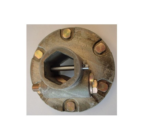

Did Kubota ever upgrade the B7100 hubs to the newer design before ending production in 1997?
http://www.ebay.com/itm/New-Kubota-...=BI_Heavy_Equipment_Parts&hash=item3ccbd743a7
Knock yourself out, it's your $300.
I drilled mine out to 6 on 4.5 , I used 1/2" bolts with the head tack welded to the hub with regular lug nuts.
When shaft or hub is worn the correct repair is to built up with weld and then mill to shape and size........IOWs they can always be repaired.

My 7100 has a sort of clam shell clamp. I take it these are problematic? Mine seem to be ok, is there anything I should check?
