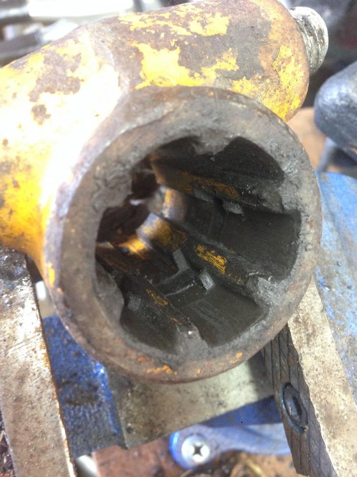

I own an early B7100 (sold in 1977) that lacks a integrate overrun clutch. I recently purchased a clutch but I am having trouble making it work on my application. The problem I am having is on the male end of the clutch, the groove for the retainer bolt is in a different location. On my tractor the groove is approximately 5/8" from the end of the shaft, on the clutch the groove is approximately 1 1/8" from the end. On my brush mower the yoke does not have enough depth on the female end that connects to the tractor to reach the retainer groove on the clutch. You will see in the attached pictures that the yoke on the PTO shaft has stops that prevent the male end of the clutch from going deep enough to insert the retainer bolt. Have I purchased the wrong clutch or is there some way I could make it work?

Before he grinds out the stops, he needs to make sure the mail stub will not hit the Ujoint, that is why the stops are there.
If you look at the original pictures I posted you can see the overall length of the yoke. The front edge of the retainer groove on the male end of the clutch shaft is 1 1/8" back. From my view it looks like the shaft would be maybe 1/8" beyond the female end of the yoke which doesn't look like it would cause a problem. Anyone see it differently?

I wonder if what you are seeing as stops is a build up of dirt, rust , crud ect and the yoke just needs to be cleaned out real good. From your last picture is sure looks like a normal one. Or it could be the end that has been used is worn for an easy fit and further down inside is just a tight fit.

I cleaned it up a little and took another picture, there are definitely stops in the yoke. The other thing I noticed is that the splines widen just beyond the stops, you should be able to see that in the picture also. It looks like the change in the spline width beyond the stops will prevent the yoke from working.

I think it more of a case of the yoke being worn before the stops!
But save any abuse and get a new yoke, If you have trouble finding one I can get you one quick, our local big R store as several in stock.
30,963
6,963
I agree with lsmurphy,
The valleys and ridges on a PTO shaft are the same size, So the back of the yoke is good and the front of the yoke is worn way out of spec.
That's why it looks like there are stops on it, the "stops" are just non wear spots where the shaft slot hits the inside of the yoke.

I agree. I also think it is just wear on the splines. You might be able to smooth the transition from the worn to the not worn with a file and get away with using it for a while. However I think it is time for a new yoke. Measure the universal joint carefully, there are many different sizes.
