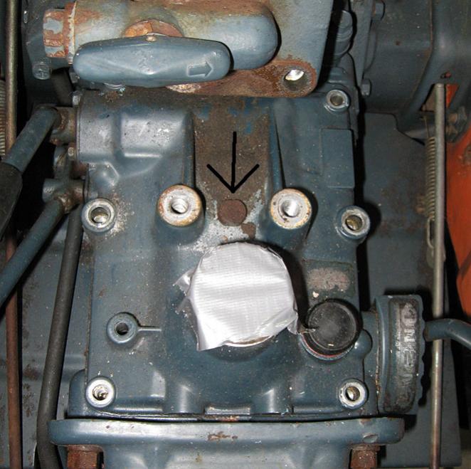

So I'm to the point where I'm ready to pull the transmission cover to inspect the internals. I cant' seem to get the cover off. I've searched but couldn't find anything. The WSM doesn't get into the specifics. I tried using the chain hoist to pull it off but the ropes keep breaking. Only bolt I didn't remove is the check plate bolt (black arrow). I don't think this needs to be removed.
Any tips on how to get this darn thing off are appreciated!

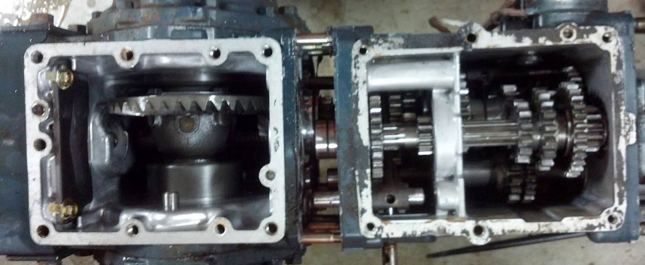

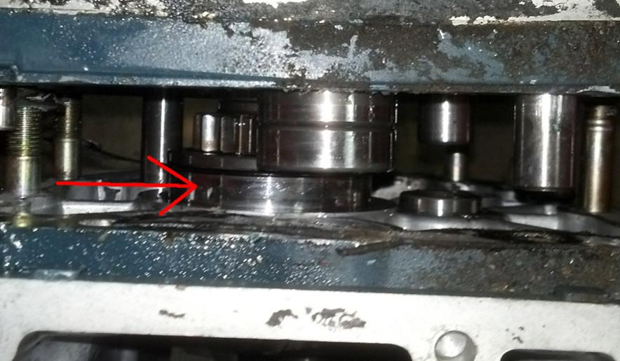

Ok, it came off with some muscle. Naturally a piece of the case broke off at the alignment dowel pin location. I'm sure even after I put a new gasket on it's going to leak there.
I discovered my issue. The gear that engages/disengages 4x4 is all marred up for some strange reason. When in 4x4 the shiftier shoe doesn't catch any of the marring, but when shifted to 2x4 it does. That's what was binding up the drivetrain. Although nothing is broken, I still have to take the transmission apart and replace that gear and shifter shoe. I still have no freaking clue how this happened.

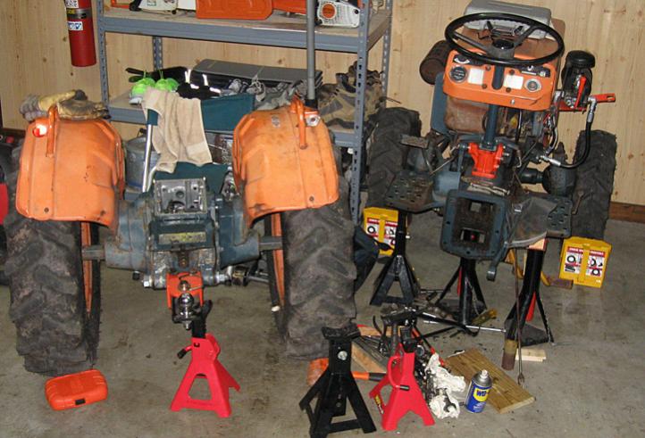

So I'm at the point where I'm ready to remove the gearbox from the rear-end. It won't separate. It appears that the pinion bearing is suck in the rear end housing. Anyone have tricks or tips for getting this out?

Ok, got it off. Here the PTO coupler was hanging it up.
So this must have happened over a long period of time. Only thing I can think caused it was someone resting their boot on the 4x4 lever repeatedly. The shifter shoe wore down and welded itself to the gear. Then it got all rough and the shoe would get caught on the gear and bind the entire drivetrain up. No metal in the bottom of the transmission case. Good thing for the used parts market because Mesicks wants $275 for that gear!

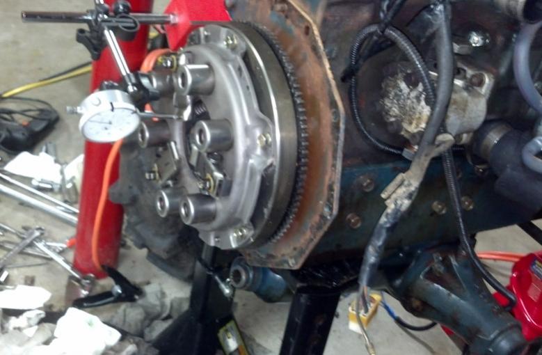

Transmission is back together and everything is working as it should. I figured since I had the tractor split, I'd do some other maintenance to it. It needs a new throwout bearing - the old one is really noisy even though it has plenty of grease in it. I need to raise the fingers on the pressure plate, I ran out out clutch adjustment and it doesn't want to disengage 100%.

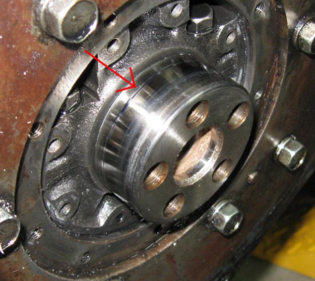

So I go to remove the clutch housing from the engine and a sizable puddle of oil pours out. The entire clutch assy is coated in oil. I figured the rear-main seal is shot. Turns out the crank has a nice groove cut in it where the seal sits on.
It appears Kubota makes a sleeve for the B7100 crank. PN# 19215-23280. The problem for me is that it is only good for ESN's above 188652, which mine is not. Anyone have any experience with a Speedi Sleeve? I'm guessing that's the route it should take? Also, has anyone every had any luck cleaning oil off a clutch disk?

Thanks for the reply Frank. I've been reading the tutorials online on how to properly install them. Got to take three measurements of the crank diameter and average them..etc. Already got some bearing loctite on order. Looks like it should work well though.

The crank looks fine, I don't thing that's a wear grove, it looks to be the normal machining surface, the seal rides behind that.
Now for the seal, buy genuine Kubota seal and gaskets, there is one seal and 2 gaskets, one paper one copper.
Four parts to replace the Throw-out bearing, the pilot bearing, pressure plate and clutch disk.
Replace all at once or you'll regret it. ;)

If you just install the new rear seal about 3/16" further into the seal retainer the seal will ride on a new area. We do it all the time.

Lance, that is such a great idea! I never even though of that. Thanks for this tip! This will work out good since a speedi-sleeve doesn't exist for the oddball diameter of the crank (2.480'').

Slowly getting the tractor back together. New rear main is in. New clutch disk is in. It took me a while, but I finally got the clutch adjusted to my liking by bringing the pressure plate fingers up, which according to the manual I have it set out of spec. The pedal has a nice short throw now. Unlike before it caught at the end of the pedal travel.
