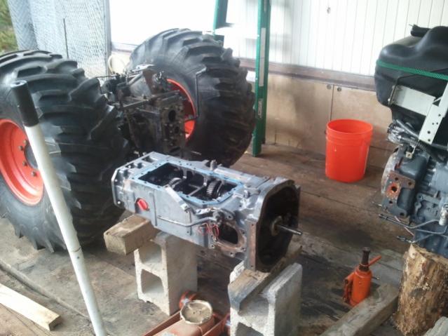

I must say, working on a tractor is a lot easier than a car. Most things have a lot more room to work and you don't have to remove five things to get at the one you want.
You clearly have not dove into the tractor repair pool on the deep end! :p
All of this for one D-ring seal. :eek:
