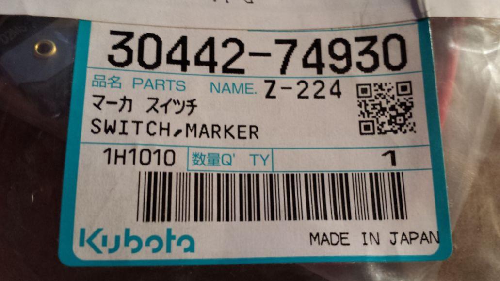

If you bought from where I think you bought from, they are fibbing on the injectors being "factory", they are aftermarket remanufactured units, There is several sellers selling the same injectors and one is claiming they are factory injectors. They will not match the specs of true factory injectors.
One way to tell is it's a true factory part it will be in a sealed plastic bag and will have a label like this, and even newer high dollar parts will have a holographic label:
