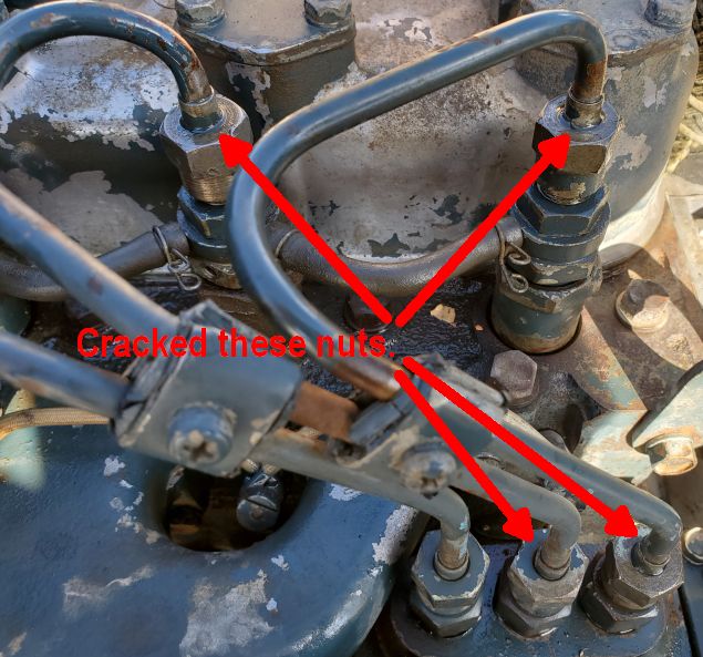

With engine running at idle or even 1/3 throttle, I crack the nuts on cyl 1, 2 and 3 on each injector's back side (see picture). When cracking 1 and 3 nuts 1/8th turn, the engine immediately drops in RPM and fuel comes from the nut's backside and threads. I tighten the nuts back and the RPM resumes its previous speed.
When cracking #2 injector, there is NO change in engine RPM :mad: although fuel comes from the nut's threads and backside. From y'alls comments, I'm assuming the mechanical pump is okay for #2 but...
...guess I need to remove #2 injector and clean with compressed air or disassemble? I don't have any means of checking the line pressures (~1000psi?) coming from the injector pump.
I did listen to all 3 injectors with a screwdriver to my ear, and all injectors are clicking away with the same intensity.
Soooo - clean #2 injector??? :confused:

Remove the #2 injector, take it apart be mindful of the direction of every component, clean with brake parts cleaner, Pull injector 1 look for the compression ring in both #2 and #1 swap with cylinder 2 then put injector #2 in cylinder 1.
Repeat test.
If it fails on 1, bad injector, if it fails on 2, might be time for a engine rebuild.
If the injector fails, pull all three send them to Oregon Fuel Injection and have them replaced/rebuilt.
