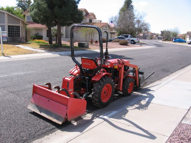

Morgan44
Jul 7, 2013
38
Walton KY USA
Is that a 4' box? What brand is that? I have turf tires so I think my tires are a little wider than yours, but that looks great. That's just my style, nice and clean.
With turfs you sure ain't pull'n no 5' box anyway.
The box is a store brand of a local dealer.........don't know the name.
