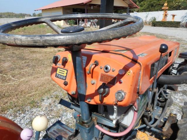

Glad to hear you've got your problem fixed. Mine is hard to start which I suspect is a fuel flow problem. I don't have the indicator light for the glow plugs just a hole in the dash.
30,285
6,444
That "hole in the dash" is the glow plug indicator, in the hole will be a single loop of wire that will glow red hot when the glow plugs are heated and are up to temp, on that tractor about 30 seconds of glow heating should make it work.
And to heat the glow plugs turn the key backwards.;)
