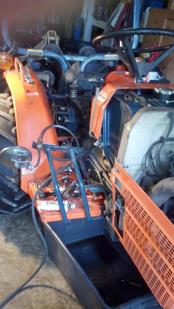

Here's what I've learned. Pulling out the steering box was a piece of cake. Pop off the steering wheel, unbolt the dash, document and disconnect a couple wire connections and tach cable, remove fuel line from fuel filter and drain and remove fuel tank. 4 bolts and you have the steering box off the frame. Remembering that I broke off the sector shaft at the steering box. Once the steering box is off the tractor drain the gear oil, remove the adjusting screw locking nut from the cover plate, unbolt cover plate, turn IN adjusting screw to remove cover plate. Turn steering wheel shaft and note sector shaft gear alignment in relationship to ball nut comp. Turn steering wheel shaft to align sector shaft to be pulled from steering box. Push or pull it out. Reverse it all to put it all back together and don't forget to refill the gear box. Might also be a great time to replace that fuel line from the bottom of the tank to the fuel filter too. My problem has been removing the snapped off section of sector shaft still stuck in the pitman arm. I tried to remove it while the pitman is still attached to the tractor. I'll try to remove the pitman and if that fails I'll try to remove the drag link and pitman as one to try and pound out the broken sector shaft.

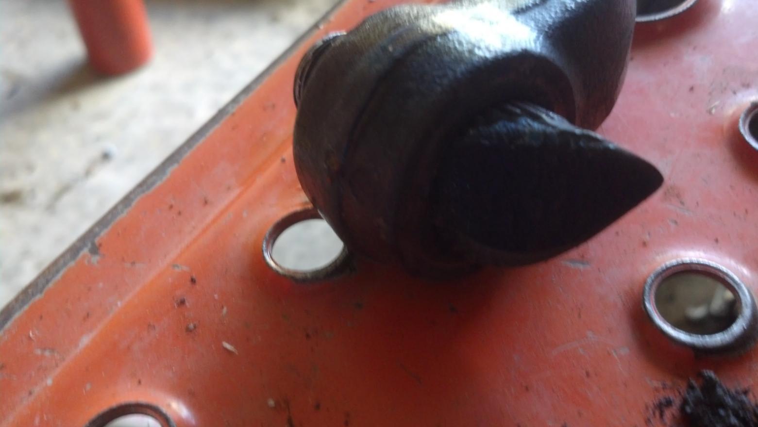

OK, went to work Monday thinking about how to solve the pitman arm problem. The answer was simple. Use the drag link against the pitman arm to get it off. Swing the drag link over the front tire. Move the pitman arm so it parallel and over top of the drag link. 3 easy whacks with a framing hammer near the top of the pitman and it popped off.Took the pitman with the broken sector shaft still stuck in it to a block of wood with a hole drilled in it large enough to accept the broken sector shaft. A couple of good whacks with a 3lbs sledge hammer and it popped right out. Reassembled the steering assembly and test drove the tractor. I did readjust the position of the steering wheel several times before I bolted it down. Now at least I can drive the tractor and use the finish mower. I ordered new lift piston seals for the 3ph. I hope to have them by Friday. Updates to follow...
