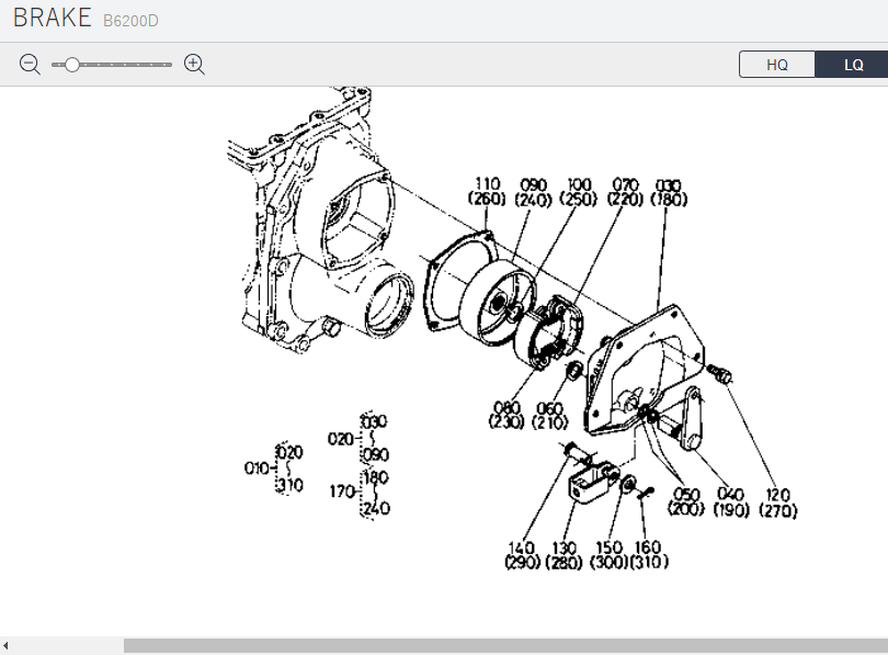

Hi everyone, I have just purchased a B6200D, on inspection the left rear brake was not working, the seller told me it needed adjustment! Thinking it may be only need brake pads replacement, I went through with the purchase. After further inspection I have discovered that the brake shaft was broken, the pads and drum had welded together with rust, I guess someone drove it and sheared the brake shaft. My question now is how do I replace the broken shaft?? Thanks

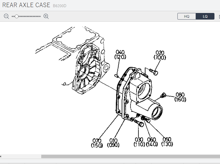

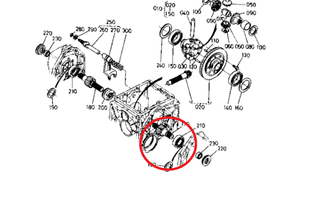

Its relatively easy. You have to remove the axle case from the center section and replace the differential shaft. Do the seals and sleeve (220 and 230) while you are in there.

You would first disassemble the brakes,
Then remove the rear axle case

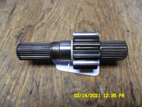

then you'll get to the shaft:

Thank you very much that is very helpful, just hope I can get the right shaft before I tear into it.
