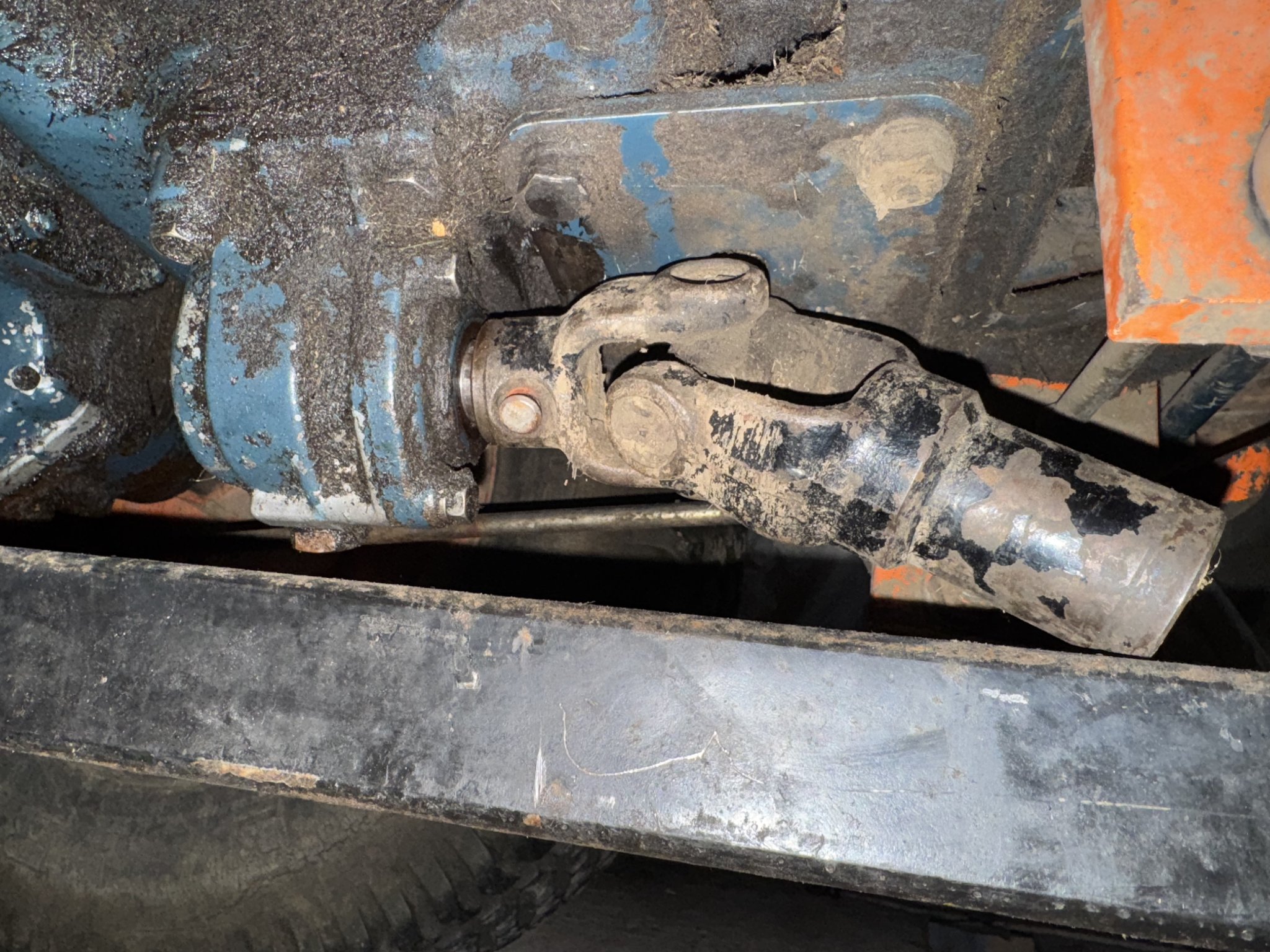

Where it all falls apart is driving the blower, as I do not have the PTO assembly. The blower connects to the subframe, and the subframe should connect to the mid-PTO. I'm just in way over my head at what I'm even looking at with the PTO stuff.
What (I think) I know:
- The mid-PTO is a 31/32" 10 spline (or 25mm), and could be adapted to a standard 1-3/8" 6 spline with an adapter like this. Or this yoke attached directly.
- The mid-PTO is the older style of clevis pin and split pin, not a push pin.
- The yoke(?) from the mower is still on the driveshaft and I think should be removed and kept with the mower, unless it's useful somehow in the attachment of the blower.
- I have to span about 55" from the mid-PTO to the front of the subframe, with little clearance near the mid-PTO. There would be no expansion or contraction in the shaft as the subframe is rigidly mounted, any movement happens between the subframe and the blower itself.

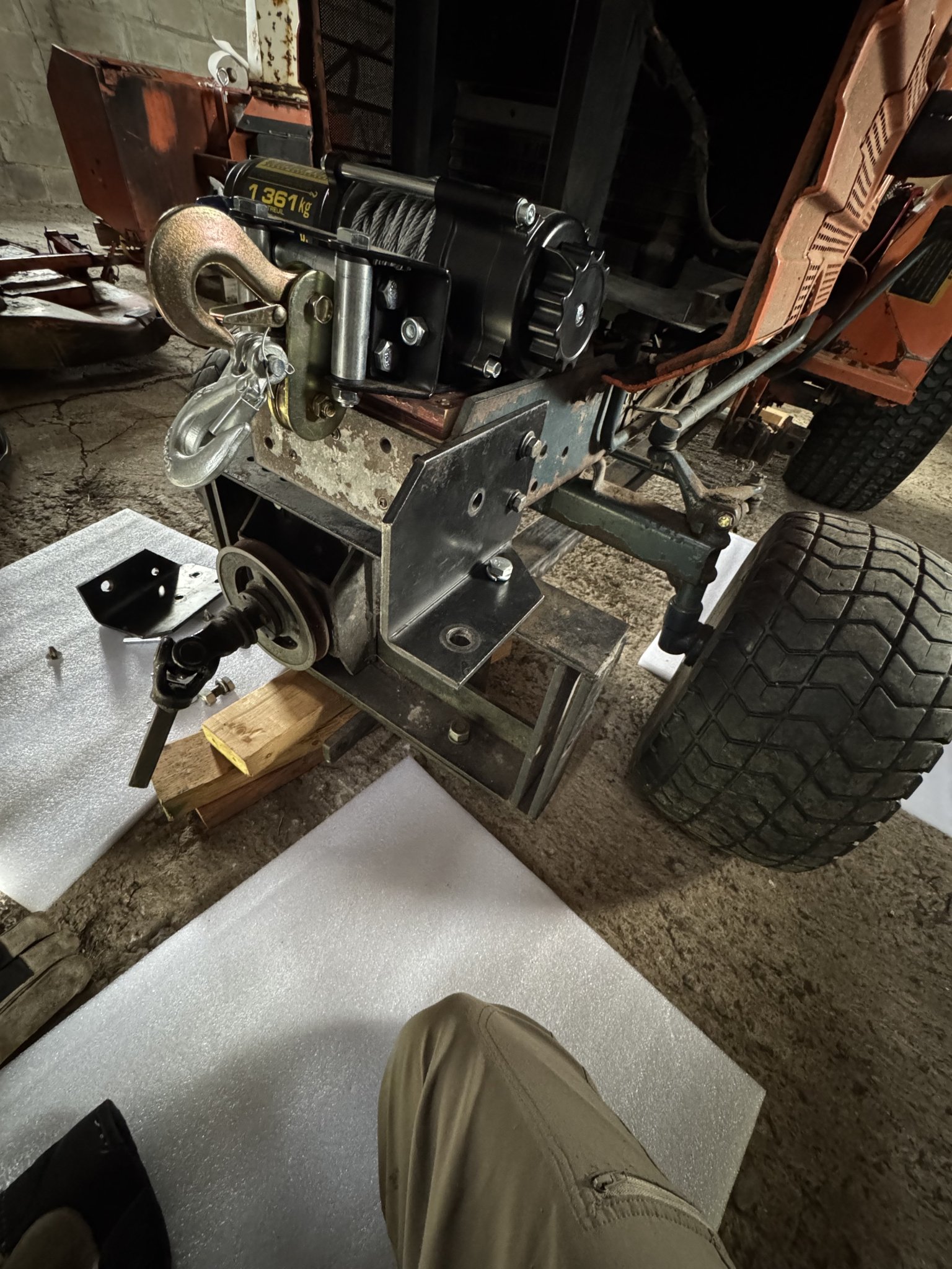

P.S. Don't judge the attachment of the subframe to the front of the tractor. I have to pick up the correct bolts yet, the pic is just a test fit after modification of the bracket.

Interestingly, you can see my brackets that hold the subframe to the tractor do not have the holes in them to attach the belt guard in the diagram. Makes me think this was never used in that configuration at all

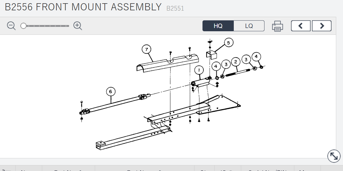

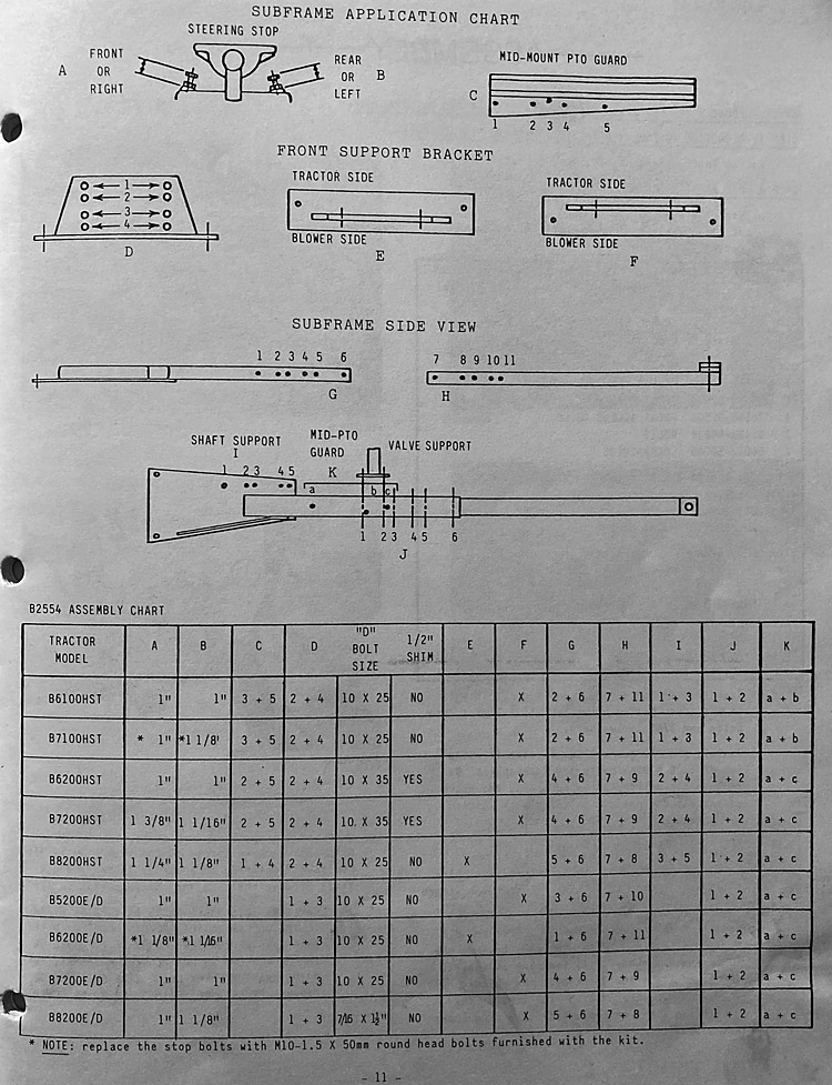

This is what you need:
The B6200 did not have a single shaft as it couldn't clear the axle and allow the blower to raise and lower without binding the drive shaft.
Also this blower was not meant to mount on a B6200E that's why your having issues with the mounts.

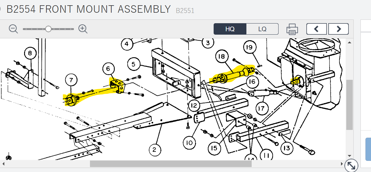

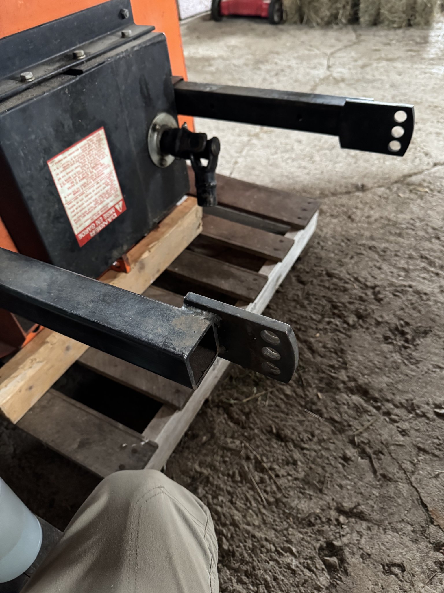

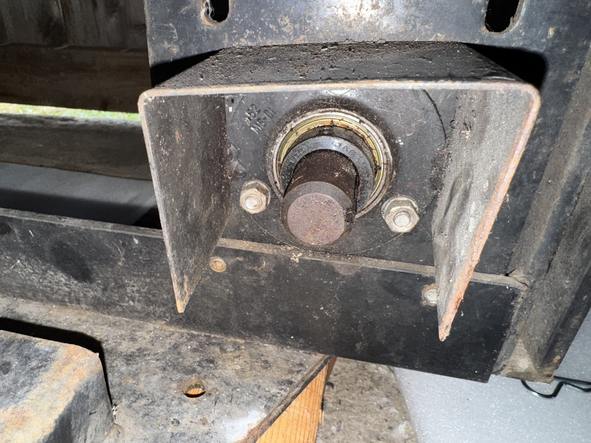

I was studying here diagrams today! I do have a shaft between the subframe and the blower as per the second diagram. You can see the front and back of the shaft in my pics 1&2 (and pic 5 for the yoke that’s on the blower)
The fixed shaft from the first diagram is all I need I think. Will have to piece it together but that should be be all it takes.
Do you think I could build a shaft myself with cheap parts? Obviously the mid-PTO side is the costly side, but could I then just use a 1” keyed shaft with basic 1” smooth bore 1/4 keyed yokes to attach the shaft to the subframe shaft?

Thank you! I’m guessing this from the B2551 manual? I have one on the way but we have a postal strike in Canada at the moment. Has made it tricky to get this going before the snow flies
