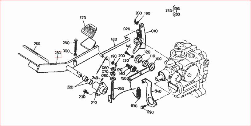

The controls are reversed probably because the linkage is out of place.
It's very unlikely that there is anything internally that's causing your issues.

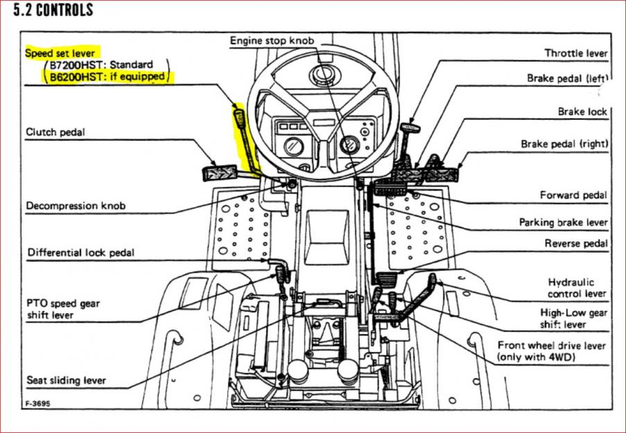

Here is what your looking at for part of the linkage, also make sure the set speed control lever is all the way disengaged in order for the pedals to work right.
You need to get a repair manual for this tractor, I think you can get one from Kubotabooks.com (you will have to wait till the first of the month as it runs out of band usage and get shut down). You can defiantly get the operators manual from there and that's worth a ton in information!
Speed set lever (if equipped)

Schematic of linkage setup
