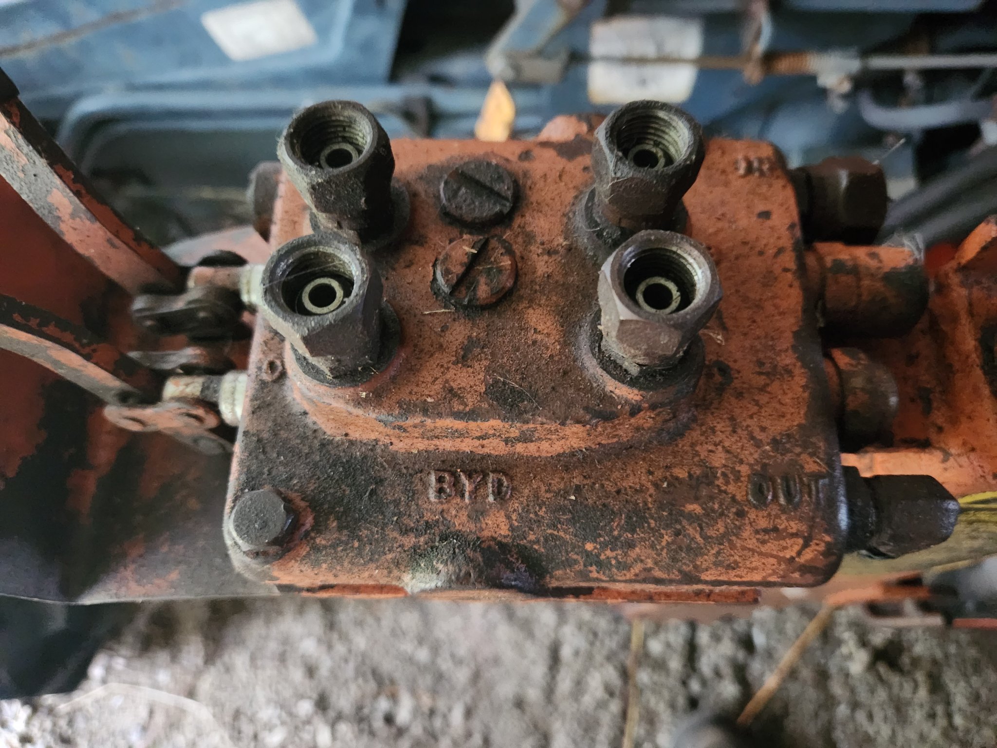

Ok as the title says, I'd like to run my B219 FEL from the pressure from the hydraulic block on the side of the tractor. I bought a B6000 tractor that was junk with a B219 FEL. What I didn't realize was the pump runs the opposite direction on the B6000. Until I get that sorted I've seen a few posts where people have ran them off the side block. Yes I know it will be slower. But a slow loader is better than No loader right? Anyways, my question is, I still have the original control valve for the B219. Part number: 70050-00072 hopefully shown below. Can I simply hook this valve to the block or do I need a new valve with a power beyond outlet? Side question, my valve has BYD stamped on it. But it seems to be above a port that's not tapped. Can I simply tap that port IF BYD is needed?

Do not alter the valve, it won't do you any good.
You can run the valve you have on the pump, but you risk blowing the seals out of the pump, as there is no pressure relief.
Either get the right pump for the front, or get a new valve with a power beyond adapter and you will have to add a line to the fill on the tractor for the return.

The casting on the valve was never drilled and machined for the PB option. Thats not uncommon. Converting it is a lot more than drill and tap.
Your valve has an inlet pressure relief so you wont blow anything up but I would replace the valve with one meant for PB operation. Use it as a chance/excuse to upgrade to joystick control.

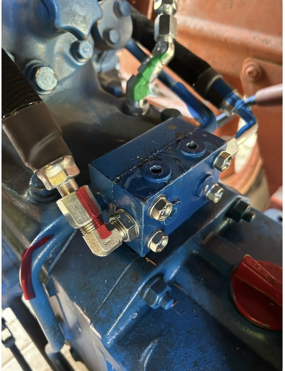

Look over your tractor and see if there are any ports that you might be able to use. See the green highlight in this picture. The plug that was there looked like a large bolt head but had a copper sealing washer under the head.
6,777
2,325
The picture I posted above also shows the oil filler port at the right edge of the picture (painted red). That is often used for the tank return port by putting a tee and adapters there. I recall @TheOldHokie showing a part from some other tractor that fit into that port instead of having to manufacture one or cobble together adapters and pipe tees. But I can’t locate the post.
I know what I show in green highlight was a BSPP 3/8 female port into the tractor. I have no idea what thread is on the filler port but @TheOldHokie may be saying that it is BSPP also?
