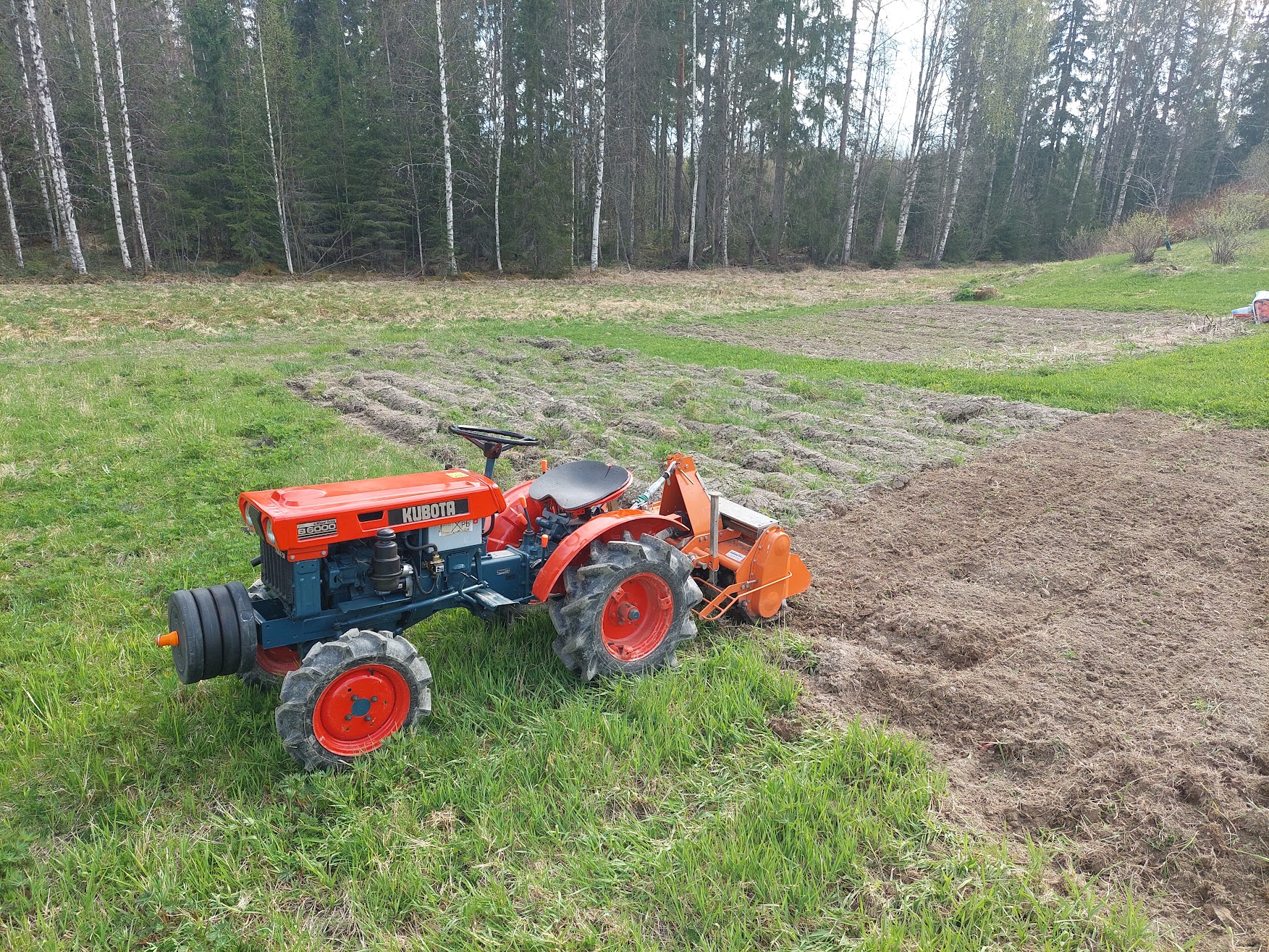

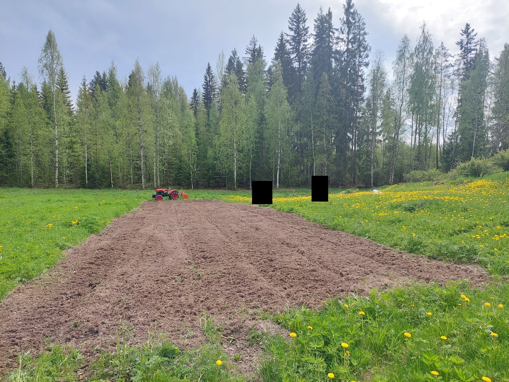

My b6000 handles 85cm wide tiller fine with Low 1 gear, it can turn grass areas (fields that haven't been planted for 40-50 years...) with two passes for plantable area but much better to plow first. On straight grass it jumps a bit. Already maintained garden area is no problem at all, it eats that easily.

Very nice looking equipment you have there. I have decided to restore my B6100D to much the same appearance and fitness. These little tractors are really stout and strong. Thank you for the information concerning performance. 👍
