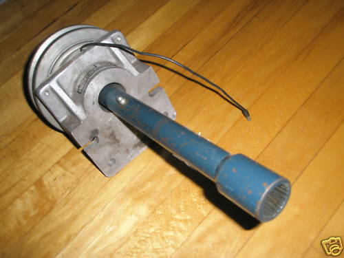

I have a B6100 I need to attach a hydraulic pump to the front PTO which is connected to the crankshaft via a shaft/crank pulley adapter.
Looking for correct part number shaft/crank pulley adapter/electric PTO. These parts ARE supposed to be available from Kubota as I am told but no one can answer the shaft size question so far.
I have this B9310 complete assembly
70090-00104; CLUTCH ASSY
66704-88530 1 FLANGE, PTO ( Front PTO)
66704-88540 1 SHAFT, PTO (Front PTO) Is where my problem is
Just bought and received a 9310 shaft assembly for my 6100 off ebay. It looks like the B9310 I purchased has a larger spline diameter than my crankshaft is. This unit I bought has the complete hub assembly bearing, the electric clutch and a 27 mm by 22 spline shaft sleeve. My 6100 needed a 18 mm instead of the 27 mm.
Wish I had the micrometer earlier. But maybe one of you has a need for 27mm x 22 spline when I find the right answer
Anybody know what the 27 mm fits? IS the 66704-88540 1 SHAFT, PTO (Front PTO) the smaller 18mm size? Help appreciated OTT
