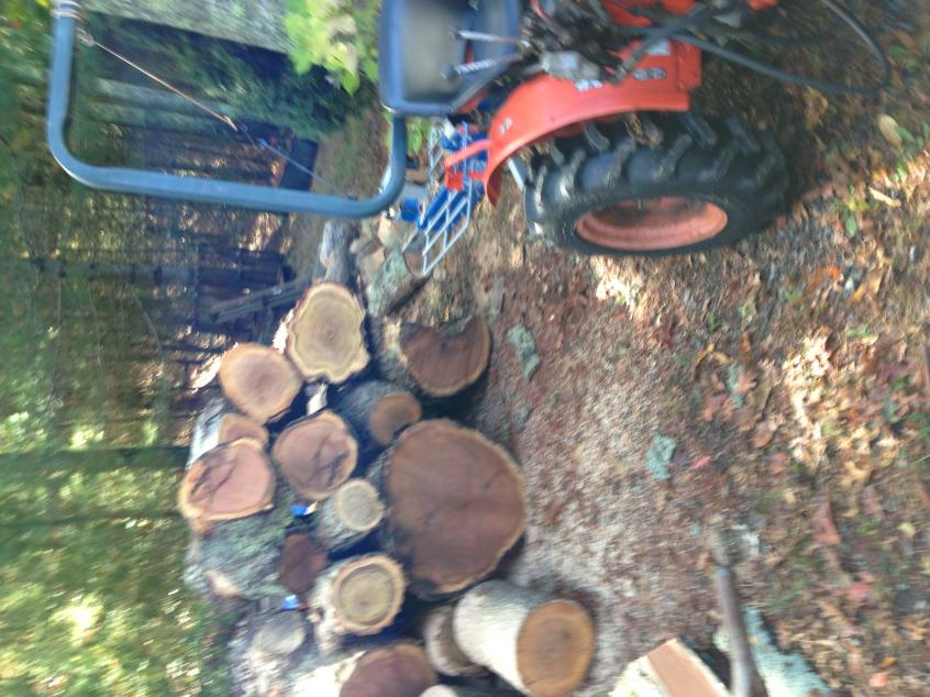

Hi all: My trusty B6000 and I were splitting wood for the last couple days.
I made sure to keep the tank filled, and checked the radiator and oil levels each day prior to use.
Yesterday I noticed the slightest engine rpm differing (up and down slightly). I assumed fuel filters clogging. So today I did a filter change. Heck, while I was at it I did an oil change, and changed the UDT fluid too.
Bled it and started it up. Ran about two minutes or so. So I thought I needed to re bleed it. Still only runs for about a minute or two. It WILL start right back up though after it dies.
Wondering if the original symptom (rpm fluctuation) was due to something else. Fuel pump dying? injection pump dying? One thing I did notice was bumping the switch to preheat made fuel shoot out of the secondary filter. But only on initial switch. It appears to me that the fuel pump has never worked, and that may be an issue too. But this ran fine until yesterday.
I can't figure out how to post a video on here, but I took one of the sound. This is before the wood pile arrived. And now I need the splitter very bad!
