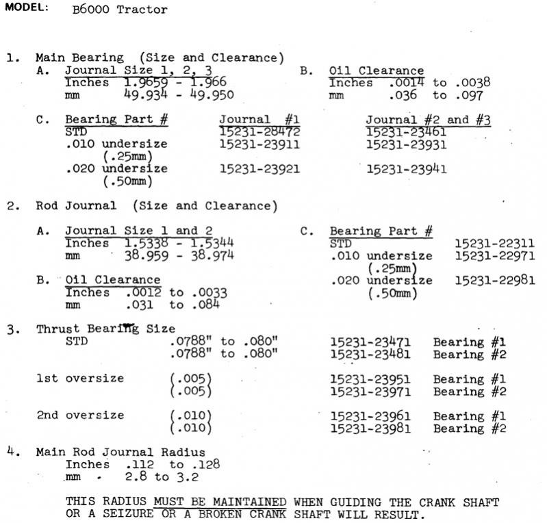

Pressure gauge is good. I'm now searching for an engine manual for the ZL600 engine but not having any luck.
I do see that Stavros in Cyprus does list aftermarket bottom end and rod bearings in .25 and .50mm undersizes.
Cmon,, pull an engine manual out of your pocket! Of course I'll need the dimensions and clearances for the shop to grind the crank to. I'm assuming the crank is worn as the metal on the magnet is a very fine particle size.
According to a spec sheet I found somewhere on the web the mains measure 1.9659" or 49.93mm. Assuming the bearing insets have a 50mm bore diameter that will present a clearance of .07mm or .1778" which sounds about right.

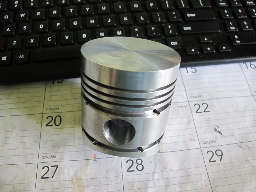

I have a question on the pistons. There are no markings on them whatsoever other than internally with the manufacturers name IZUMI on one skirt boss and likely the die number 6 on the other. Can I assume they can be put in either way? Do they have offset pins which must be oriented correctly?
