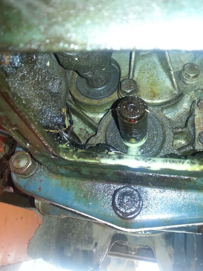

My B6000 is leaking transmission fluid from the little opening or access hole underneath just in front of the transmission. The strange thing is, it doesn't leak all the time. In fact, I hadn't seen it leak it quite a while but then I ran the tractor today for a few minutes just to let it run. I didn't drive it around or even take it out of neutral. But when I came out later this evening there was a big puddle of fluid.
Any ideas what might be leaking and why it is so unpredictable?

It is leaking from the PTO shaft that comes out the front of the transmission. Do I have to split the tractor to replace this seal? Doesn't really seem like there is another way. It also just started to leak a little from both the rear axle case covers.
See pic.

You need a workshop manual. Servicemanualvault.com has one that you can download. There are other sites that have it as well. Servicemanualvault charges $10.00 for the download. Others here know of site that don't charge. The oil looks like it has water in it. It could be that the seal comes out externally and could be an easy fix. You Kubota dealer might be able to look at their drawings and tell you what would be involved. One of my main concerns would be the water possibility.

Either way, rentthis gives good advice. You need to start with a WSM, and the color of your oil says water in it to me, too!

When draining a tractor, there are often pockets of oil that require removing other plugs etc. could it be that you didn't drain all those areas? Your WSM should tell you if you left a puddle of water somewhere. It was either left in or somehow introduced . Your WSM should show how the seal is repaired. Very often, it takes some looking to understand what it's showing you. When you find it, just grab it and growl.

I have just taken a look at this shaft and seal on my B6000.
I think the seal could be removed as follows:
1. Drain transmission oil
2. Drill two small holes (perhaps 3mm) in the centre of the seal 180 degrees apart. The seal is quite wide which helps.
3. Thread two small self tapping screws into the holes you have drilled.
4. Attempt to pull out the seal using pliers.
Assuming you are doing the drilling through the small aperture under the tractor the drill will be going into the seal at an angle. The drill will need to be reasonably slim such as a hand drill.
If this method fails you are back to square one but I don't think you can make matters worse by trying. If you drill a bit deep I think it unlikely you will cause problems. Behind the seal are a circlip and ball race bearing and you would feel it if you hit them.
I have used this method on other similar jobs with success.

If you drain the transmission only by removing the transmission filter you will be leaving at least a couple of litres in the trans.
If you look immediately below the left and right axles you will see two drain plugs on the side of the transmission. These are at the lowest point on the trans and they are clearly intended as drain plugs as each one has a bonded seal fitted.
