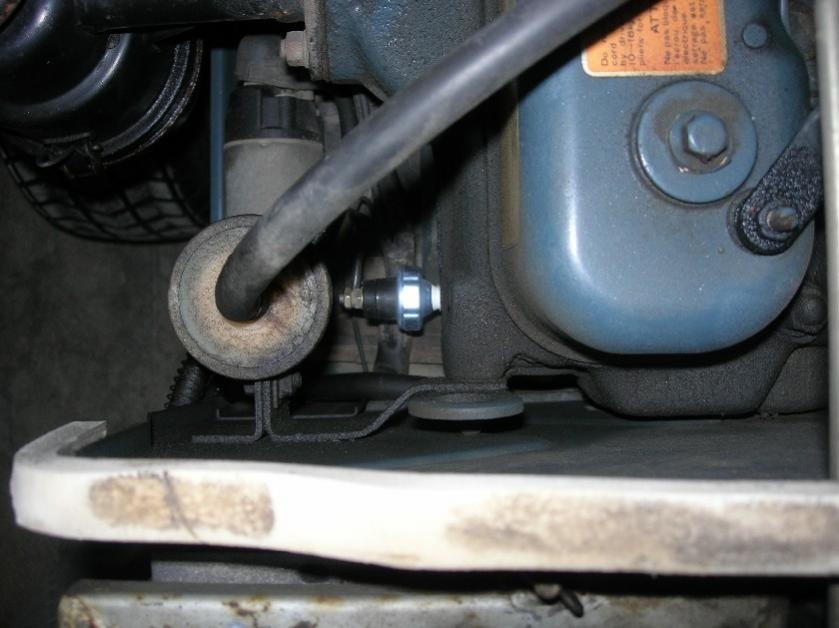

Well, you answered my next question I think. The decompression handle... While I don't have the lever behind the steering wheel, the 2 fittings and the connection shaft is on the top of the valve cover. I was gonna ask what that was for next. The rear mount (I'm callin it a mount as I'm not sure the exact term for it but am talking about the 2 things mounted on top of the valve cover that I suspect is the "decompression valves")was extremely loose when I got it. I tightened it and now it leaks oil a little. I'll try using this the next time I try to crank it. Do I open this while cranking and let go once it cranks? I don't have a glow plug indicator as it is missing. The stainless bezel is still there on the dash but no bulb. There is a really bad oil leak on the bottom (haven't tracked it down yet to know where it is exacly) so my oil level may be low. I'll leave the key on from now on though.where is the oil pressure switch located? Also, where is the oil filter? Thanks!

I believe the oil pressure sending unit is mounted in behind the fuel pump. If your looking at the left (air cleaner side) of the engine, its on right end of the block. At least this is were I remember it to be on my B6000E.
